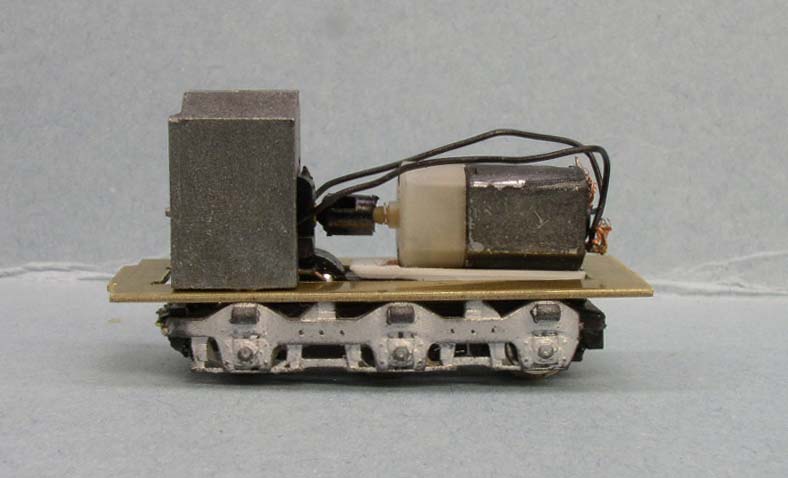

« Reply #88 on: June 22, 2017, 09:55:34 PM »
OK, here's my progress:
.040 brass frame cut and fit - mostly for weight.
Sideframes sanded and attached - David Cuttings Shapeways (again, outstanding).   I managed to sand the original sideframes too thin and snapped it placing it back on the gearbox.  Hour of cursing and pinning and ACC'ing and got it back together.   Got a little too aggressive on the sanding at the corners.
I found an old Con-Cor SW1500 cab weight in the junk drawer, and that will do just fine for initial testing.   I have noticed that if I put the cab weight where I think it should be... it rocks it back on the rear axle.  So weight on the front hood and nose (yet undetermined) will be critical here.  And I'm trying to determine if I laminate up the frame out of styrene or go the 'hard way' and do it in more brass for weight.
I've got end sills/steps cut off the Atlas GP35 but not attached to the frame yet.  Should work OK.
Run tests are encouraging, but oh my, does it take a lot of tweaking and bending on those pickup wipers to get the wheels 'just right' and equalized so it will creep through turnouts.  Got it, but I won't say it was easy.   I still have a little too much pressure on the nose and its riding 'nose high' not sure if getting more weight will cure that or if I have to redo the wiper tension.....again.....
Looks like I'm going to take this one to the bitter end but I don't think my approach is particularly repeatable.   It's going to run well but the degree of difficulty for parts and assembly is getting up there pretty good.    The trick here is finding another three-axle truck, readily available, that has an offset gear tower sufficient to allow mounting the gearhead in the nose and leaving enough space left over.   The Roco apparently will do it, but I just got lucky even finding one of those.  I'm not sure about the body yet.   Pretty easy to scratchbuild but I don't see a whole lot of purpose in making it into any kind of kit master, particularly when I think I'm going to use that thick sill assembly in brass for weight.
« Last Edit: June 23, 2017, 09:47:52 AM by randgust »

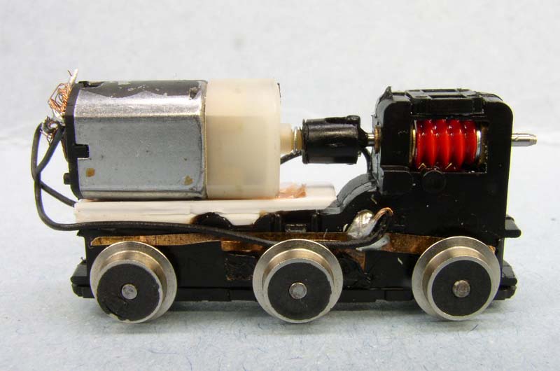

« Reply #89 on: June 24, 2017, 07:48:12 PM »
Package arrived from Japan today.
Jumped to work.
Kato SD40-2 Mid truck.  Pull the u-joint out.
Kato 11-105 chassis.  New version with 12 v motor.
With the cover off.  Motor easily lifts out.
We just need the motor and the drive shaft.
Drive shaft must be shortened.  So I trimmed it and cut a small piece of small dia K&S brass tubing.
Superglue together.
Styrene support for the motor.
Assembled.  Motor glued down.  Jumper wires soldered.
Ran well.  But after a while (15 min?) of running under DC with my old Tech II Railpower 1400 throttle, motor was hot.
Not good.   :scared:
Tiny motor did not like the pulses of that throttle.
So I installed a Digitrax DZ126 decoder.
Purrs like a kitten.
Running at 85 smph for 20 minutes, motor  barely even warm.
Will creep without stalling at 9 smph.
