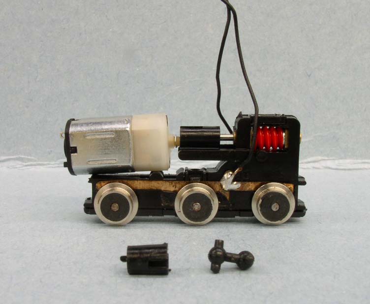

Well, the arrival of the vintage Roco E7 truck confirmed my suspicions.  It may be vintage, but parking that worm over top of the rear axle produces enough room to jam a universal in there and it looks like everything will fit.  Those old Roco universals are a POS, but they can be trimmed and polished to work.  I've put just the horn on one end of the shaft and the cup on the other.  Given the torque of the gearhead, wheel wipers don't bother me a bit.
Interestingly enough, there's a slight downward force on the wheels due to the wipers, it actually equalizes.
I'm going to design this with the worm under the cab and the motor in the nose, and pack all the lead in the cab end.
The wheelbase is right on and different sideframes will be easy.   If the deep flanges bug you the wheels could be turned, I'm using Peco C55 so not an issue.

« Reply #53 on: June 11, 2017, 01:44:17 PM »
That worm over the end looks ideal.
