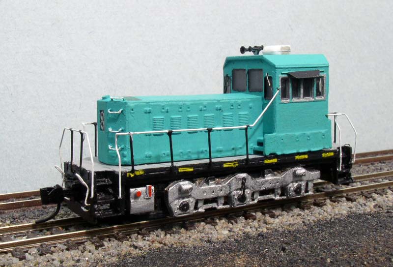

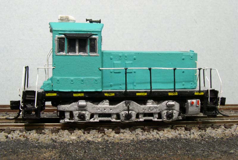

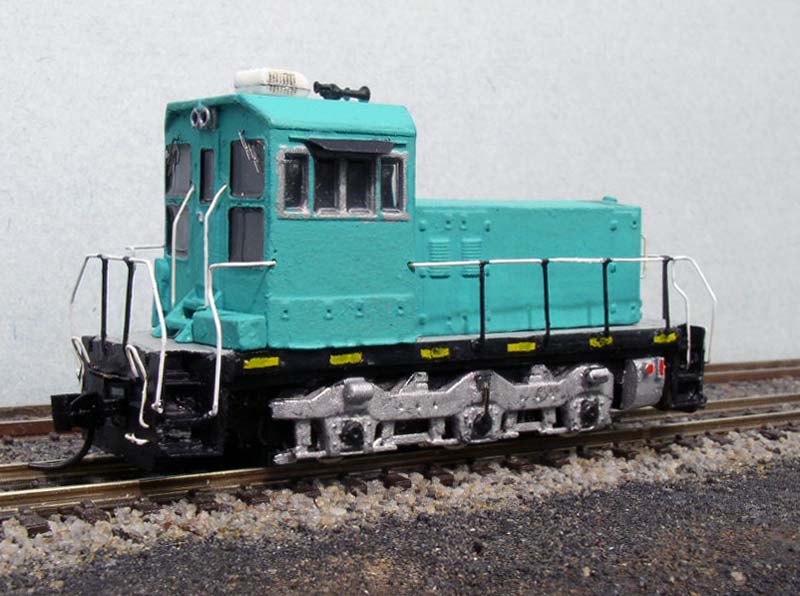

OK, first set of stats:
Total weight 54.8 grams.
Tractive effort on dynamometer car - 8 grams (14.6% adhesion)  (remember 1 dummy axle.)
Verified car pull on layout:  13 50-ft cars.
That's about equivalent to a Kato NW2 for performance.  It outpulls a current-production Atlas GP7 or GP38 and way outpulls an Atlas MP15.
So from an operational standpoint, that meets or exceeds any of my expectations.
On the low end, my little 25-tonner weighs 20 grams and has 1.5 grams on the drawbar.
On the top end, my rebuilt FP45 on a Kato SD40-2 chassis with more weight added racks in a 130 grams and 28 grams on the drawbar

Doesn't appear to be an issue at all.
The cab weight is almost centered above the rear axle; there's a chunk of it that goes into the hood.   And the frame plate is solid brass, too.
But what really made the difference is that I didn't use the RP-printed acetal fuel tank, I just put a big slug of lead more or less the size of it right front of the front axle and will put detail on the ends.  I had to have that to hold the nose down against the 'spring' in the Roco truck, and that made it so the pickup and equalization was actually pretty good.  Until I put that lead fuel tank in the nose it was not balanced particularly well.
I put up a video of where I'm at now, partially painted, wire handrails, running well:

That's really running well.  I think the 54+ grams of weight is crucial to this.   Getting reliable pickup from only 6 wheels is tough.
A lot of two-truck diesels (8 wheels) have suffered by having traction tires on only 2 of those wheels (like the old RS-11 or
the recent Arnold SW-1).   So getting this out of 6 wheels on a single rigid truck is awesome.
Looks good, too!

Thanks, but with Ron in the room I had to do micro-LED headlights, and still have to put on the right air conditioner, horn and put the HT strut back on the center axle, and with you in the room I have to put on etched windshield wipers and a fuel gauge on my scratchbuilt tank end!
When mine started about a year ago I didn't think Ron could jam a usable motor on that center-feed truck, so I went Roco-loco instead.  I could have probably built six of Ron's in the time I've spent trying to get this approach working right.   Most of my problems came from that lead idler axle issue - which was a design change in the Roco truck I wasn't aware of.
On my video I wanted to make sure that David Cutting got credit for the Shapeways shell.  None of us would be tinkering this this if David Cutting hadn't drawn up an RP-printable shell here.  After really studying it against the photos, he did a great job.
EDIT:  OK, finished it up last night.   I'm not going to do the decals, actually, I like it this generic.
Runs well, I'm satisfied.....we're done here!
