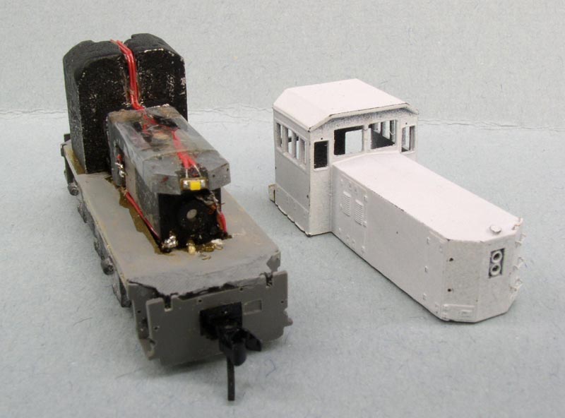

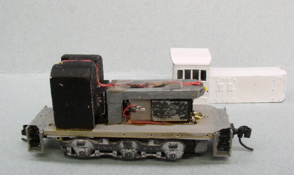

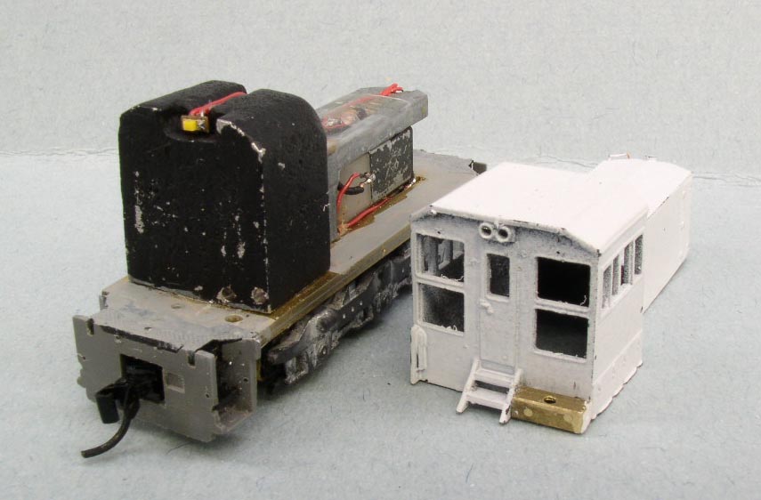

This worked its way back to the front of the workbench.  Darn you Ron, I was doing great until I saw those headlights of yours.   Then I just had to have them.   That's made a difficult model much more difficult, but I finally got them in and working and can still get it apart.
So this shows the big honking metal casting I made for the cab, with adaptation for the LED lights, and the modified nose weight that now has a chunk milled out for the dropping resistor.   It all still fits, runs rather well.  I didn't want to finish it until I was satisfied it actually ran right.
I'm doing the jade green one, so the body is primed white.    Painted white you can see just how good that acetal Shapeways surface is.   Head and shoulders beyond FUD.
This is more than a little beat up from the hours and hours that I've spent fiddling with the mechanism.    One of the good breaks though was getting the handrail holes successfully drilled in the brass frame, I anticipated that would be at the cost of several .015 bits and it went rather easily.
Finding a way to secure the body onto the brass frame was another matter.  The piece of square brass on the cab back is drilled and tapped to take a 00-90 screw from under the frame, and the nose has a piece of brass in it that's also drilled and tapped from underneath.
This project has pretty much made the 'never again' threshold, but it's at least worth finishing from the way it runs.    One of the ongoing problems was the gearhead noise, I finally decided there was only so much I could do about that, and that if it ran really smoothly to just live with it.
The other 'heck with it' was trying to build in enough slack to get the weights and headlights off the drive, it turned out to be easier to put two solder joints safely beside the plastic gearhead body and make them 'quick release' with no wire twists so that I could just touch an iron to it and have it off in seconds.  Not exactly recommended, but it works well here.
While I've got the gearhead and universal concept working just fine, the overriding 'glitch' in this approach is the marginal quality of the Roco truck.  Had to take up all the lateral slack on the powered axles (center and cab rear one) so that it didn't 'crab' sideways.  Then hours of tinkering with the lead unpowered wheel to get the pickups and equalization 'just right' so that it rolled, centered, and sprung right, because when it doesn't it stalls rather quickly on an insulated frog switch.   Bottom line is that this would work a heck of a lot better either with the original Roco truck that I can't find (all three axles powered and picking up) or anybody elses truck frame with an offset gear tower to the end and all powered axles.   Doing it with this truck is kinda nuts, but I've made it work.
