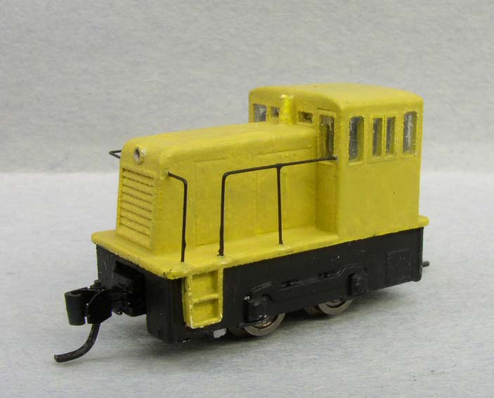

If anybody is hung up on handrails, I'll be making mine out of soldered brass and can do others.   While you could do these as etched, the artwork and first setup runs on etchings are darn expensive.   I don't know if that Acetal Plastic has got to the point where you could do handrails or not with a .010-.015 cross section, but it's pretty easy to do with wire and they are very, very durable.    I should be able to do all the soldered handrails and grabs for around $30 a kit, and remember I put them on AFTER assembly and painting of anything that is under or behind them.
Here's the Shapeways 25-tonner I did:  http://www.randgust.com/25tonTU715.jpg
« Last Edit: July 31, 2017, 09:22:58 AM by randgust »
Thanks for the tip Randy.
I've updated the model files, increasing wall thicknesses on the roof and all of the steps. It should print now unless Shapeways finds another thin spot. I'll keep my fingers crossed. The links are still the same; I just updated the associated model file.

I was planning on using Gold Medal stanchions and guitar strings.

Cool.   I just don't want anybody to get stuck trying this due to handrails, and the RP ones I've seen so far have been either too thick or too fragile.
It really looks like they imitated EMD styles all the way around, you might be able to cobble in some Atlas parts with some planning at least for the side rails.   This thing has more of an EMD flavor to it than just the truck.
