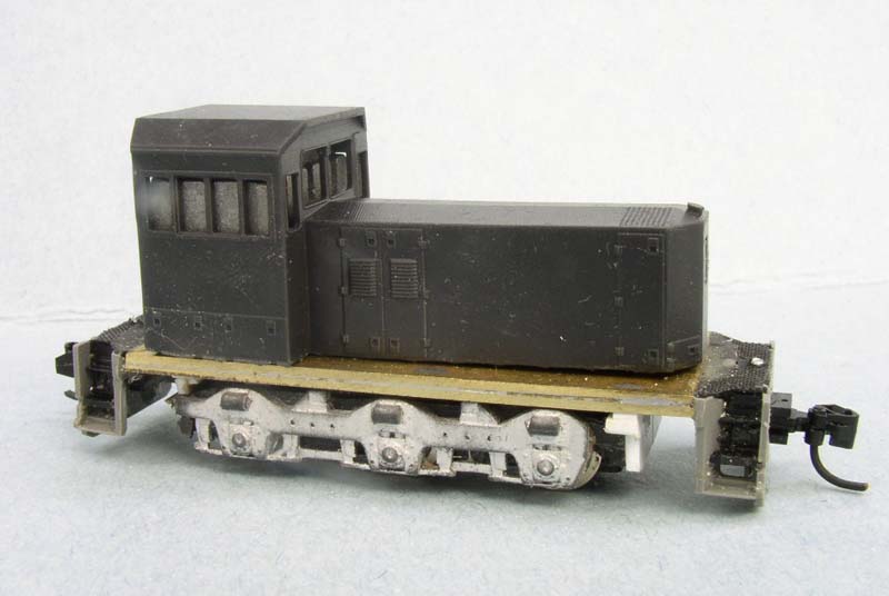

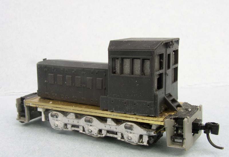

« Reply #254 on: August 08, 2017, 05:48:06 PM »
Got the shell in from Shapeways.   Ran downstairs,  held my breath...and slid it on the mechanism......
PERFECT FIT.  All I did was trim off the lug clips as I'm using my brass frame.  Even the cast weight I had leftover from the CC SW1500 slid into the cab.
David, wonderful job.   It looks good, the resolution is smooth enough to be painted without additional sanding or filling.  This is seriously good.   The Kato motor mounted on edge on my mechanism fit right in, there's even some room left on the top for more weight.
Now, what's your experience with cleaning/priming this acetal plastic?   I didn't mind if the truck got beat up a little, but if I'm putting on a coat of Badger I don't want it to wear back off, and I'm going to 'have' to put either white or gray primer under there to get the color right.  I'm thinking a light coat of conventional autobody primer, but I'm not rushing into this.  There's no noticeable grain, or wax, or anything on this stuff.   The only 'weird thing' is a series of indentation/dimples on the INSIDE of the shell where maybe those printing supports were?
This is cool.    It won't be finished, but I'll bring this along with me to Altoona.
You can see why I'm so high on this stuff - there are no visible ridges, striations....nothing like FUD.
