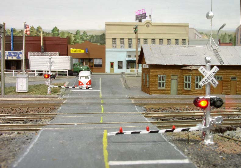

For roads with imbedded tracks or for around grade crossings, I also use Woodland Scenics "Smooth-It" as my experience with joint compound is that it tends to shrink and/or crack (I have experienced none of this whatsoever with Smooth-It). I line the road to be paved with styrene that is around the same height as the railhead, pour-in the Smooth It and then screed with a spackle knife that is big enough to span between the nearest railhead and strip of styrene. I used to try to mix-in some WS pigments prior to spreading but found that the color tended to dry too light, so now I add pigments after the Smooth-It is dry (sometimes via a wash and sometimes straight from the bottle, depending on how new I want the pavement to look). Also, before the Smooth-It dries, I clear-out flangeways with an old set of trucks first, then clean-up with running a small screwdriver along the flangeway as needed. There's a point somewhere between not too wet and not too dry where this process seems to go the best, but it takes some trial and error to find it.
The patchy-looking, "City Edge" layout-inspired street below was way harder to achieve than it needed to be, as I actually finished the concrete-colored areas first, then carved-out chunks that were then replaced with more Smooth-It pre-colored with an asphalt color. I would've probably achieved close to the same results if I simply painted these areas with the asphalt color without removing anything (I had to darken most of it afterwards anyway). Still, the end results were pretty good...
http://
Another finished road area using the same method but with striping and other markings added...
I also have a highway that, except for the areas right around the tracks, was simply cut from I think 1/4" plywood and was painted with some of my wife's craft paints (I may have applied a thin layer of Smooth-It or something else over the plywood...it's been a while). I wanted a light color here as I think there's a tendency to color model roadways too dark, so I went with a pretty light gray....
