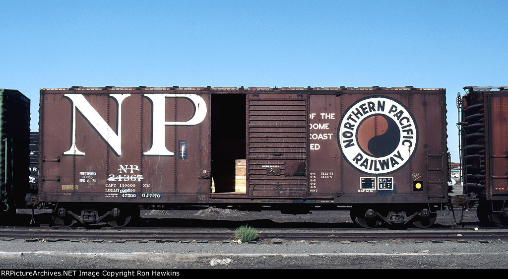

... I can always get dimensions to the roofwalk, but not always to the eves.
I missed this before.  Why can't you measure to the eaves if you can measure to the top of the roofwalk?  On a boxcar, the eaves is basically the top outer edge of the roof over the sides.  If the model's body dimensions are accurate, it's the most accurate starting point.
  • Posts: 8956
  • Respect: +1392
Re: Lowering Intermountain 10'-6' IH box cars (e.g. 1944 AAR)
« Reply #19 on: September 22, 2016, 01:20:19 PM »
Trying to use the eave height data from the ORER or the data on the car can by tricky as you have to know where they are measuring from.  In the ORER the column isn't just listed as eaves, but "Eaves or Top of Sides or Platform".  Next you have to know where the 'eaves' is.  It's not the top of the sides (and I've amended my post in the PS-1 thread to reflect this).
Using the the diagram provided in the first post, you can see it gives a measurement to the top of the side as 13' 11 1/2".  But if you look at the ORER or the actual car, you'll see that the measurement given to the 'eaves' is 12' 11".
From what I can tell in this case, the 'eaves' dimension is the top of the side sheet where it meets the angle bar (the top of the 'N' and 'P' in the photo above).
« Last Edit: September 22, 2016, 01:24:23 PM by wcfn100 »
  • Posts: 9396
  • Respect: +6198
« Reply #20 on: September 22, 2016, 02:24:54 PM »
In this case yes, as there is no gap between the top of the sides and the roof and the roof blends seamlessly into the sides.  My understanding is, is there is a gap, that it would be the top edge of the roof as opposed to the top edge of the sides.
The category has the "top of sides or platform" to accommodate equipment that don't have roofs.  But the eaves definitely pertains to equipment with roofs.
