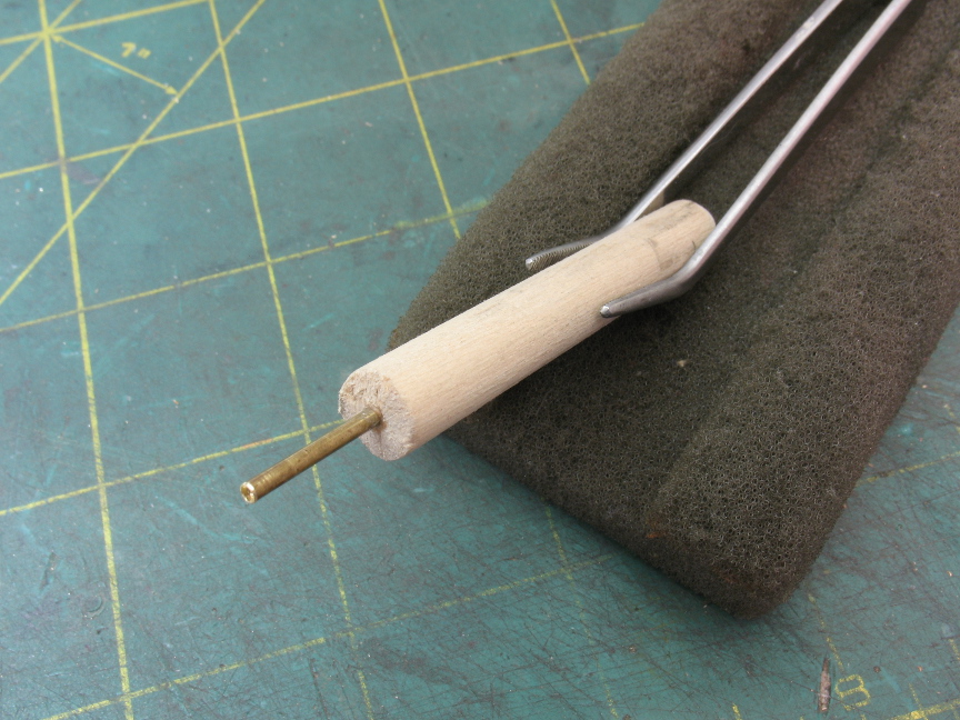

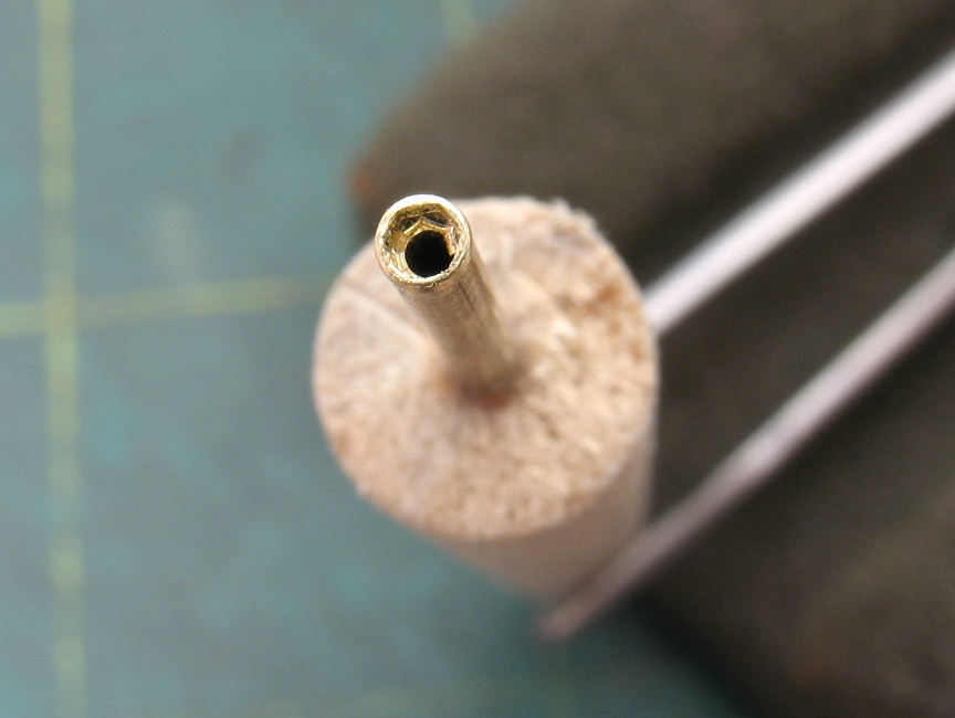

Well, first time's a charm I guess.
I tried a "what the heck" easy approach, akin to the various suggestions on here from narrowminded
and LemoSteam, although much more simplistic than their instructions.
Took a piece of brass tube with an ID somewhat less than the head of my bolt.  Drilled it out with a pin vise
to .046" (just about 1.1mm).  Then I clamped one of the bolts under the mill head, put my brass tube in the chuck and just pressed it down like a ram, forcing the open end of the tube over the head of the bolt.
Voila!
Wow... after all this hard thinking.. it was much easier to do than I thought it would be.
Fits the bolts *perfectly* and works like a charm.  I don't know how much torque it could really take before the brass stripped out.  But think it is adequate.

  • Posts: 19645

narrowminded
  • Posts: 2305
  • Respect: +743
Re: Q: How to make a micro sized nut driver?
« Reply #69 on: May 05, 2016, 02:22:48 AM »
That's what I'm talking about!!!! 8) :D
That bolt head is a machined head, not cold headed like most fasteners we see in larger sizes, isn't it?  It gave you a decent edge and honest dimension.  Flowed that metal right up into the hole just like a.... socket. :D

For long term use....
In order to reduce the chance the thinner brass will flare, I wonder if you could flare the tip of next size tube and slide it over your new nut driver.  This would give you a thicker wall.
  • Posts: 6499
« Reply #72 on: May 05, 2016, 11:11:42 AM »
I did think about this (reenforcing my nut driver with another layer of tube around the outside wall).
I wonder.... is that how it will really give, or will the straight faces on the inside just kind of round off over time?

« Reply #73 on: May 05, 2016, 11:23:23 AM »
Heat the thing up and quench it in oil.  I think sometimes we overplay wear on these tiny devices that do not see grease monkey torques or real life loads.  It sounded like it was so easy to make you could make a lifetime's supply anyhow.
I do think however, had you heated the brass in advance, it would not have shaved material into the tube as the picture shows.
