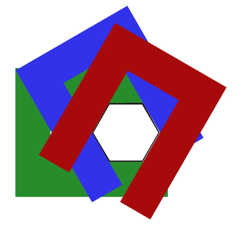

  • Posts: 6499
Re: Q: How to make a micro sized nut driver?
« Reply #58 on: May 04, 2016, 04:54:25 PM »
Keep 'em coming boys....
Yes, I considered filling a tube with JB weld and putting the head into it to make the impression.
I don't think I'd get a very crisp-edged socket that way, though.
I have that same concern about Peteski's solder idea (which he already considered when he posted it...)
It would be soft, and the corners and sides would probably be roundy.
I did have a new idea... The open end wrench thing got me thinking.
Take a brass strip.  carefully cut a 1.1mm slot in it.  (I have some .009" dremel disks and I could use those, or a
wider one, and just gently work it.  But let's assume I can make an accurate slot).
Now... do that three times.   Make three strips.
Now, place the bolt into a block, head sticking up.
Lay the three slotted ends over each other on the bolt, each one aligned over a different opposing pair of faces.
(like 3 open-end wrenches staggered around the bolt head).
There will indeed be a hex-shaped hole through the 3 strips if you were to look down through them from the top.
Tape em down so they don't wiggle around, and solder them together.
Now cut off the little soldered-together part, and solder it to the end of a brass tube or stem as the tool handle.
Yes, the 6 faces of my socket head are staggered vertically, but I don't think that will hurt.
The brass strips need to be thin, probably .010", so that they all stack up without going over the head of the bolt.
The thing I like about this one especially is that it HAS to fit.. because... well... because... it just HAS to.
the three piece will be locked around an actual bolt head while I solder them.  The only gotcha is to make the slots
neat, but that isn't hard.
Picture:
