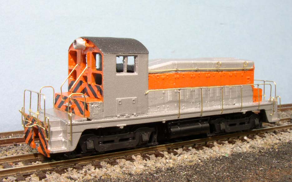

Here's a good shot - on one of my custom (pre-Hornby!) SW1's.   Buyer did painting, I just did the railings.

Nice thin handrails Randy. But shouldn't the stanchions be attached to the top surface of the walkway (not on the side)?  At least that is how all the B&M SW units are built.
Only if I wanted to do it wrong.  http://www.rrpicturearchives.net/showPicture.aspx?id=3325412
History indicates these were retro added by SN as standard practice on all their switcher units, heck, I'm not even sure they are EMD handrails.  I am pretty sure they were not original equipment.  There's also a bunch of detail differences between as-delivered, pick-a-year, and current condition of the unit out at Sacramento.   Unit didn't have step grabs for a long time.   That's why I prefer people pick a unit and a year!
« Last Edit: December 16, 2015, 07:09:06 AM by randgust »
