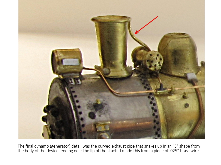

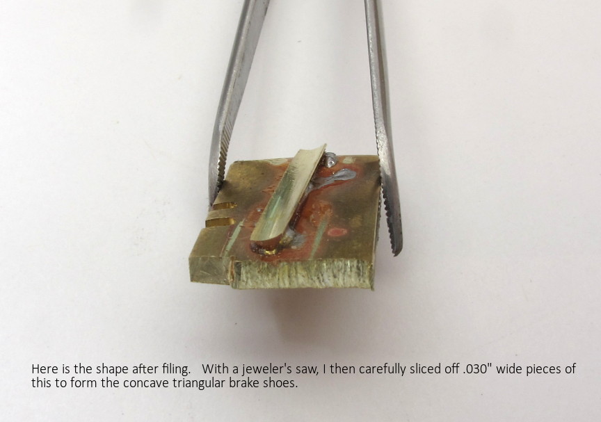

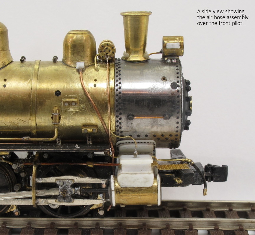

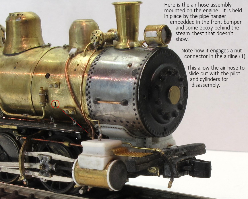

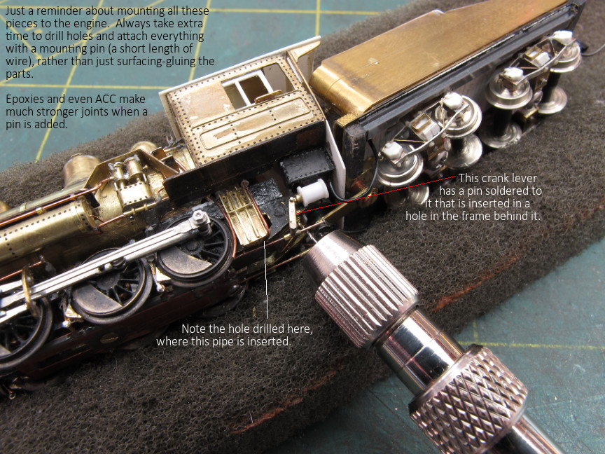

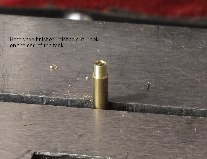

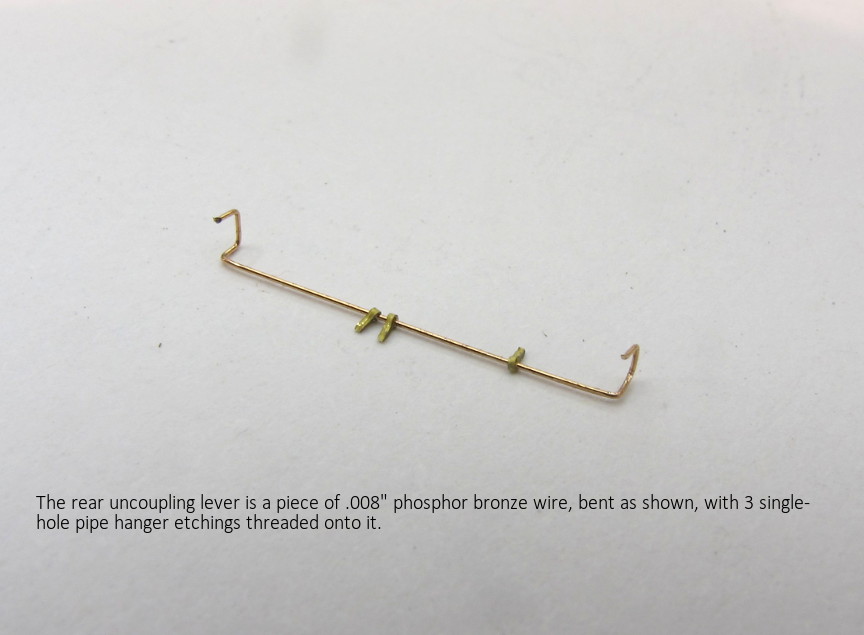

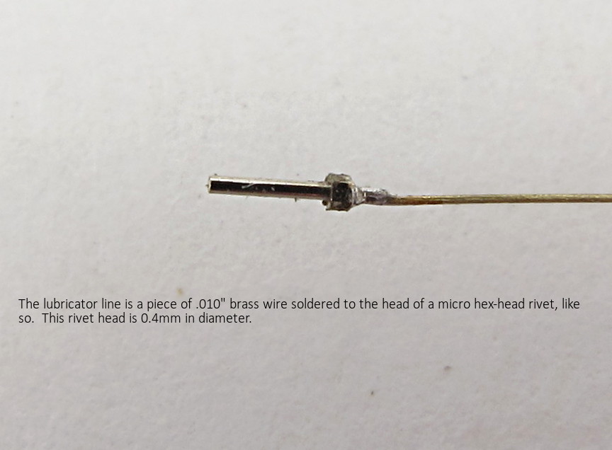

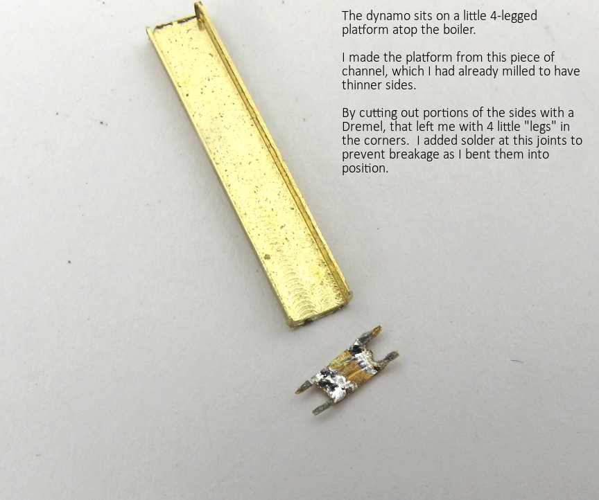

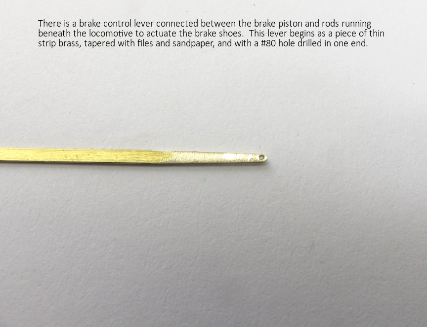

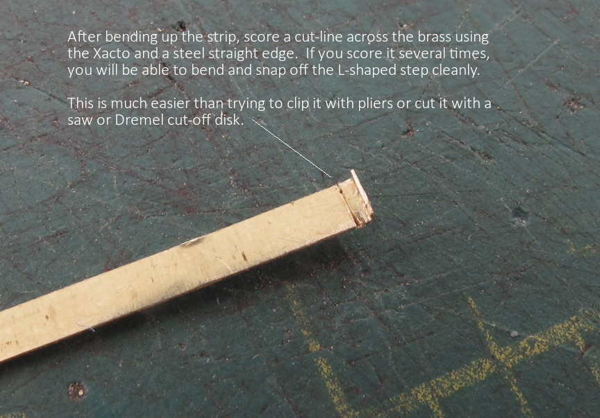

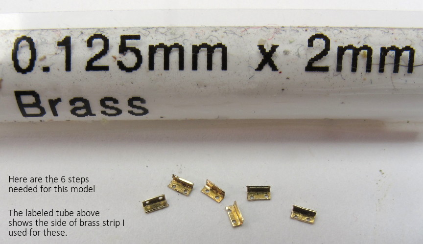

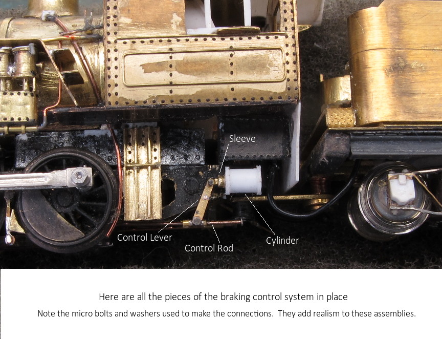

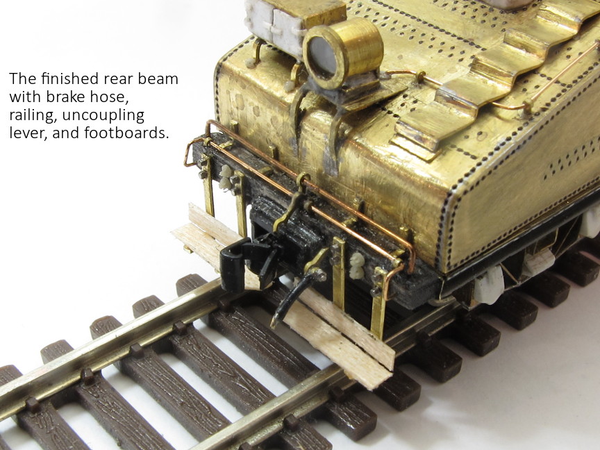

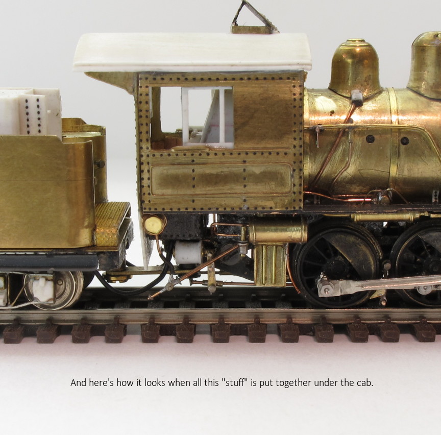

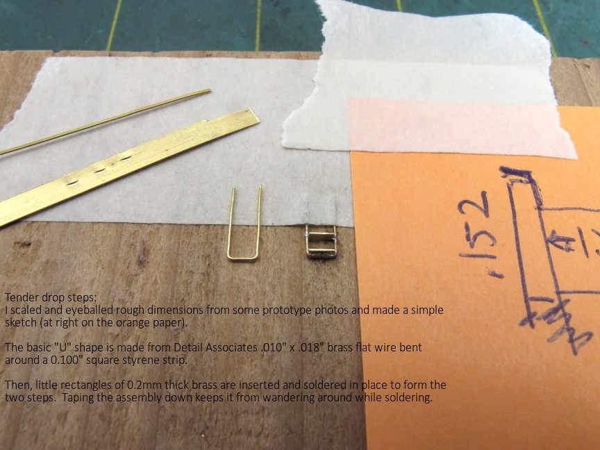

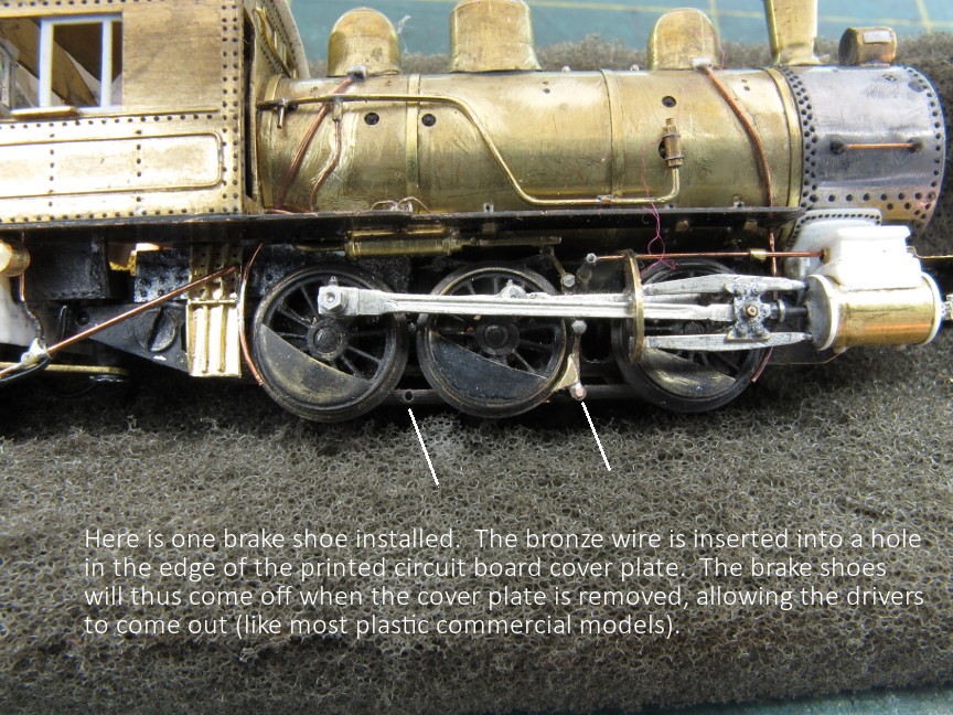

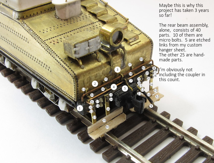

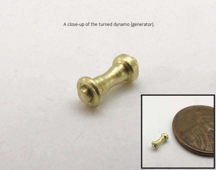

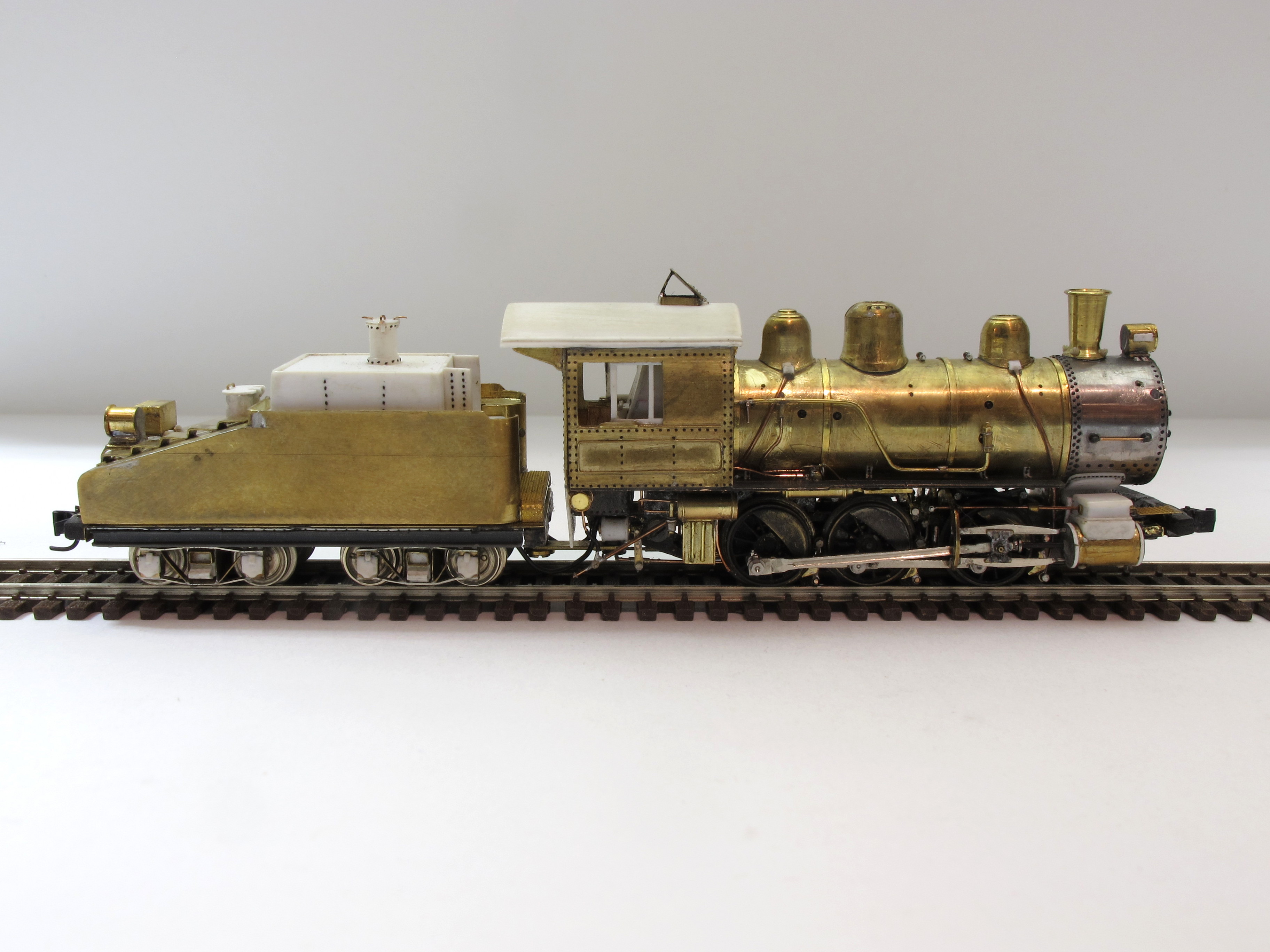

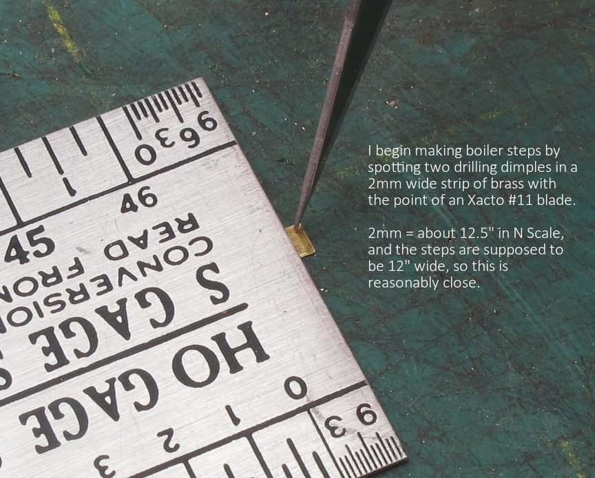

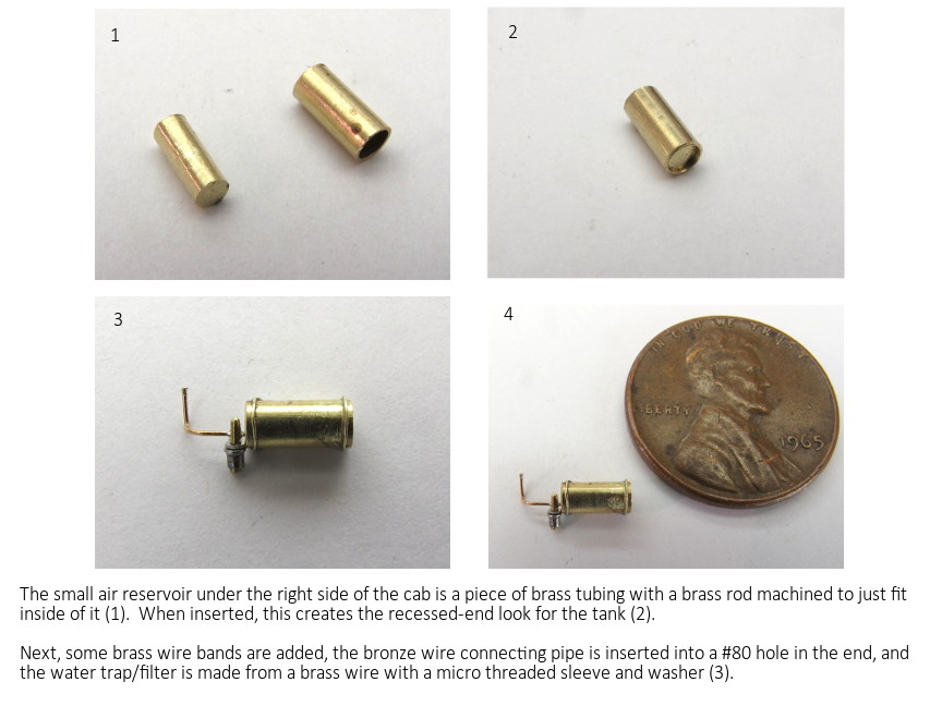

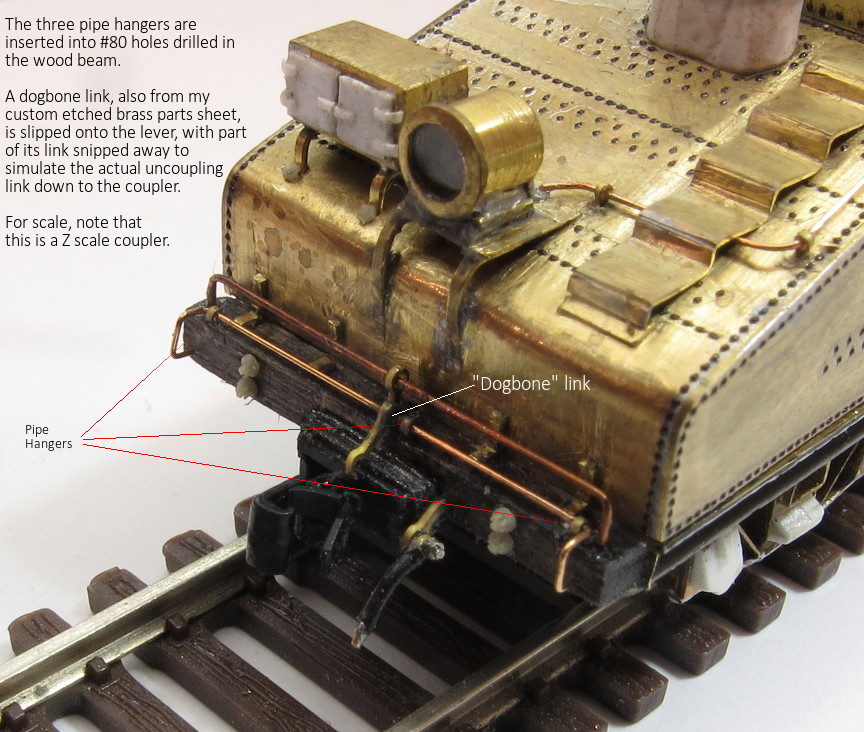

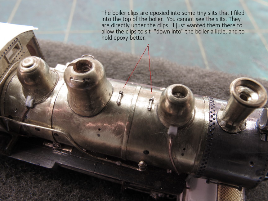

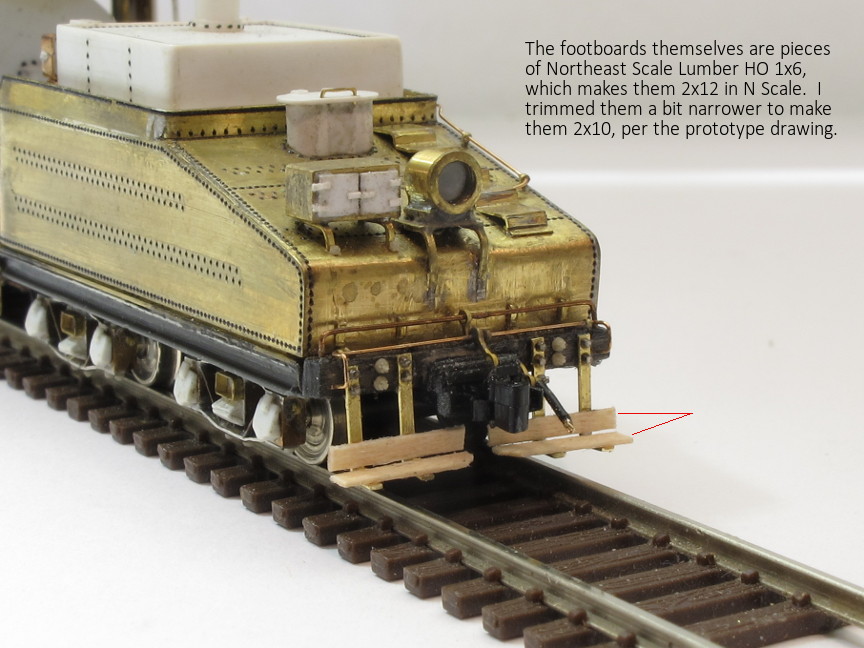

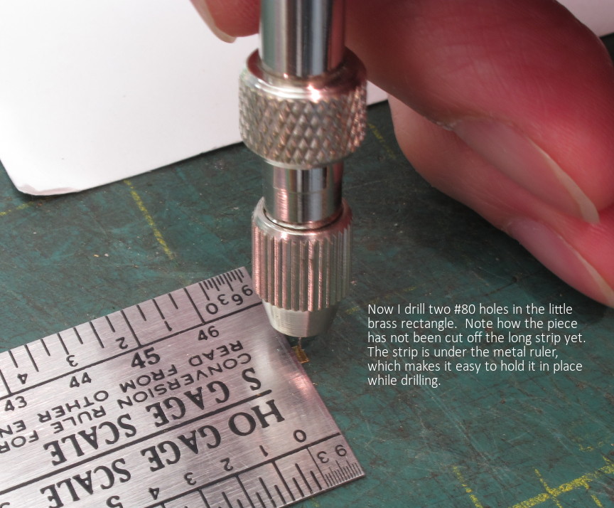

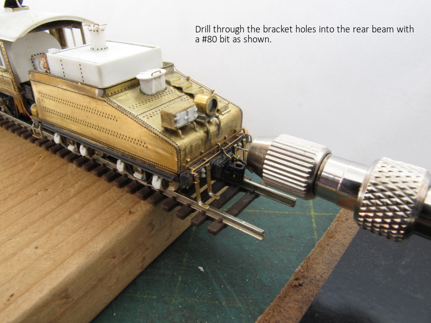

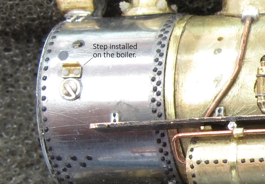

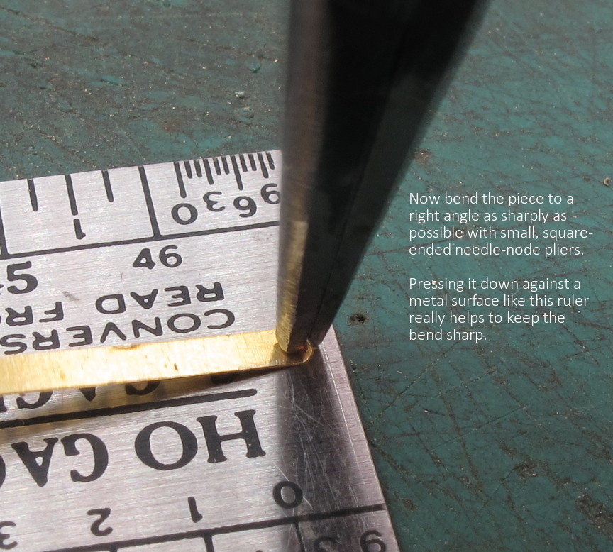

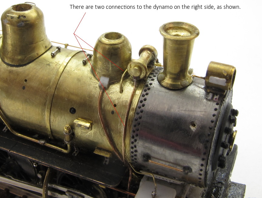

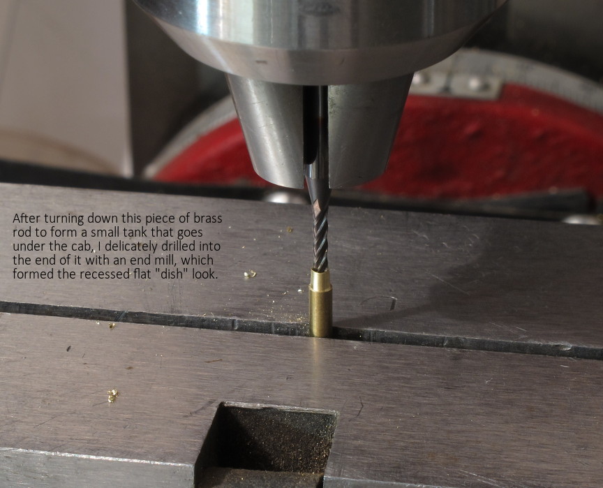

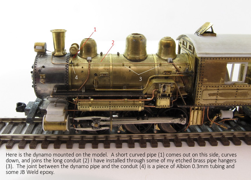

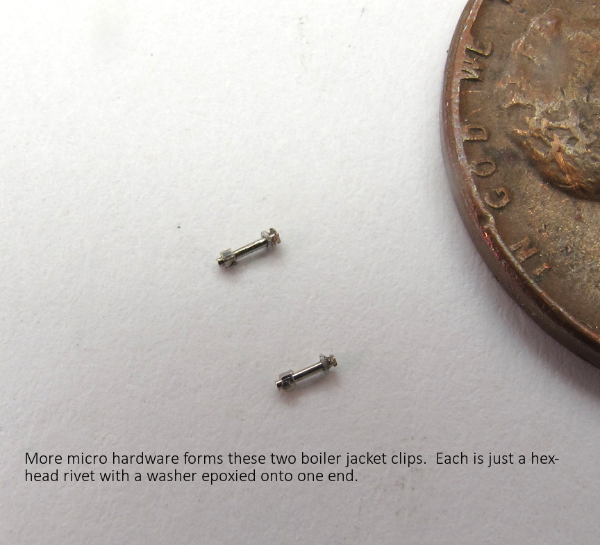

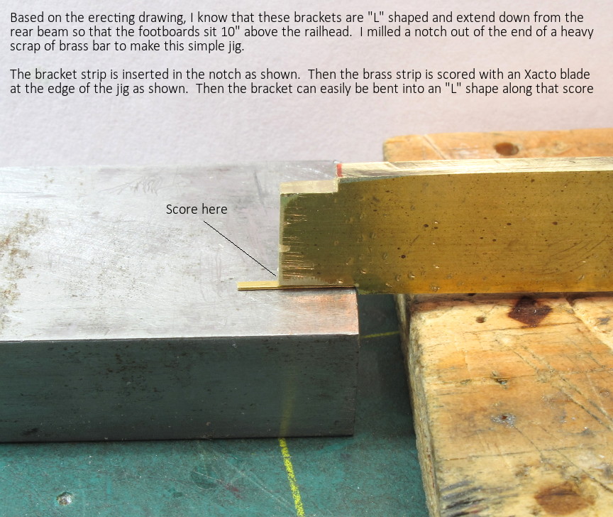

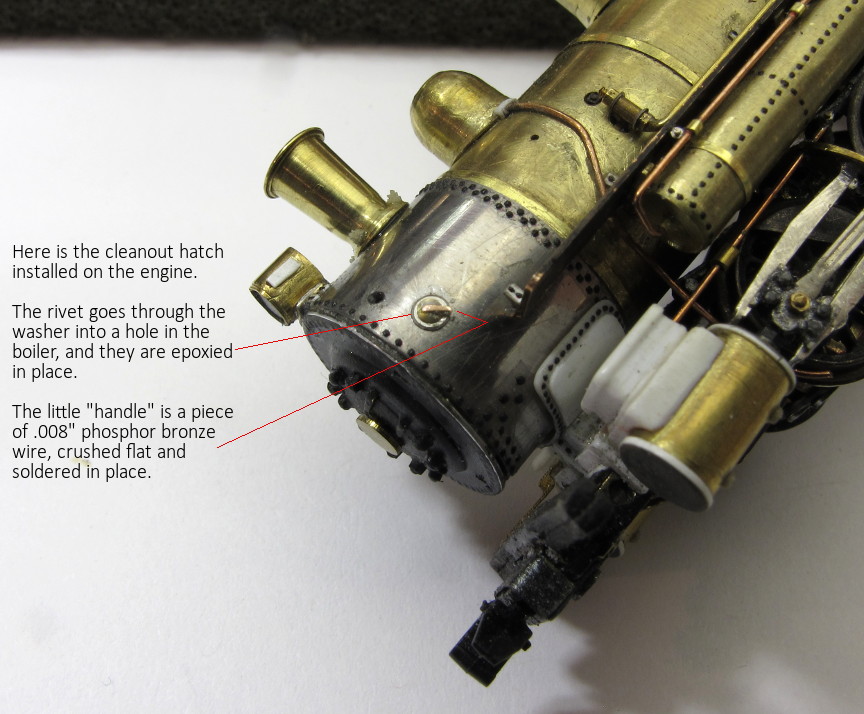

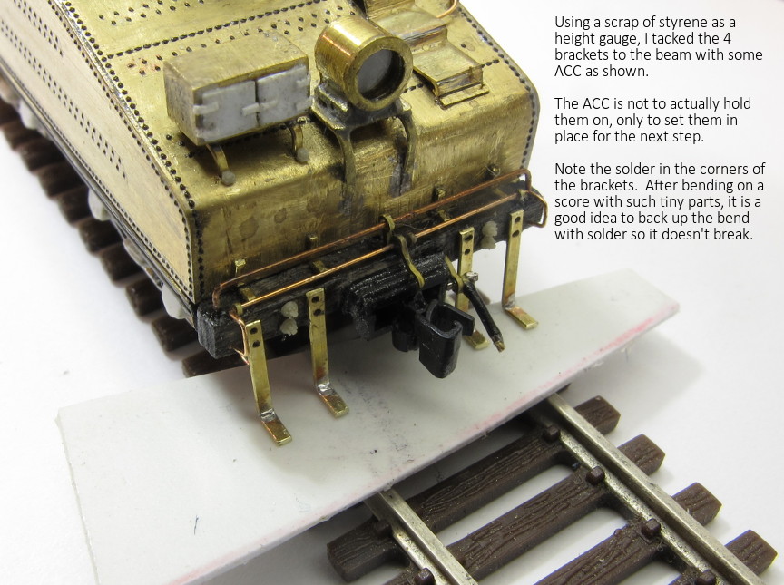

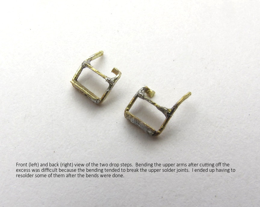

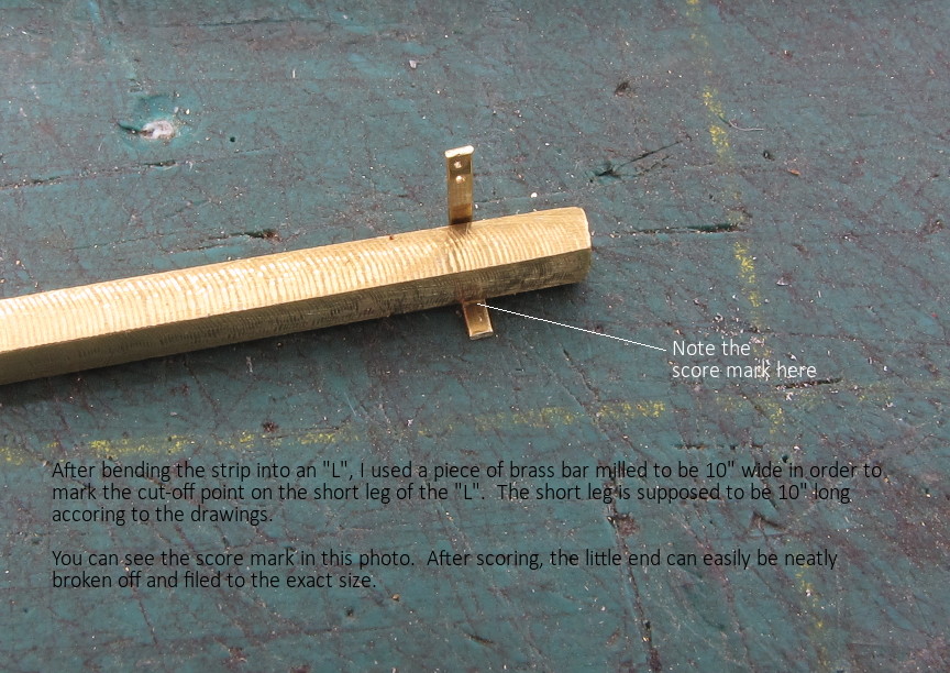

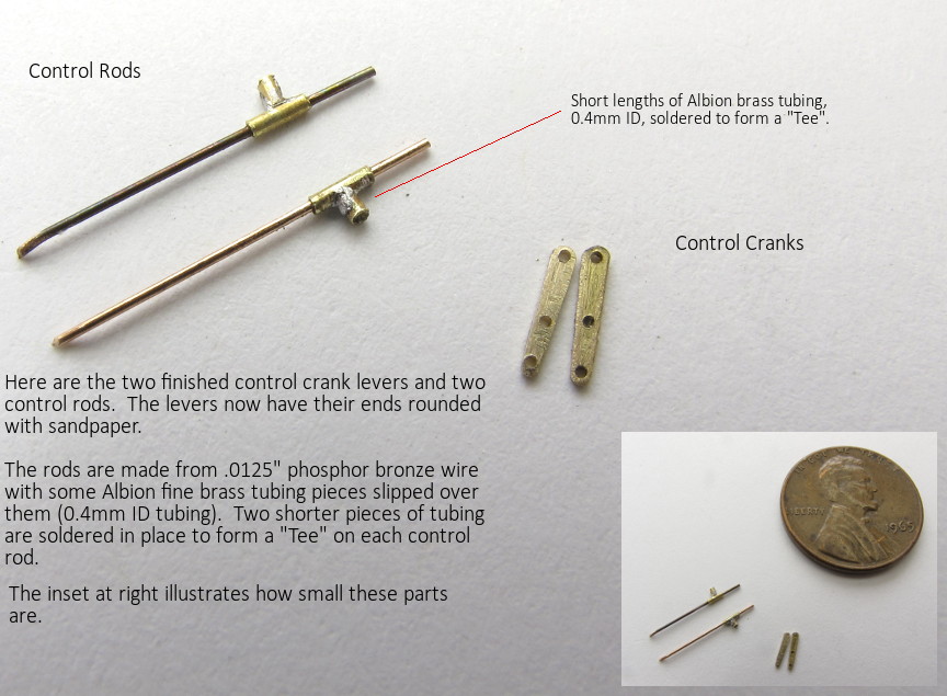

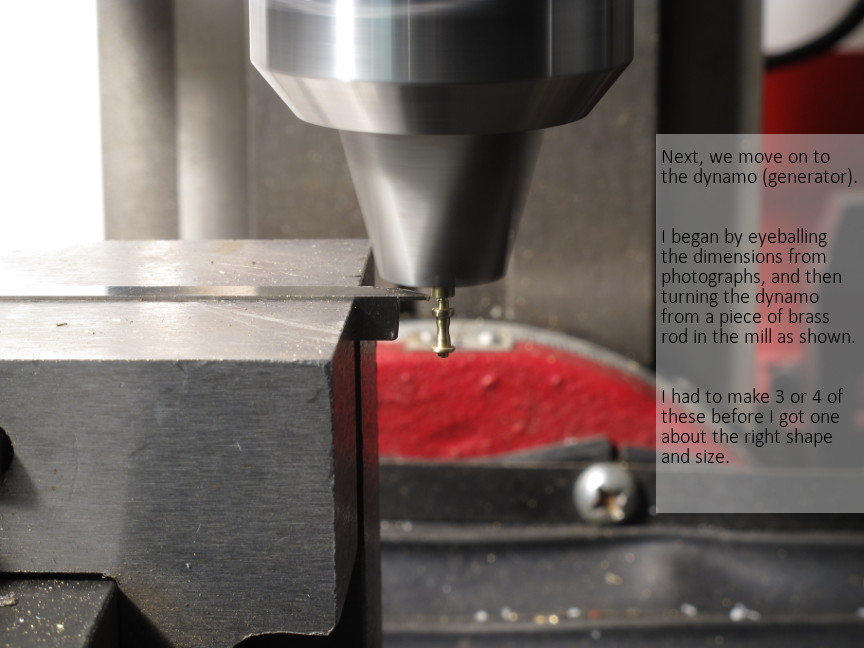

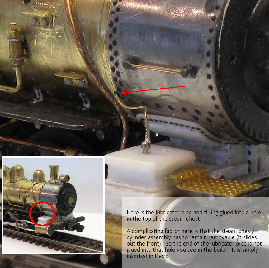

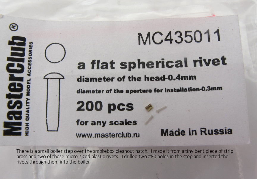

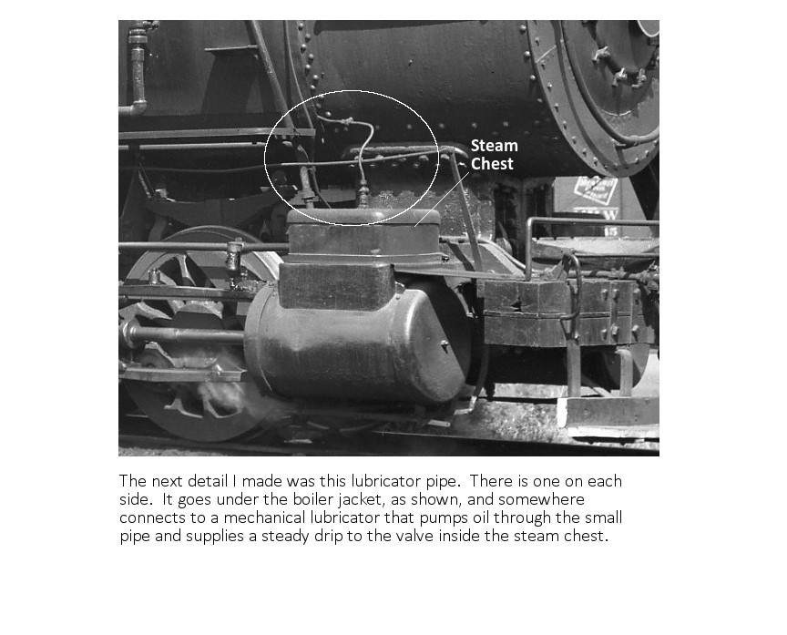

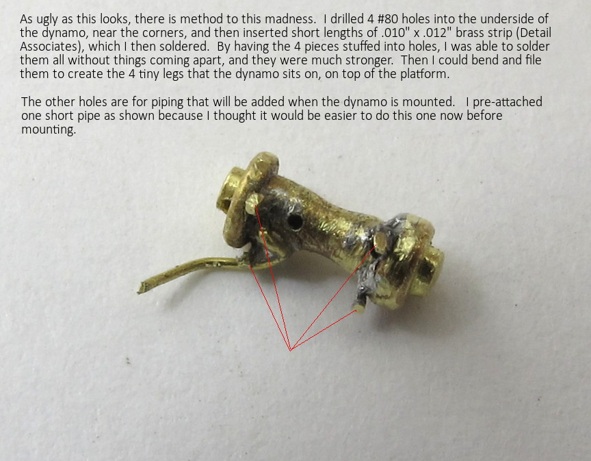

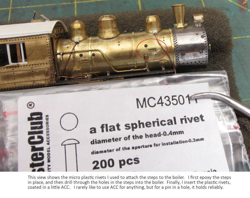

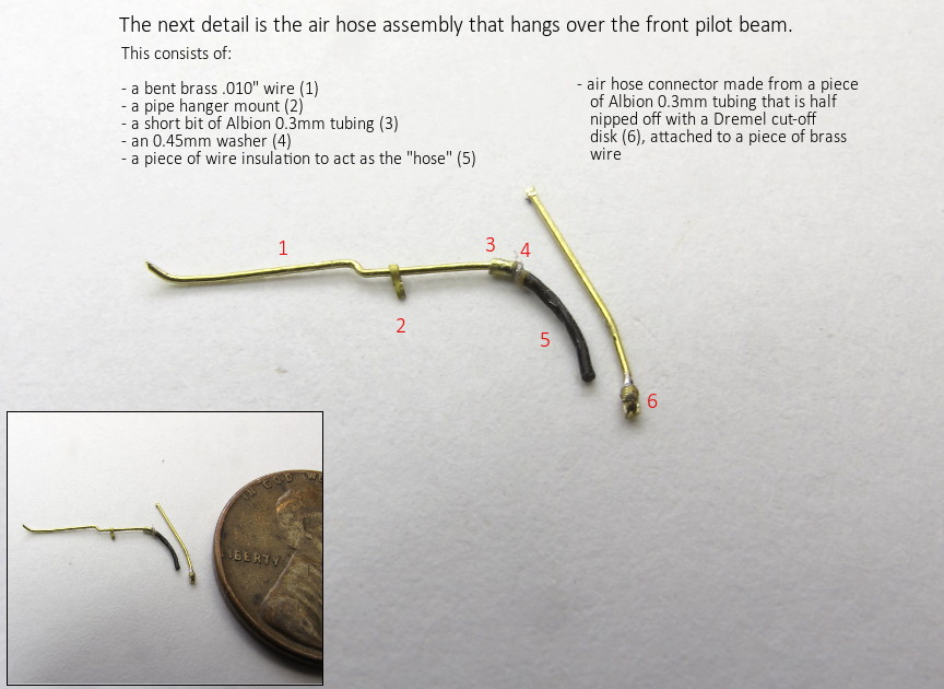

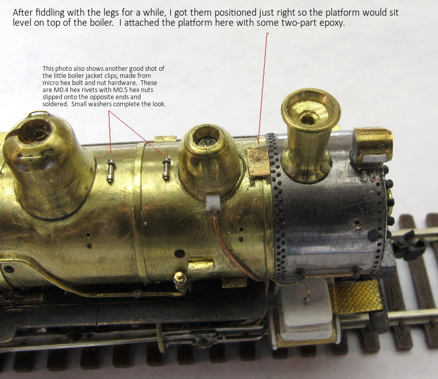

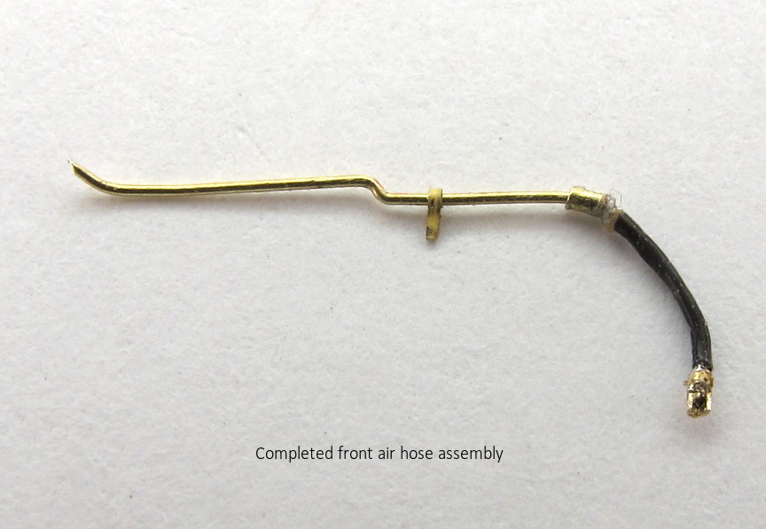

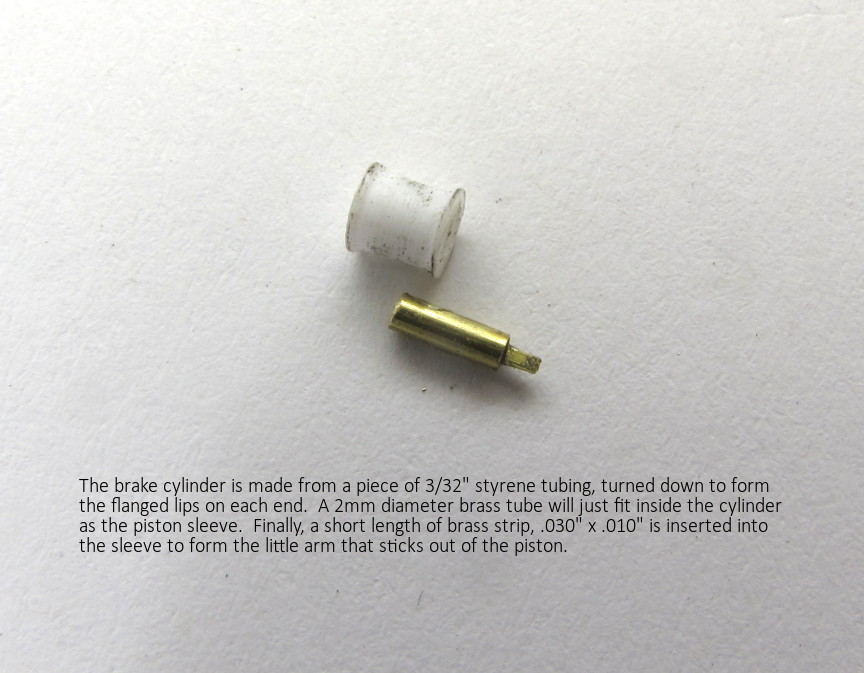

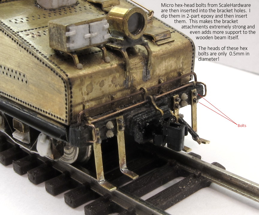

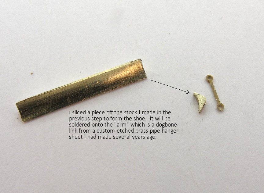

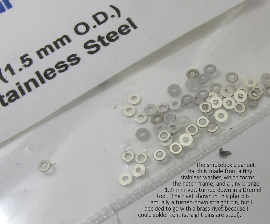

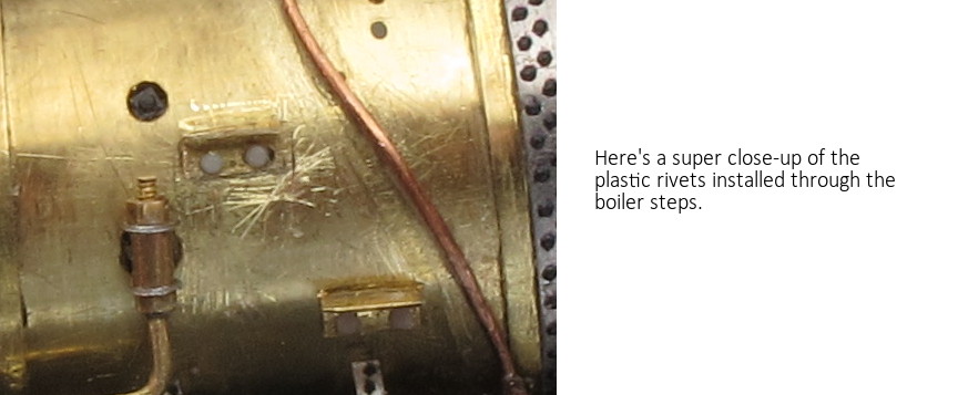

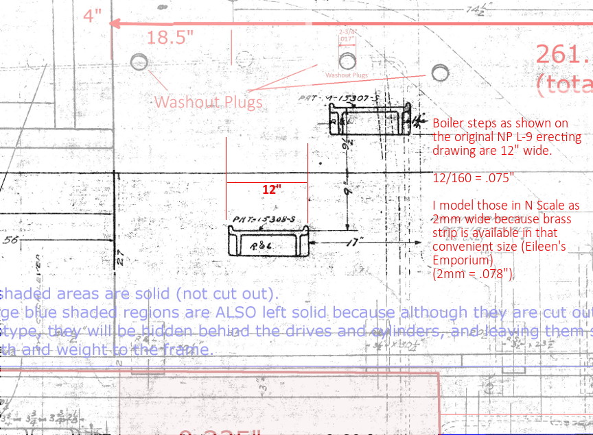

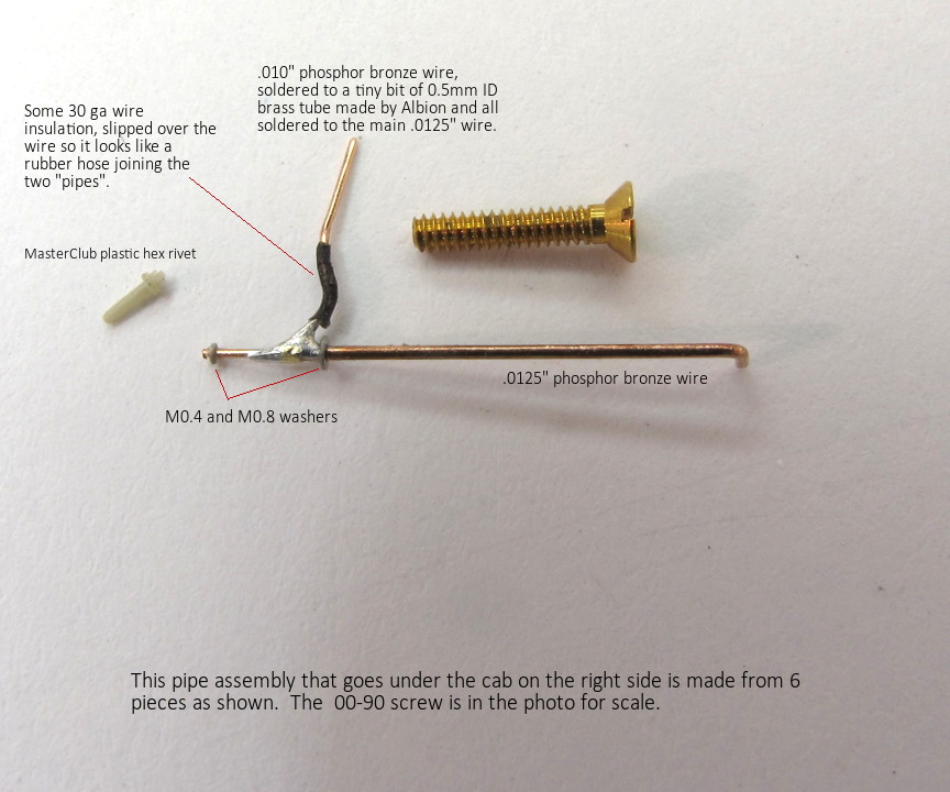

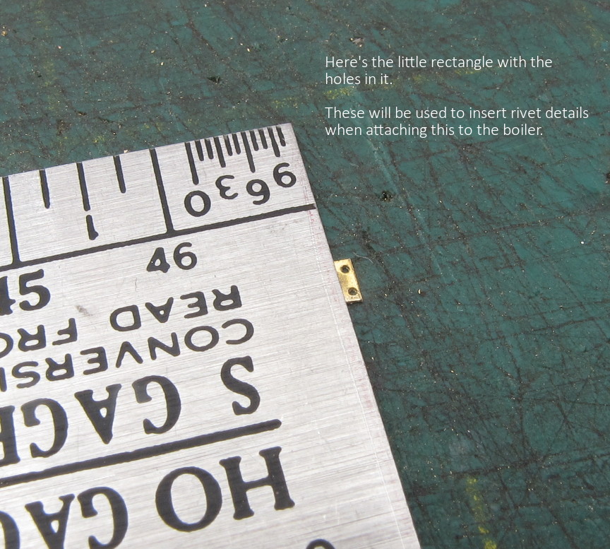

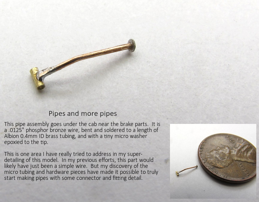

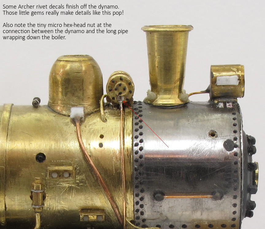

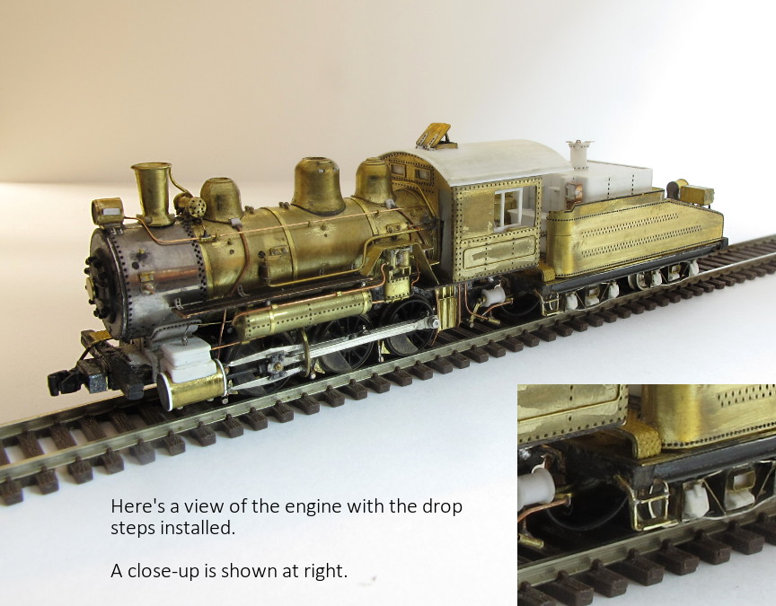

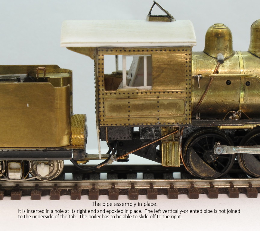

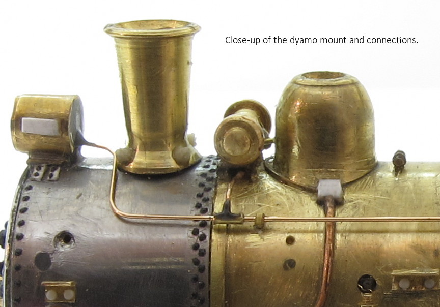

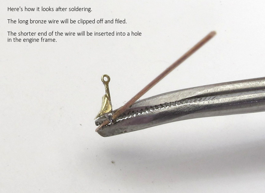

Hi everyone.  Here is the next episode of the SP&S 0-6-0 #4.
This one is all about details, details, details!  A whole assortment of boiler appliances, piping and rivets go on in this installment.
Some fun facts.
We are now at 3 years and 1 month.
The parts count on this engine is up to 907 (I went through a series of photos and counted)... and that does not count the rivet decals, but it counts everything else.
After this installment, the "work list" is down to 23 items to go.

Jaw is on floor.
The concentric milling of very tiny cylinders is mind-boggling. Much use of #80 drill bits - I break 'em by the mere looking at one. You are a master, sir.

Thank you most sincerely folks!
My post had an error in it.  It has been 3 years and 1 month, not 3 months and 1 year, since the start of the project.
Also, I neglected to mention, but you can obviously see, that another big step in this installment is that the tender now has the full complement of rivet decals on it.
