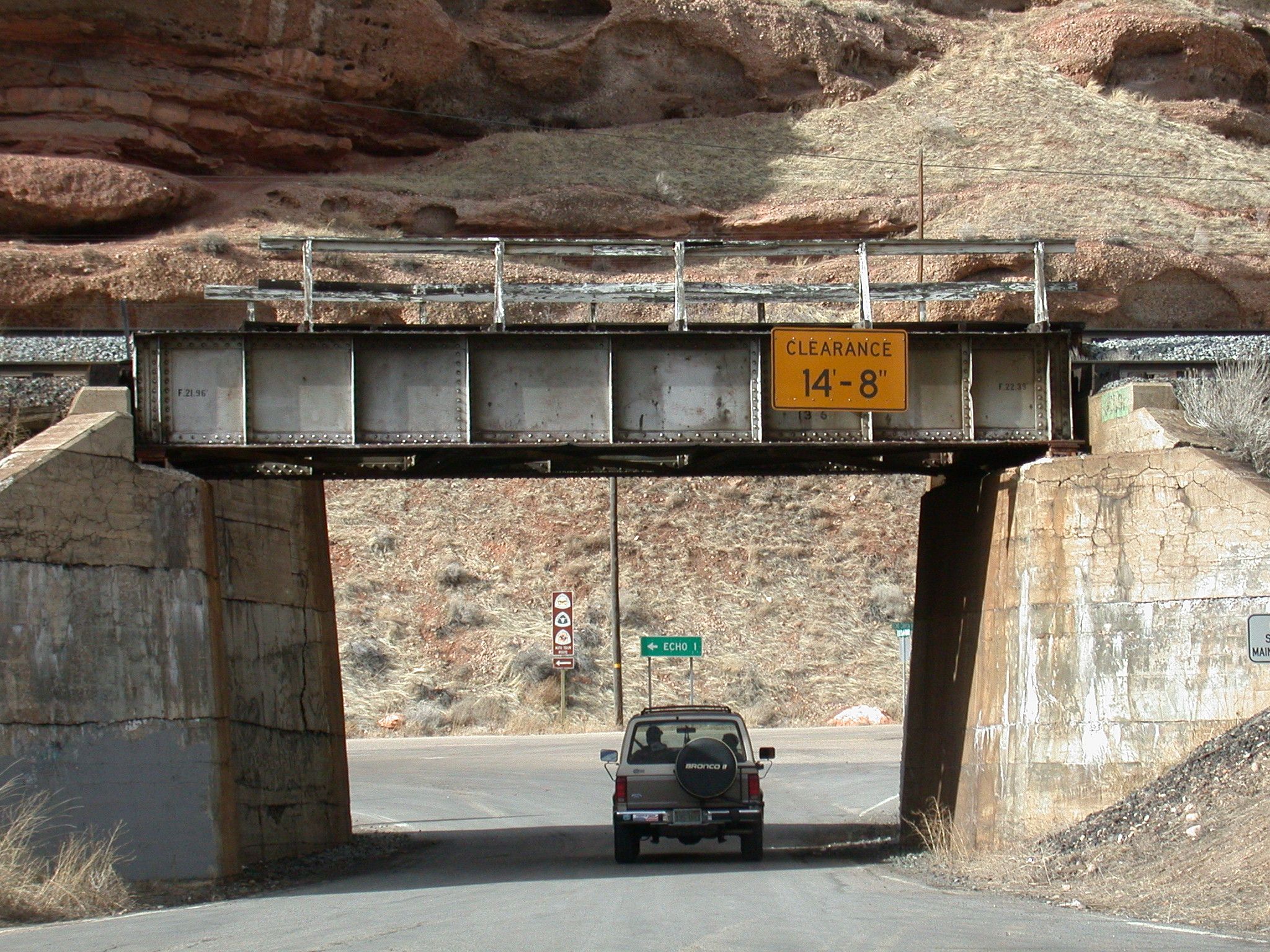

I used the new Atlas bridge kit to kitbash the one of the Lincoln Highway Overpass bridges on my Echo LDE.  I was pleasantly surprised by the excellent detail on the kit and using it was much easier than using Micro Engineering deck bridge parts, which the other bridge (being a different kind of bridge) is kitbashed from.
Photo (1) New Atlas bridge kit used for Lincoln Highway Overpass Bridge nearest camera:
Photo (2) Another view showing how I cut down and relocated the side girders to conform to the prototype's proportions:
Photo (3) Prototype Bridges Side View:
Photo (4) Prototype Bridges Top View:
So, if I were you, and I was going to build the bridges you've shown us, I would definitely use the new Atlas bridge kit as a source of quality parts.

Something struck me looking at that prototype bridge photo.   Notice how the vertical ribs are closer together near
the ends than they are out at the center of the bridge.  Why is that?  I would have thought that the maximum
deflection would occur out at the very center, and that's where you'd want closer-spaced ribs, if anything.
I took a quick gander at some other photos of plate girder bridges.  Some of them share this property, and some do not - having the ribs all spaced equally.
  • Posts: 6403
  • Respect: +4817
Re: Bridge options and advice
« Reply #11 on: October 30, 2015, 02:15:06 PM »
Max, the ribs are there to distributt the load from the center of the bridge, out to the ends and down to the shoes and into the abutments. The side ribs in the middle keep the vertical plate from buckling under load. That vertical beam, the web of the I beam is the primary load carrying member.  The flanges in top and bottom keep the plate from deflecting in and out.
It works a bit differently. The web of a beam keeps the flanges connected. The flanges do the actual carrying work. The top flange is under compression and wants to get shorter, the bottom is under stress and wants to get longer. The web keeps them together. The further apart the flanges are, the more "force" (called moment) the beam can withstand. Or you need to add more material to the flanges if the height of the beam is limited.
The vertical ribs stiffen the entire construction and prevent the web from buckling, which would contract the distance between the flanges and quickly decrease the carrying capacity.
The idea of a truss bridge is to dramatically increase the distance between top and bottom "flange", while using as little material as possible. That's why they are so open.
