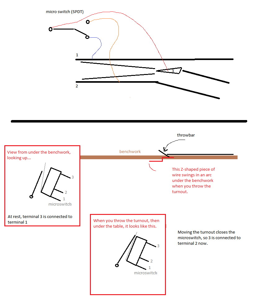

When I used over-center sprung turnouts, I bent a Z-shaped piece of piano wire, hooked to the throwbar,
passed through the benchwork, to the underside, where the other end of the "z" would press a small microswitch
screwed to the underside.    The micro switch was a SPDT.  Wires are run from the two main rails coming into
the turnouts, to the two contacts on the SPDT, with the center contact of the SPDT going to the frog.
I had to first bend with wire just in an "L", get it through the benchwork, and then make the final "Z" bend underneath,
up against the underside of the benchwork.   I hope this is making sense.
It took about an hour for each turnout, but it is dead reliable.

I wasn't talking about a slide switch.  Actually, without the over-center spring, I DO use a slide switch
on my current layout.
I was talking about a Z-shaped piece of wire hooked to the throwbar, with a micro switch, not a slide switch,
mounted under the benchwork.  When you flip the turnout from above, the wire rotates under the benchwork
and hits the microswitch.  The SPDT microswitch has feeds from each incoming rail, and the common going to the frog.
This is not a new idea.   It works great, doesn't care about DC or DCC, and is really cheap.

Max, with a micro switch, how was it able to switch polarity?  If the wire flipped the lever to the diverging route, and flipped the frog, how did it flip back? Or did you cave a switch on eac side of the wire?
Micro switches have spring-loaded plungers. SOrt of like miniature doorbell push button switch. If there is no pressure applied to the plunger, it snaps back to its at-rest position.  Since the contacts are SPDT then the at-rest position connects the common lead to the normally closed (NC) lead.

You don't care about polarity.  All that matters is that the frog is connected to the correct rail.
Let's call the two rails "+" and "-" (although for DCC they really aren't, but...)
Coming into the turnout, let's say "-" is on the left and "+" is on the right.  And let's say it's a RH turnout,
and you are going through the straight route.  So we want the frog powered as "+".  Okay.  We connect
it to "+" and the train runs through.   Flip to the diverging route, and now we want the frog
connected to "-".  As long as we do that, the train will branch right, go through the diverging route,
and it works.  As long as the frog is connected to nothing else, this all works fine.
