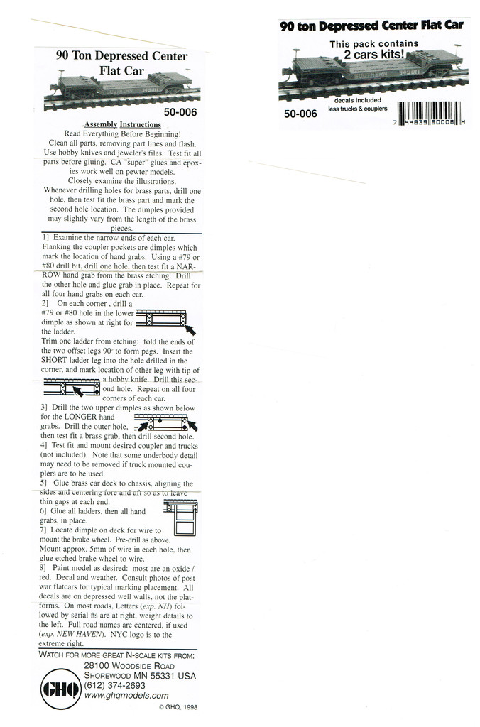

Would love to sea a scan of that instruction sheet!  Anybody have one to share?
Your wish is my command, sir.

Hi Max, well thanks for that too!  I was hoping to get the instruction sheet for the HO kit mentioned earlier by Spikre, but this helps too! Sorry I was not clear in that request. :facepalm:

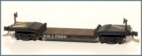

Here is one of my two that I modified into New Haven transformer cars.  I shaved the four ribs off the sides and added three back.  I also used the MTL (Kadee at the time) brakestands from the caboose railings.  The trucks were kitbashed from Con-Cor trucks.  It runs on 28" wheels, which were NWSL before being upgraded to FVMs.  Aquataur drop grab irons on the end sills.  Everything else from what I remember is from the standard kit components.
