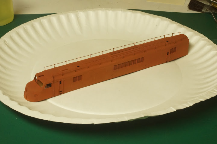

Been making a little bit of progress.
Either too much work or too much rain has held me up.
But I finally sandblasted and primed the parts.
And just finished the green paint.

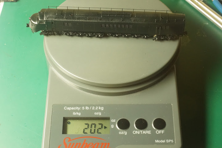

Got a lot of progress done on this today.
Green paint with clear coat.
Assembled.
Added operating headlight.
Added window glass.
Added extra weight.
Dang.   This thing weighs in at over 200 grams- that is approaching half a pound!
delamaize
  • Posts: 2656
  • Prairie Line Native
  • Respect: +1029
Re: Brass KMT Centipede Re-powering
« Reply #48 on: June 07, 2015, 03:41:54 AM »
Damn, that thing is going to be a stump puller.

nickelplate759
  • Posts: 3862
  • Respect: +1612
« Reply #52 on: June 07, 2015, 09:21:08 AM »
Amazing work!
What do you use for primer on brass?

Amazing work!
George
Hi George,
I use a Pasche air eraser to "sandblast" the brass with 220 grit aluminum oxide.
I wash with acetone and dry.
Then airbrush old Floquil Zinc Chromate Primer.  It really adheres to the brass.
