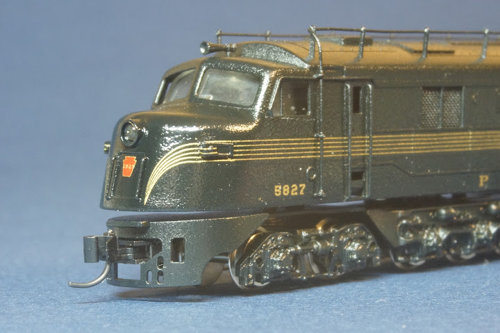

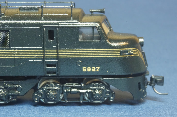

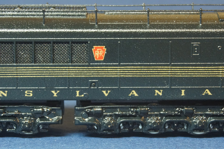

The decorating is done.
Window glass and headlight add to the lifeless old brass model.

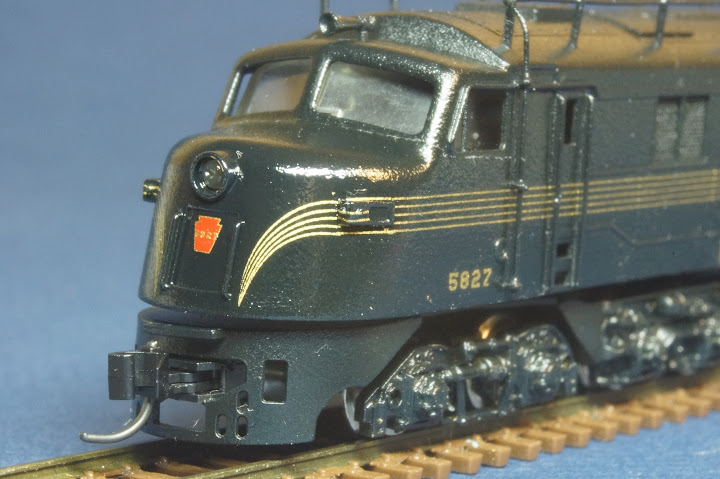

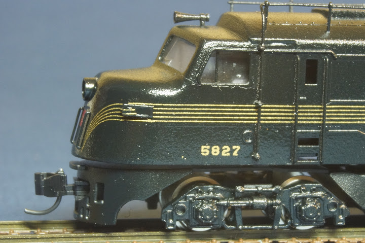

Oh, and by the way.  I know the window glass is not perfect.
But I just did not feel like all the effort required to get perfect glass (since it would be done by scratch).
I found something that was close.
You only notice it in close photos.  When this thing is running down the track pulling 10 passenger cars, you don't even look at the glass.
