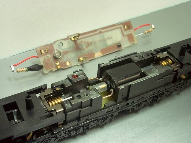

So the moment of truth arrived for the project engine.  Here are the test measurements:
DCC Speed Step 1/28 - speed is less than 1 mph.  Motion is constant, but jerky.  A flywheel would smooth out the jerkiness, but, well, we don't have room for one.
Speed Step 2/28 - speed is 3 mph.  Engine runs much more smoothly.  Performance is ok, by my standards.
Speed Step 7/28 - speed is 15 mph.  Either without, or while pulling 14 boxcars.  ok.
Speed Step 14/28 - speed is 25 mph with 14 cars, 32 mph without.  ok.
Speed Step 20/28 - speed is 25 mph with 14 cars, 40 mph without.  A little slow, but still ok for this class of locomotive.  I'm thinking that the speed may increase with more break-in miles.
Higher speed steps do not increase the engine speed, but they do make the electric motor really hot.  Too hot to touch.
The other annoying thing is that the engine rocks back and forth after pulling 14 cars for about 15 minutes or so.  This is apparently caused by the traction tires moving sideways in their grooves, and changing their shape ever so slightly.  Those drivers have to go.  Going to use Kato Mikado tires, too.
I wish I had a way to measure the motor current and voltage, but, with DCC, I don't.
« Last Edit: May 12, 2015, 09:23:07 AM by nscaleSPF2 »

« Reply #42 on: May 12, 2015, 11:33:07 AM »
run the loco on DC and measure the volts and amps.
the current will be the important part.  the voltage will be higher.
With most decoders you will get a good approximate by subtracting 4 volts.
victor
  • Posts: 6422
  • Respect: +1919
Re: PRR H10 Remotor
« Reply #43 on: May 12, 2015, 12:36:51 PM »
Ack!  Heat!   No!
I agree with Victor...
Bypass the decoder, run this on DC, and measure that current before you do anything else!
If that motor got that hot, it may already be too late.
This one really concerns me:
"Speed Step 20/28 - speed is 25 mph with 14 cars, 40 mph without."   That's a huge swing with only 14 cars.
Coupled with the high motor heat, either the motor is plain overloaded or there are frictional
forces in the geartrain that get really high when there are some cars on the train.   That little Mashima is
pretty powerful for its size, so I think it should be able to handle this without getting hot.  Can you
look at it running with the shell off?  Maybe with cars on it, the worm is getting pushed hard against
one end or the other, or the ball/cup is using up all its slack and pushing on the motor bearings.

« Reply #44 on: May 12, 2015, 04:08:17 PM »
My guess by looking at the earlier pictures is that the worm under load is driving itself into the bushings and causing the extra drag. There needs to be a brass or teflon thrust washer on either end of the worm shaft between the worm and the bushing. That may help some.
