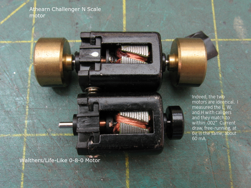

Athearn Challenger and Life-Like 0-8-0: Same motor
« on: February 06, 2015, 08:59:28 PM »
Maybe some of you folks already knew this, but I never did.
I had a Challenger motor out today, and noticed.
The only difference is the flywheels.  Just more useless information to fill up your brain!
(Actually, if your 0-8-0 motor ever fails, this would be handy to know, because you can
get these motors from Athearn.  I don't know how Walthers is on stocking parts
like this).

  • Posts: 6505
Re: Athearn Challenger and Life-Like 0-8-0: Same motor
« Reply #3 on: February 06, 2015, 09:49:08 PM »
The other thing about this motor is that you may recall I tested the dickens out of it
trying to find other motors that would do better than this in the 0-8-0, and except for adding a gearhead,
I really could not beat this thing.  It starts and runs reliably at well below 2v (around 1.7, actually).
Despite its 3 poles, it is smooth and powerful, and quite compact.

Max,
Could you please post the L, W, H of that motor as well as the shaft diameter?
Many thanks,
victor miranda

  • Posts: 6505
« Reply #13 on: February 07, 2015, 02:33:11 AM »
If you need to be convinced of this motor's merits:
https://www.youtube.com/watch?v=GcMYWWEGh9w
Watch at about 1:40, nearer the end of the video.  You will see what this 3-pole could do in the 0-8-0.
As for the motor's dimensions:
W: 10mm
H: 15mm
L: 19mm
Shaft diameter 1.5mm
Shaft length (dual shafts, same length on each end):  3.5mm
