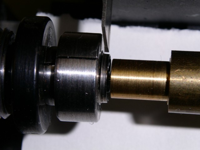

I cut a groove with a parting tool in mine:

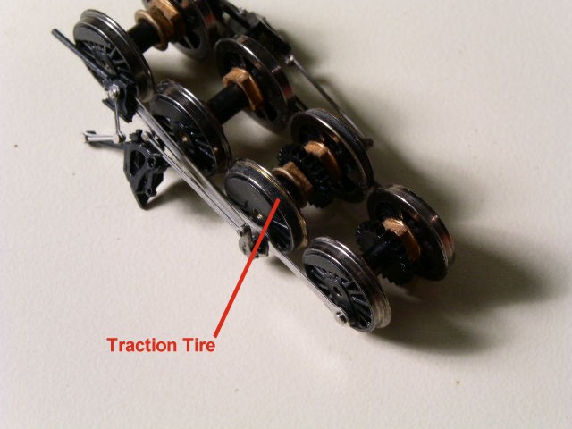

A Kato 2-8-2 traction tire will stretch over the larger driver:

Rasputen:
Can you show more detail of how that wheel is being held in your lathe? You have some sort of
pin through the center of the wheel, chucked in the collet. What's the big brass piece on
the outside of the wheel that keeps it in? Did you turn that specifically to hold this wheel?
I don't know the machinist ins and outs of setting that up, and I'd like to see.
