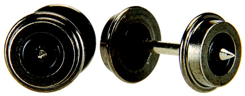

I think the FVM wheels look much better than the Atlas ones, which have a very wide tread.

The Atlas metal wheelsets look primitive compared to the FVM wheelsets. See before buying if possible.
Atlas has some new metal wheelsets that are very nice that they are including on the Master PS1 boxcars, but I don't think these are available separately yet.

« Reply #10 on: January 13, 2015, 11:43:01 PM »
Here's a pic of the Atlas wheels:
Mark5 said it best, they look kind of primitive.
