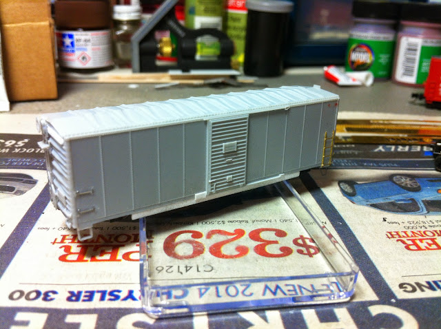

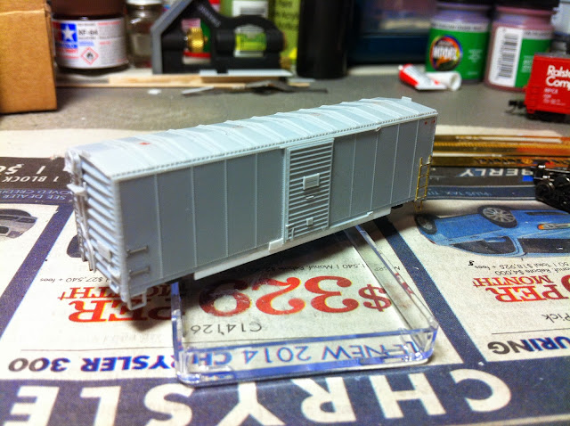

I found some time this weekend to finish up a pair of IM 40-foot boxcar kits, to represent EL's Meadville shop rebuilds.  These N scale kits allow you to use different end/roof combinations on the 10'6" core.  I added the reinforced side sill on both, and used BLMA etched grabs and short brass ladders on the A ends.
The first one represents a 1941 build, with 5/5 ends and panel roof (74500-74999 series):
The second one represents late-40's construction, with R+3/4 ends and Stanray diagonal roof (70250-71845 series):
I used a mix of Pollyscale paint, the excellent Prime Mover Decals set for the main lettering, with Microscale ACI labels and COTS plates.  I finished them off with artist oils on the roof and a light wash on the sides.  I swapped in Atlas Barber S2A trucks in place of the crappy kit parts and body-mounted Micro-Trains 1015s:

   Frank,
    Great Cars !!
   but watch the cars heights, the ex-Erie cars were 10'4", while the
  ex-DL&W cars were 10'.
   the ORER may go into which groups were which.
   some cars had National Type B trucks.
   any of the Gray Rebuilds coming ?
