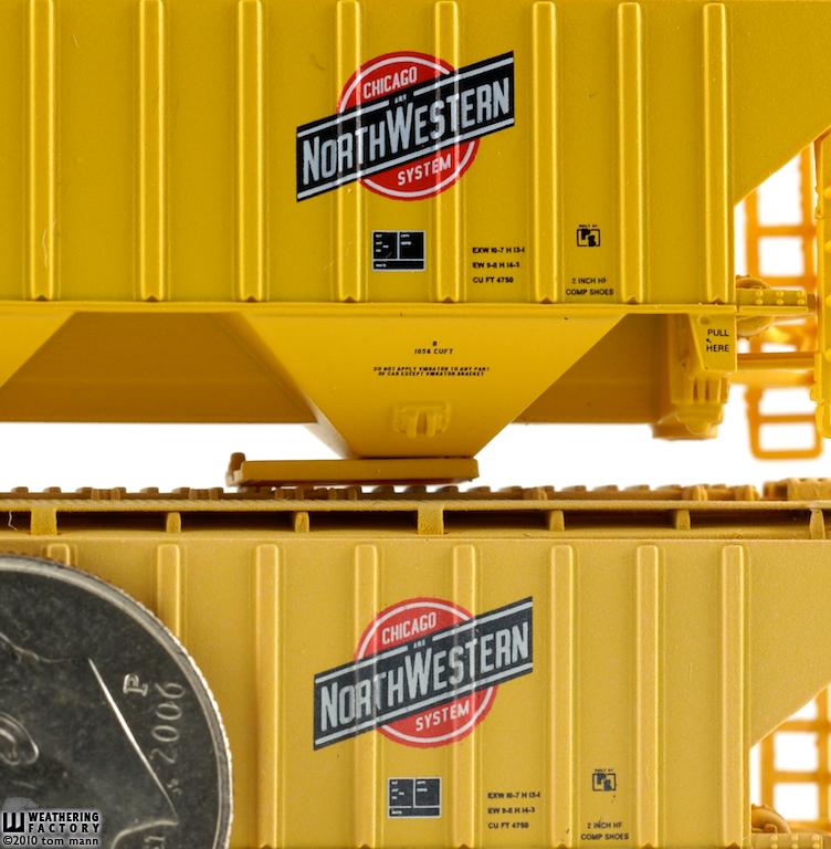

Again, if you use paint straight out of the bottle or tube for the purpose of fading, you'll end up with what looks like a spatter effect.  The paint was designed to cover a surface, so the only way to achieve a fade would be to allow the paint to partially cover the surface.
Polly Scale was an excellent paint for fading, and I used Aged White and Reverse Osmosis water (i.e., water without any minerals) to get an effect like the bottom image:
I would think this is the "gold standard"-even magnified, there is almost no evidence of paint pigment or spatter.
