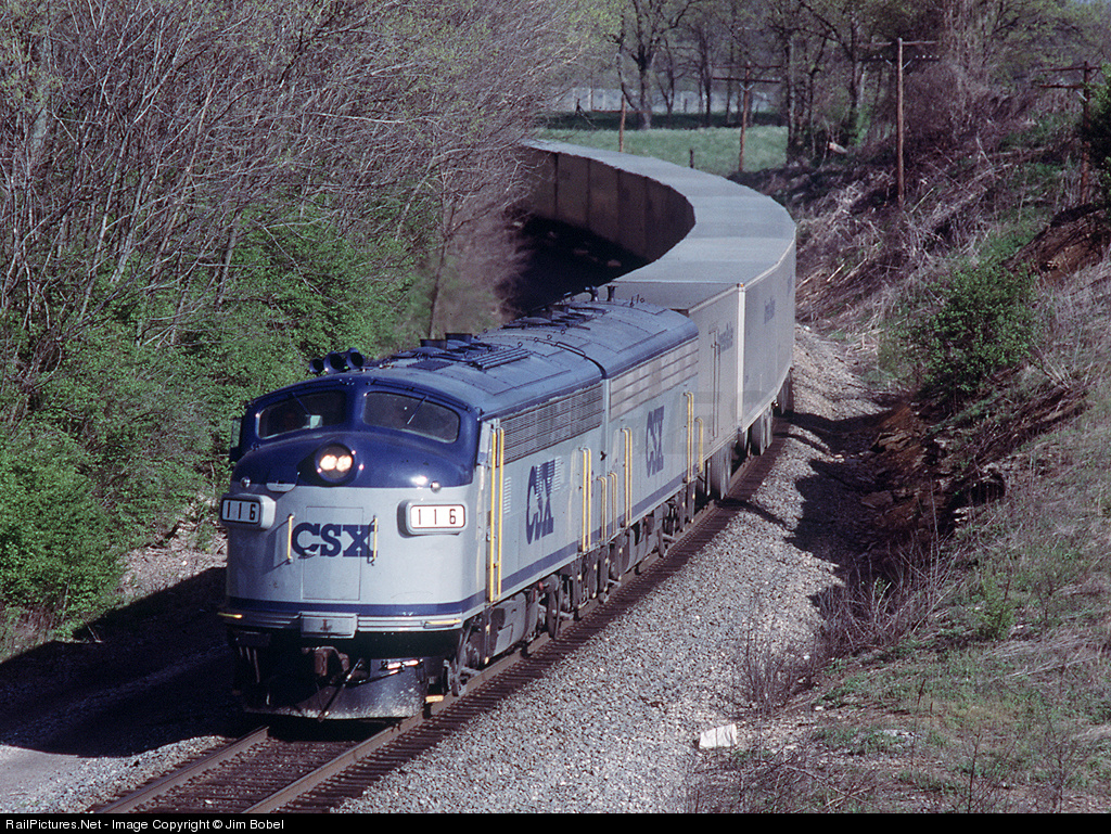

  • Posts: 3790
  • Respect: +2077
    • My website
Re: Model Power FP7A Modeller's Version
« Reply #13 on: September 13, 2014, 10:47:35 AM »
Dave,
"116 was an F7."
Dave.  This is VERY commonly reported, but technically untrue. (as far as modeling goes.)
The reason it is called an F7 is because the railroad often called it an F7-- for no other reason than horsepower.
116 was originally bought by Clinchfield as a late model F3A.  It had slots for the dynamic brake area.
In other words, from the side it LOOKS like an F7, but when looking at the roof only- you can see it is an F3.
The railroad uprated the prime mover to F7 standards.  Thus they started calling it an F7.
Find a roof shot of the 116, and you will see what I mean.
Of course, a lot of people would not care.  But I lean toward accuracy.
Looks like an F7 from the side....
But when you go up higher, you can see the F3 dynamic brake slots (no fan).
