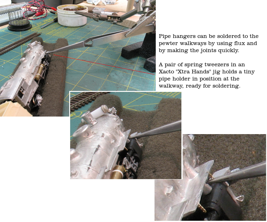

- Soldering the pewter metal could be tricky, but you could build the whole thing with 2-part epoxy and will still work.

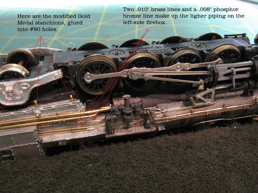

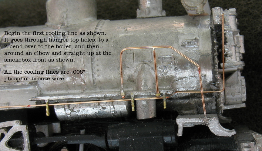

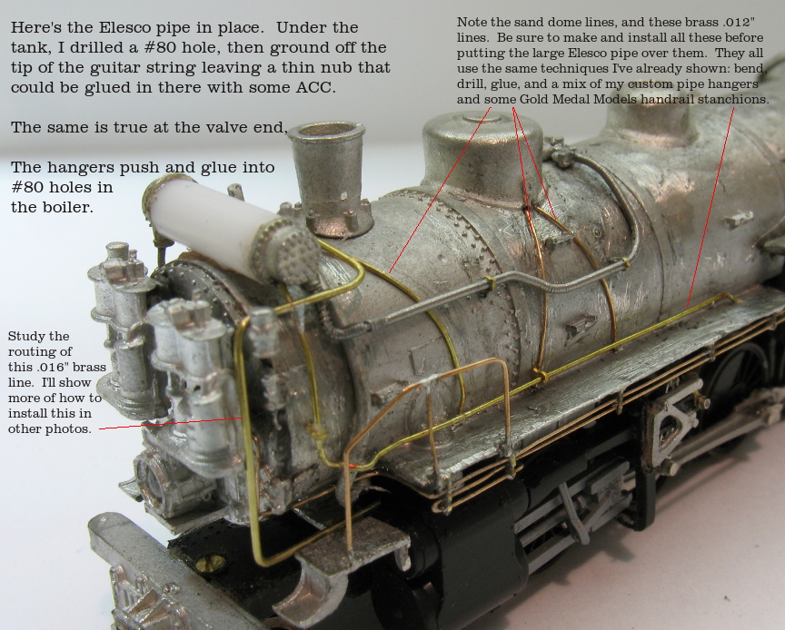

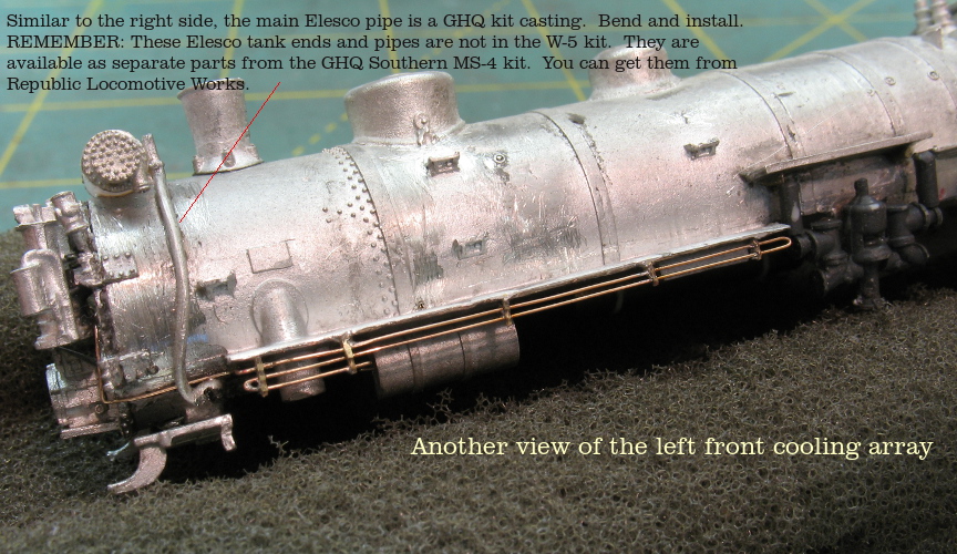

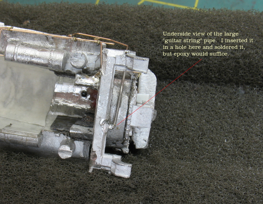

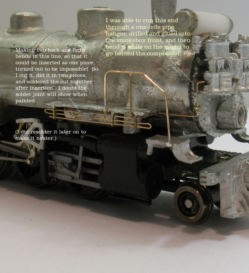

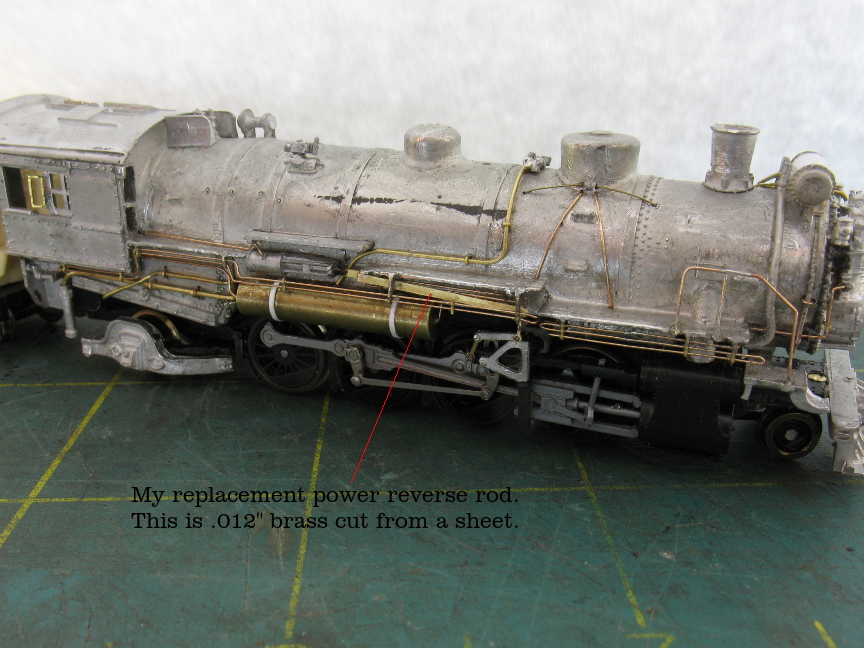

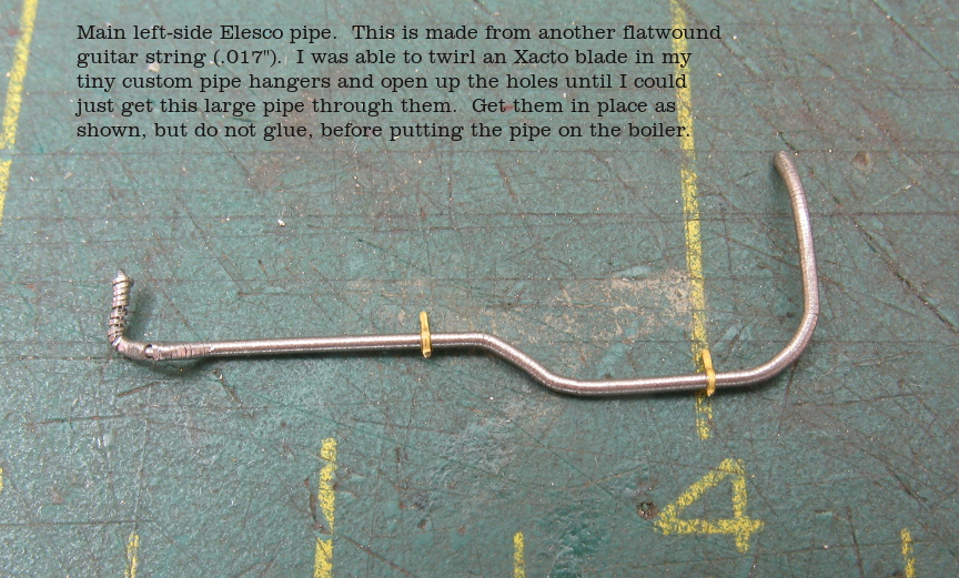

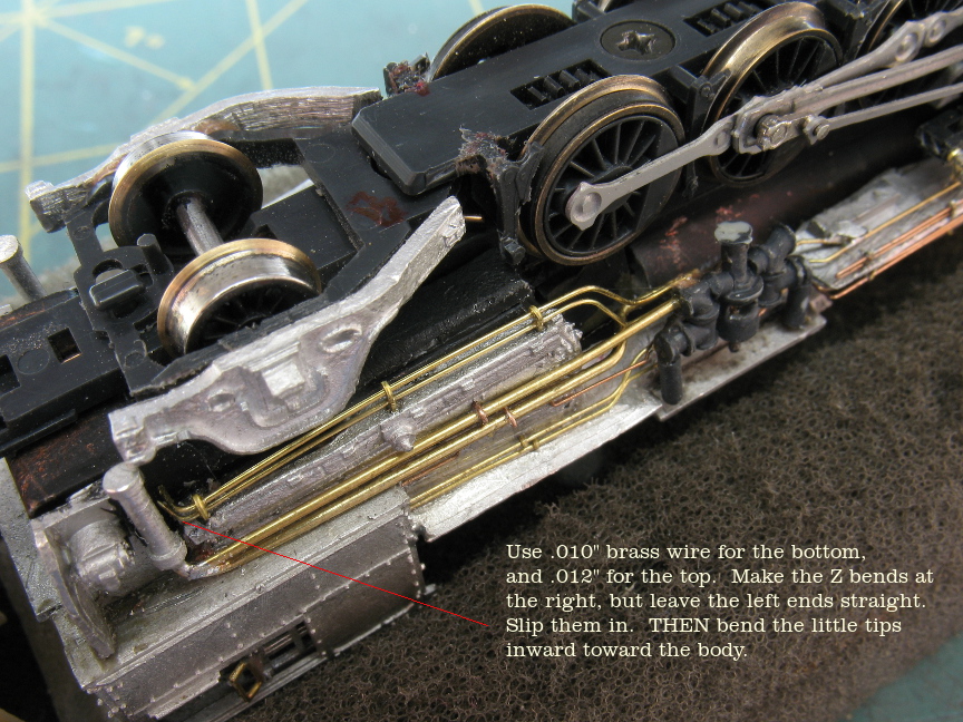

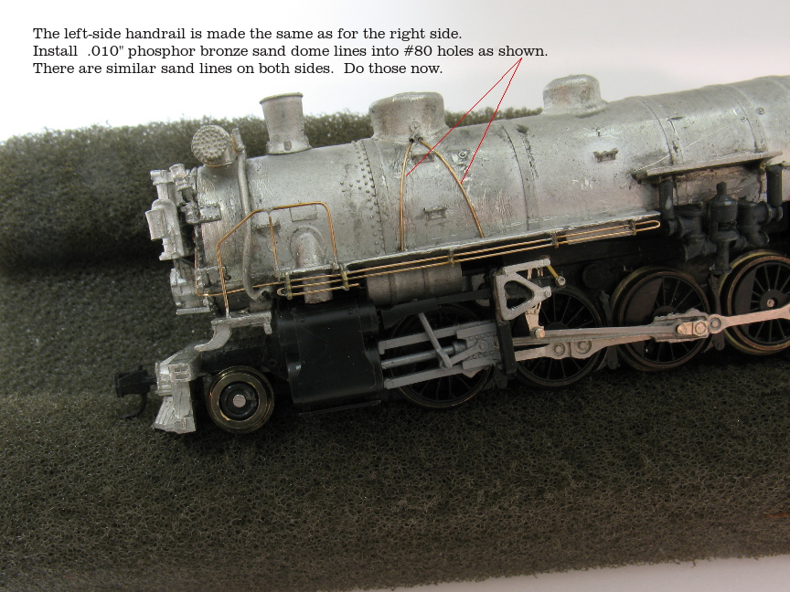

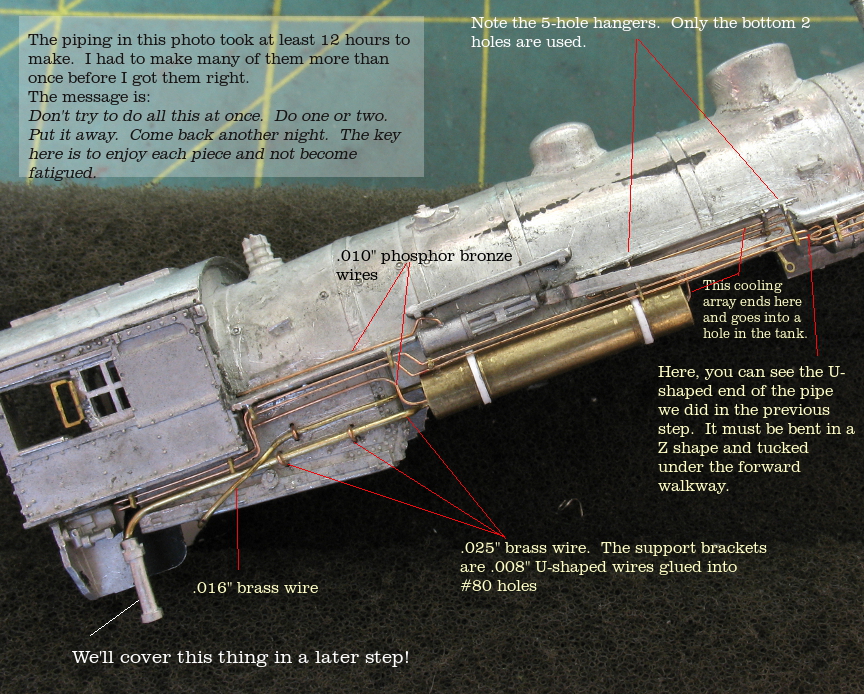

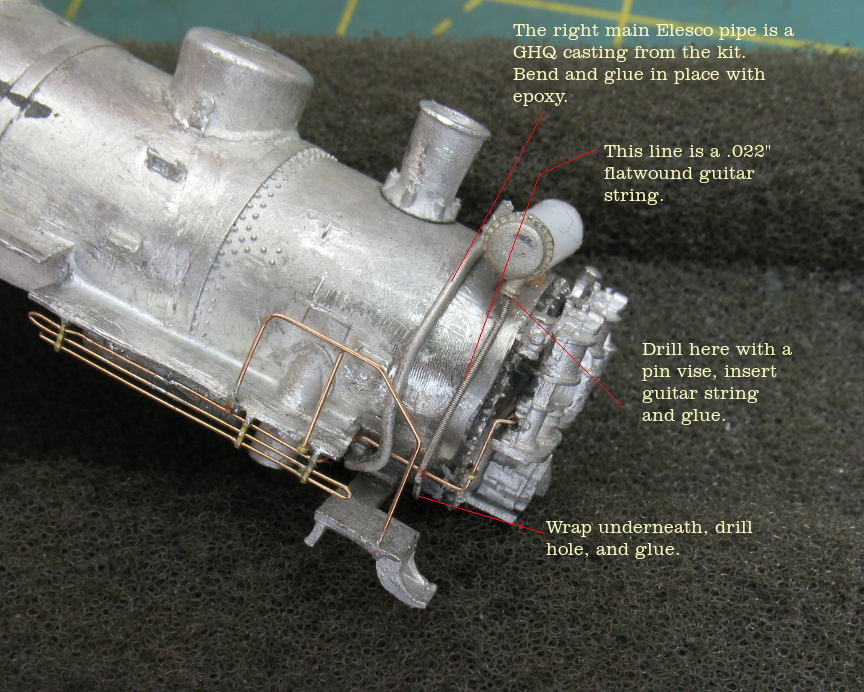

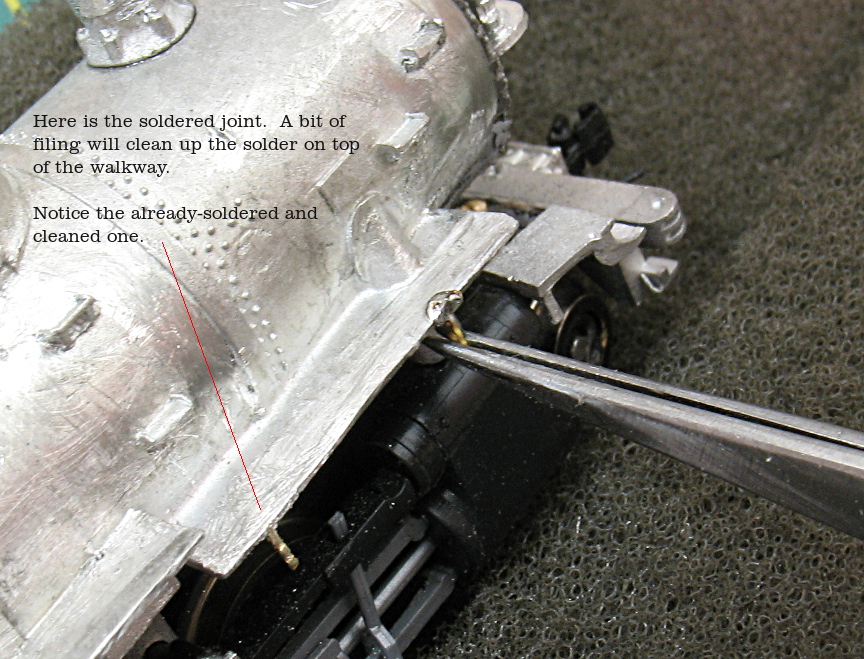

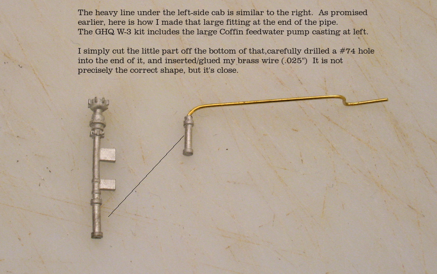

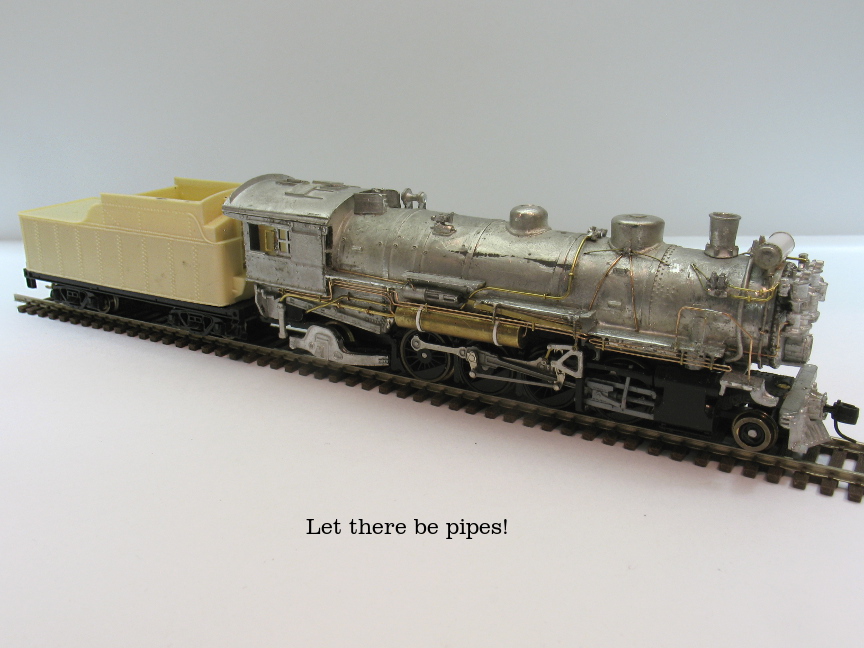

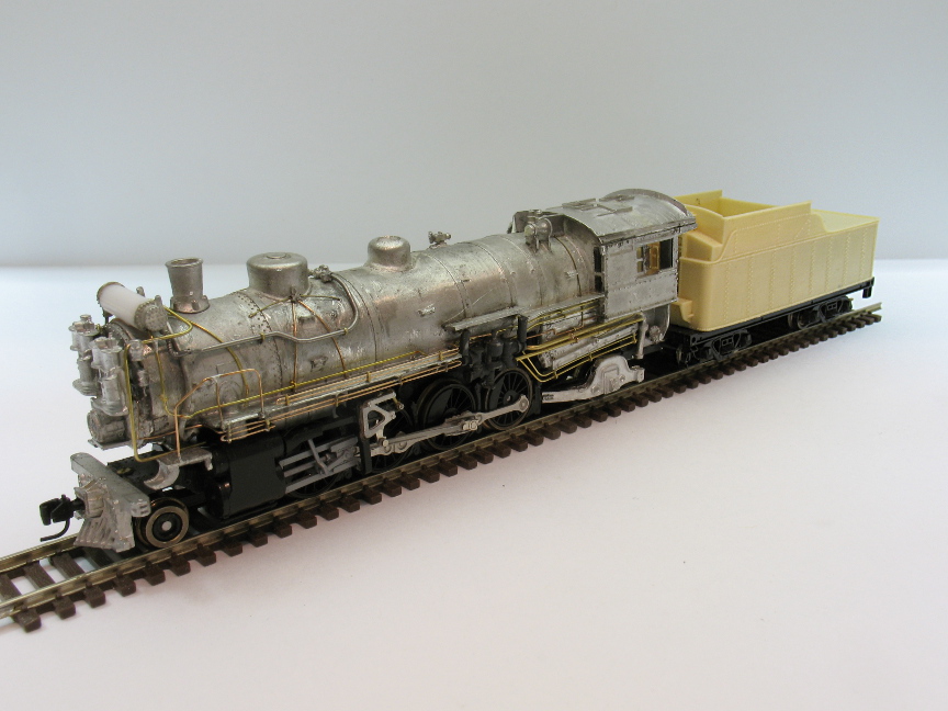

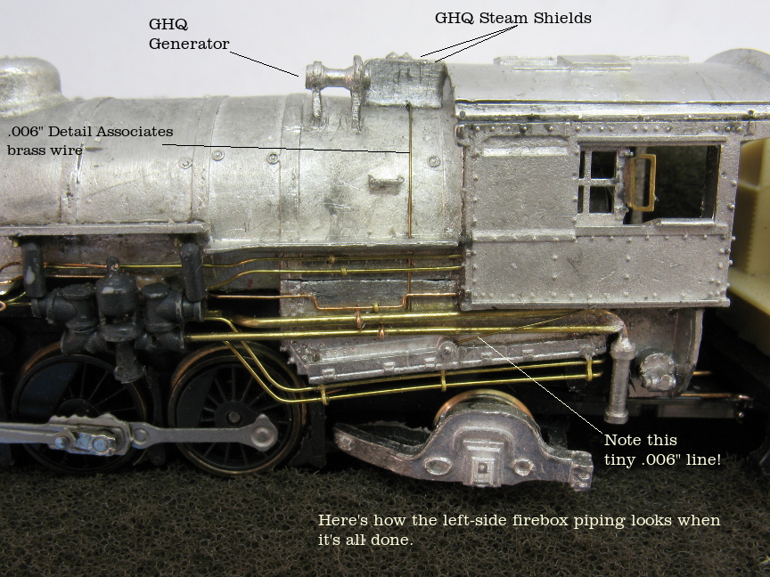

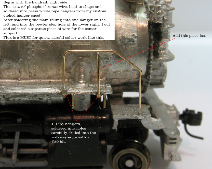

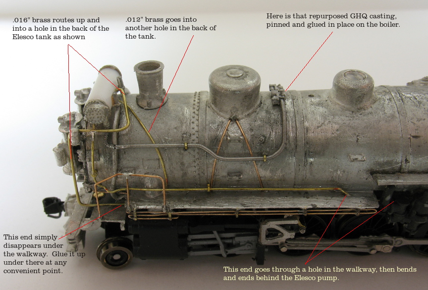

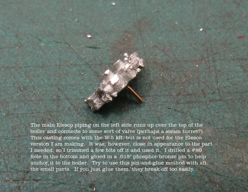

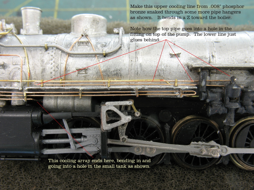

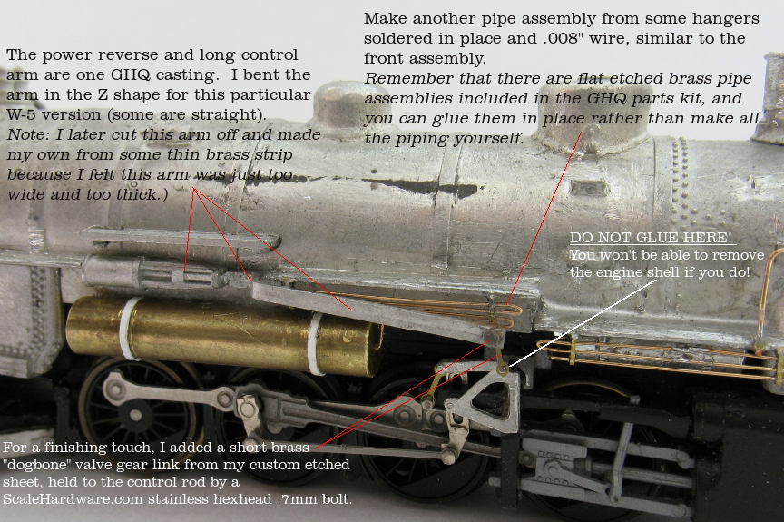

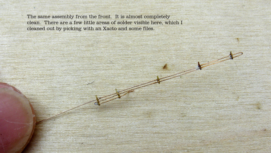

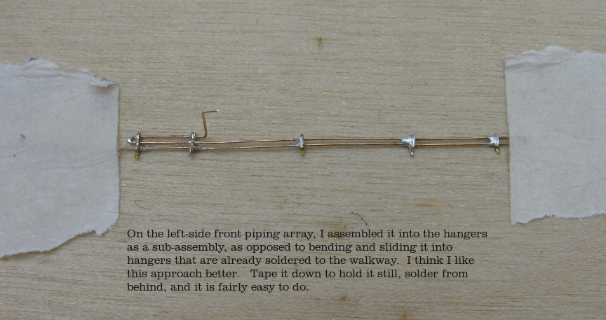

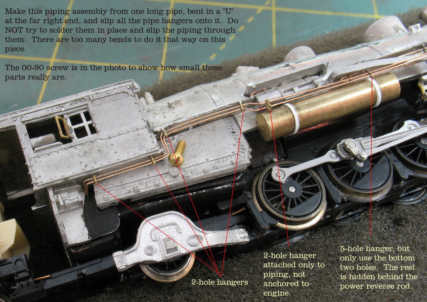

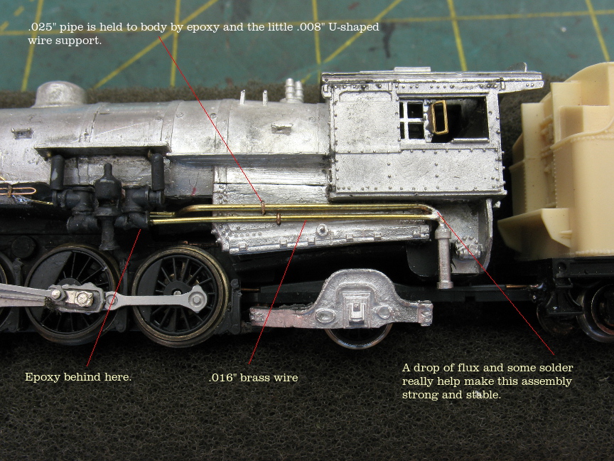

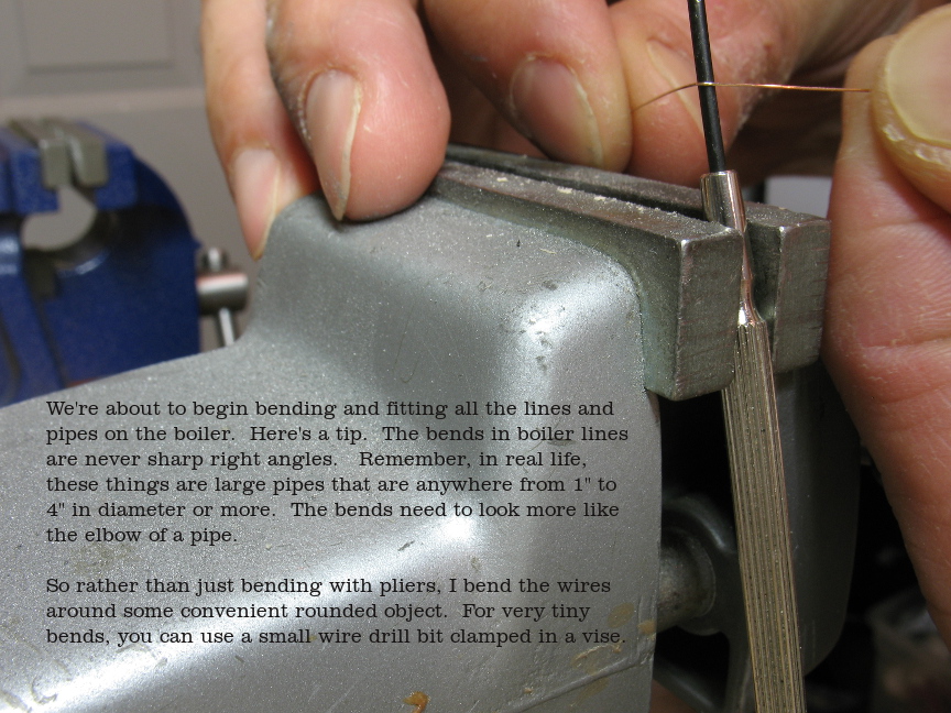

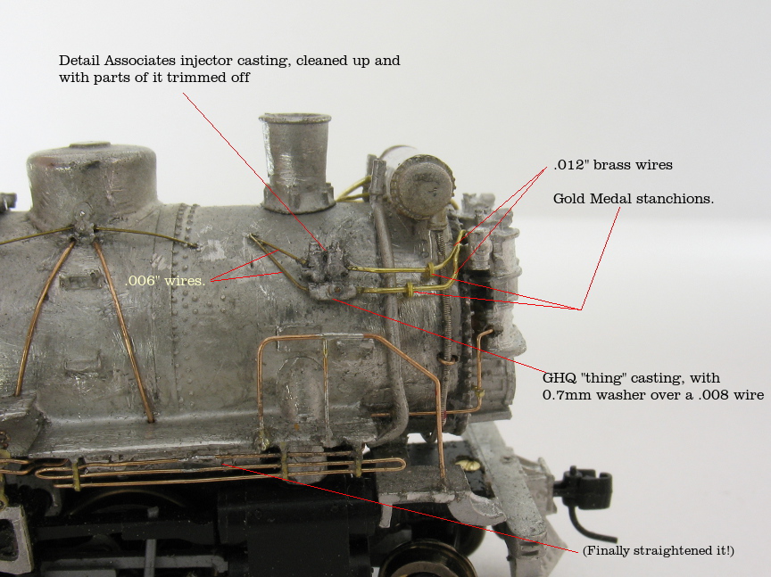

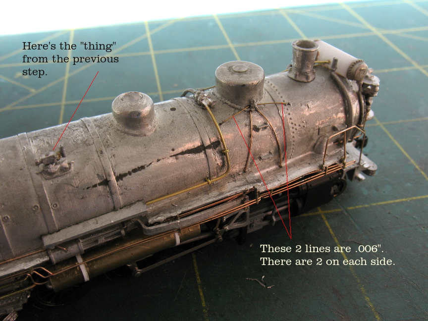

Hi everyone.
Here now, the next installment.  This is a large one with a lot of photos.
In this segment, I cover all the piping on the left and right sides of the engine.
The front/pilot area will come later.
This has been a grueling few weeks.  Quite a few of these pipes took 2 or 3 hours' work to make and install one single pipe.
It is simply a matter of measure, bend, test, rebend, fix, ... and then sometimes, break, cut, throw-out, and make again.
There are simply a ton of pipes on this particular version of a Northern Pacific W-5.  (But I'm mighty excited looking
at it when they are all on there!)

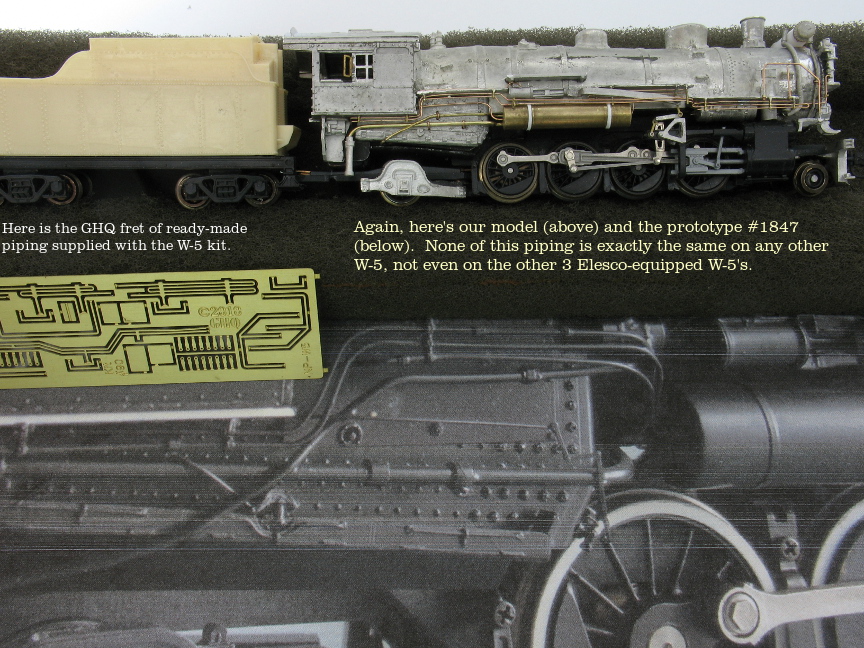

And as always, the cooling line assemblies do come as single units on an etched fret in the W-5 kit.  You do not have to make
your own cooling lines by hand the way I am showing here.
The rest of the piping can be made from various sizes of wire, or omitted as you choose.
« Last Edit: June 30, 2017, 05:22:35 AM by mmagliaro »

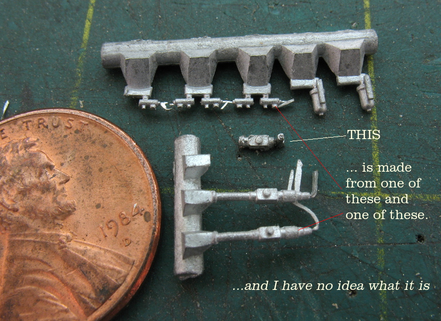

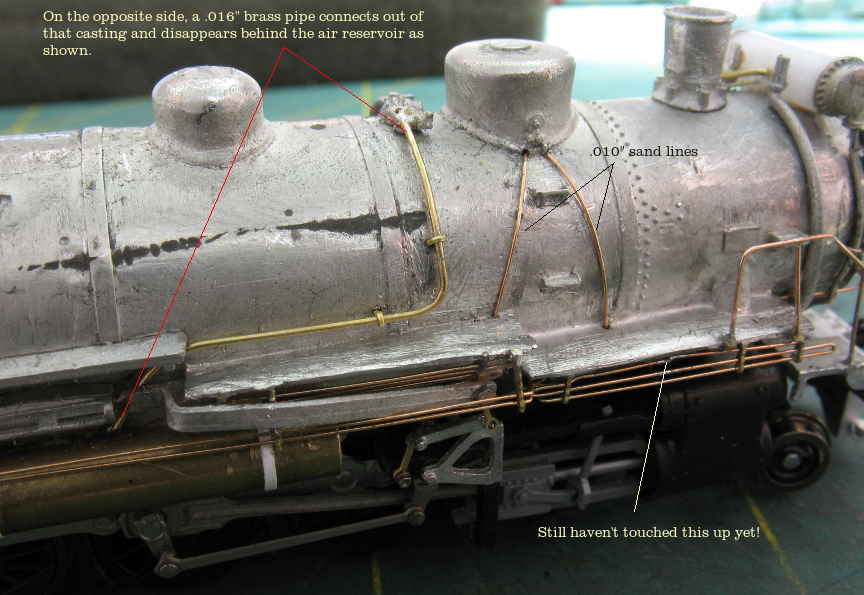

Beautiful   8)
Any ideas what those lines are that come off the sand dome?

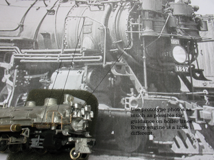

Chris, I have no idea what those little extra raised lines are to the sand dome.   My philosophy is, I study the prototype photos,
and photos of large-scale brass versions of the engine, and if I can see a line, I put it on.  I don't even know what half of the
lines are or exactly where they go.  I am just trying to model what you can see.
Otto:
Those front handrails on the walkways are always going to be trouble.  I broke their joints more than once while working on this, and if I had it to do over, I would wait until the end to do those.  Even when soldering the joints, the fact is that pewter is soft, so a soldered joint isn't as robust as it would be on a brass-to-brass joint.  The pewter can easily bend at the joint, so if you bend it a few times, the pewter fatigues and lets the solder go.  But it is still a lot more durable than glue, or even epoxy.
I will just have to be careful.  Ideally, those front handrails would be Delrin, so they would be super-flexible, and would just bend when leaned on, and would spring right back, without stressing the glue attachments.   But I don't really have any such thing as .008" or .010" inch Delrin "rod".
As for why I choose brass vs phosphor bronze, here's how I decide.
For most piping that is close to the boiler, and especially for heavier lines or lines with a lot of bends, I use brass because
it is easier to bend and form, and have it stay put.  It isn't springy like phosphor bronze, so it doesn't fight you as much.
It is soft.
But for piping that is going to be hanging out in free air more, brass isn't a good choice because if you bump it or squeeze it,
it will bend out of shape and it won't spring back.  Hence, the handrails and the cooling lines are phosphor bronze because they
have to be flexible, yet spring back into position if you handle them or press on them accidentally.  Those tiny lines Chris referred to
at the sand domes are phosphor bronze because they arch up off the boiler a little.
Sometimes I choose purely based on the convenience of the sizes the material comes in.  Those lines that run under the cab through
the hangers, below the firebox, would be better if they were phosphor bronze because they are hanging "out there".  But I could
get sizes I liked better in brass.  They are a little heavier, they do have 3 supports over a short distance, and they are in a spot where I am not likely to wreck them, so even though they are brass, I'm not too worried.
The guitar string pipes are by far the hardest to work with.  They are hard to bend and you have to fight with that wound layer on them, but they have "the look", so I put up with it.   I find that I can touch the ends of them with a Dremel disk and it will fling off the wound layer, leaving just the thin core wire at the tip, which can then be more easily be inserted into a small hole for mounting.
