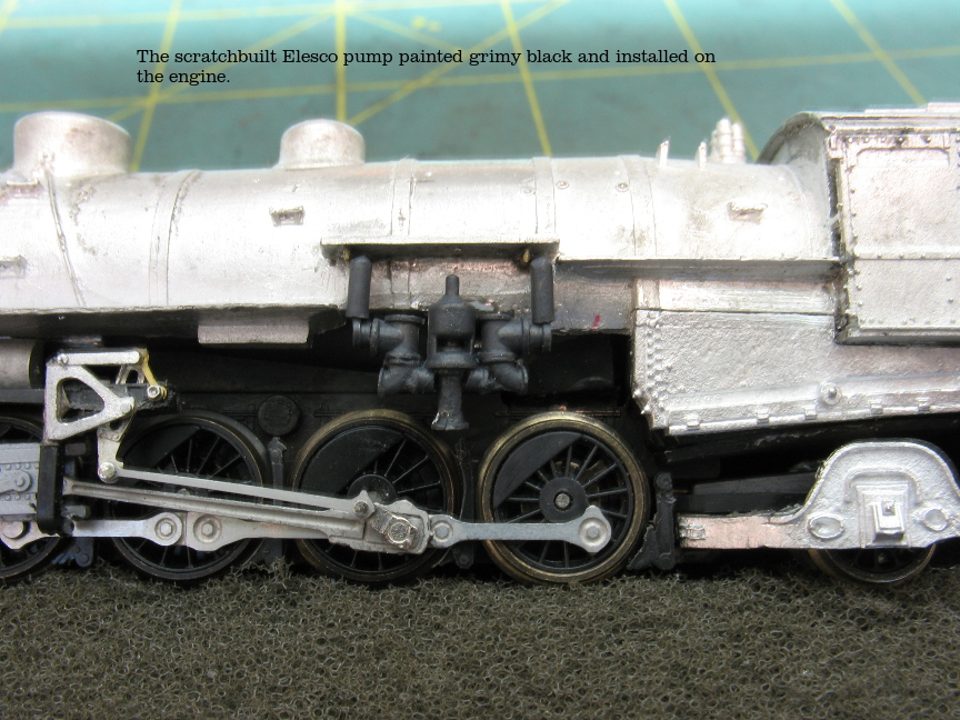

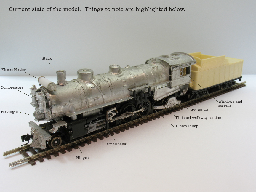

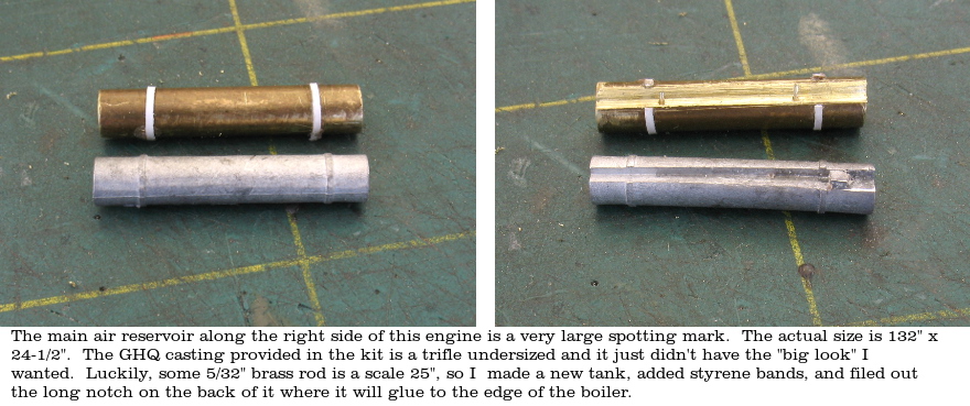

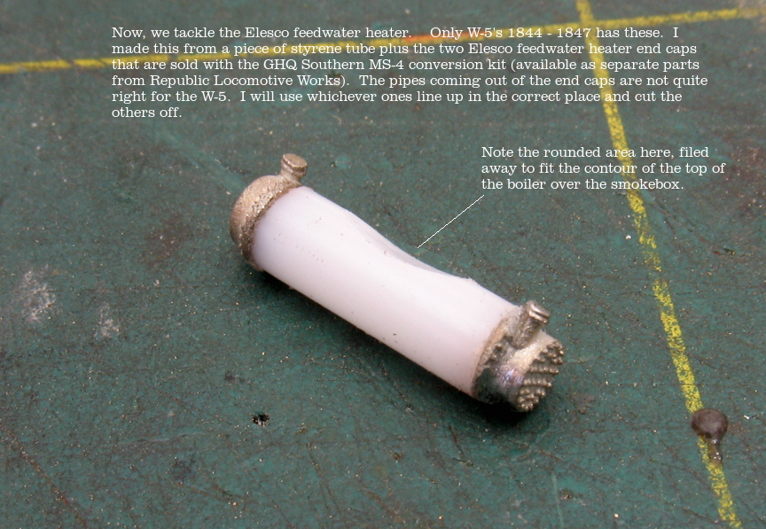

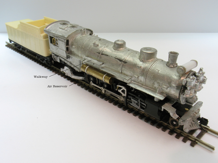

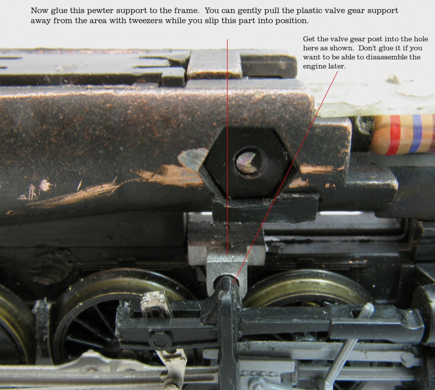

It occurs to me that it might be a good idea to show the engine I am actually building, since I have chosen one.
It's this fellow here.  NP #1847.   Only #1844-1847 had Elesco feedwater heaters (evidenced by the big tank on top of the boiler right at the front of the smokebox, on top, like a big "brow").  I think this gave those 4 engines the most impressive, almost "brutish" look of all the W-5's, so I have chosen this variation.

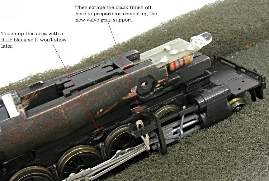

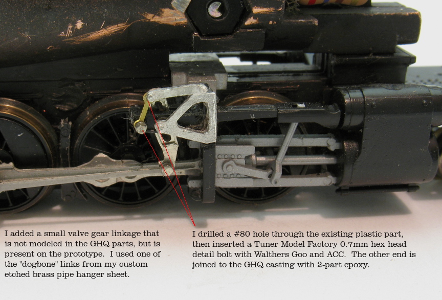

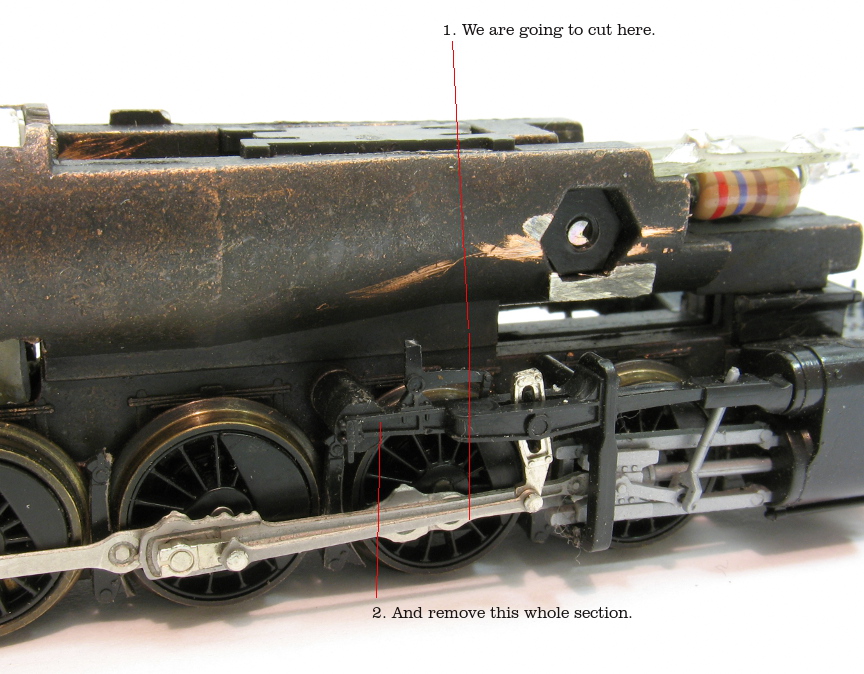

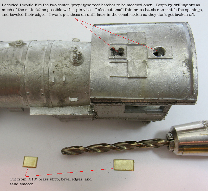

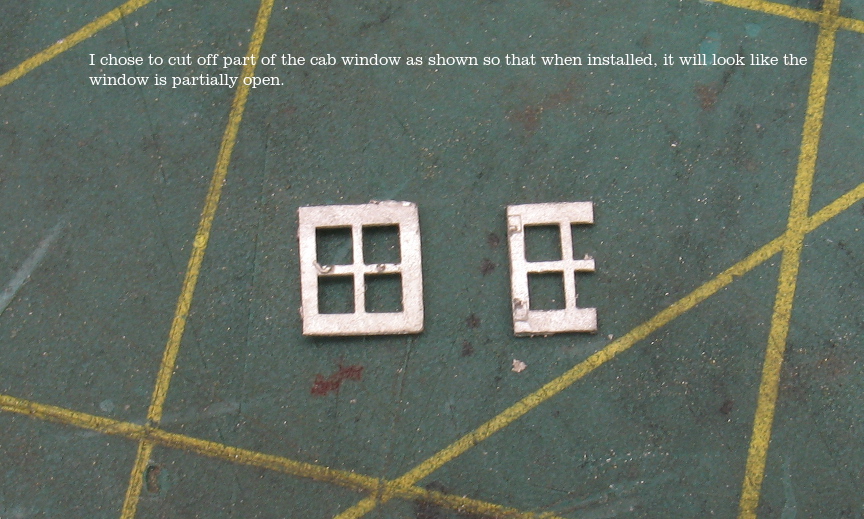

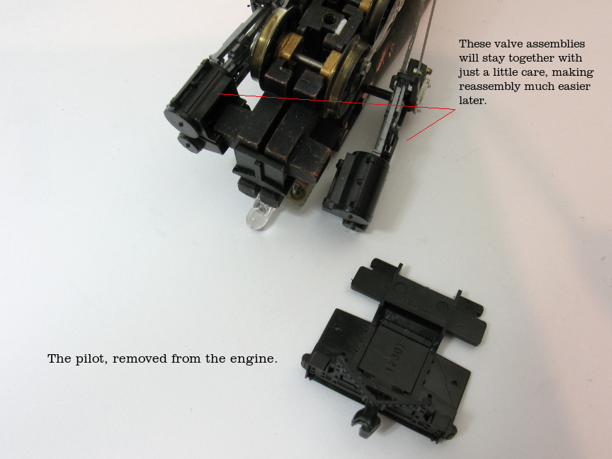

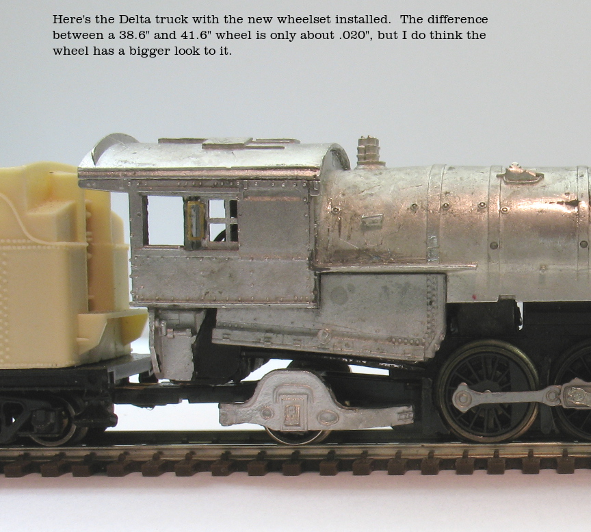

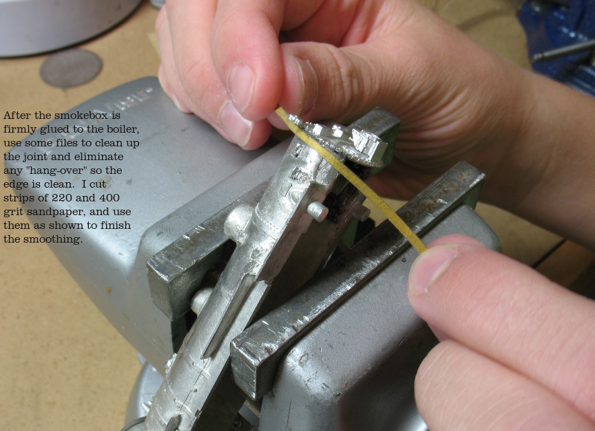

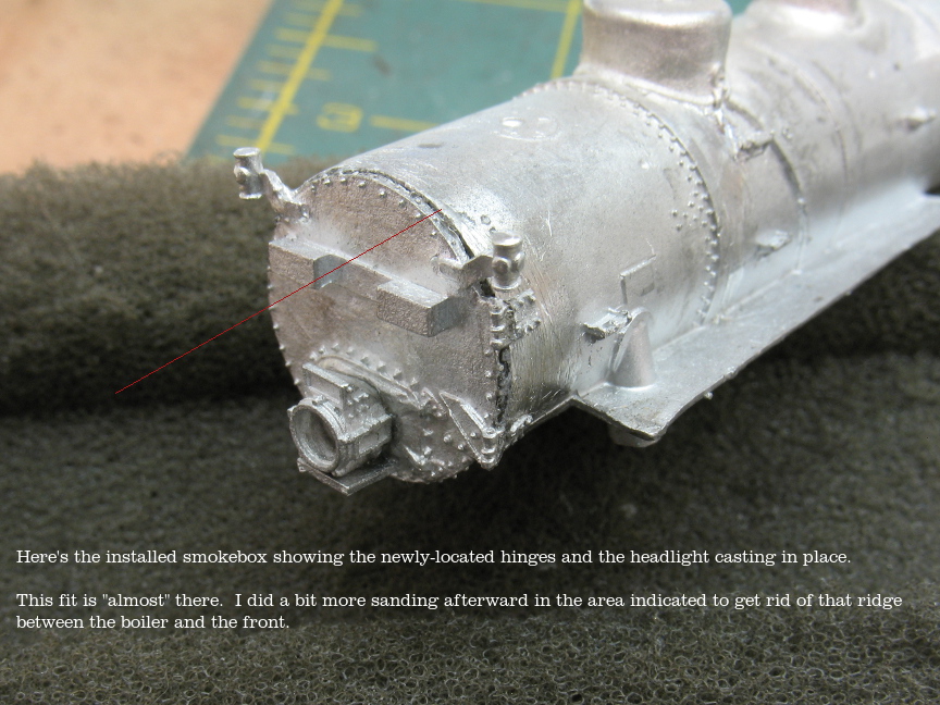

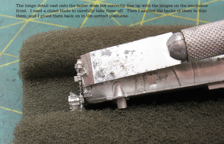

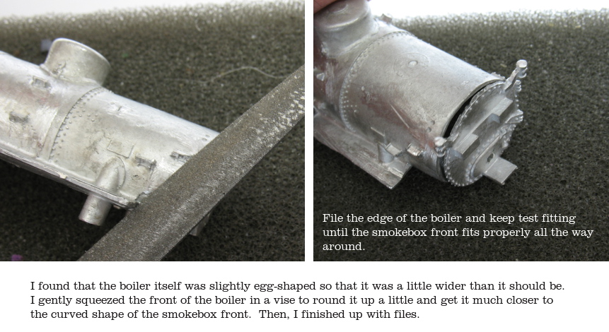

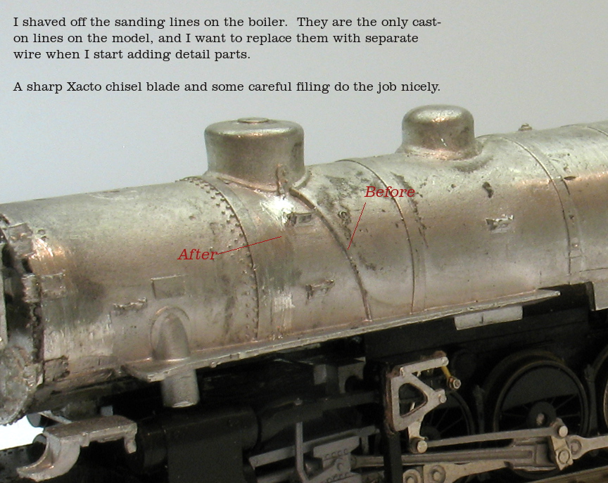

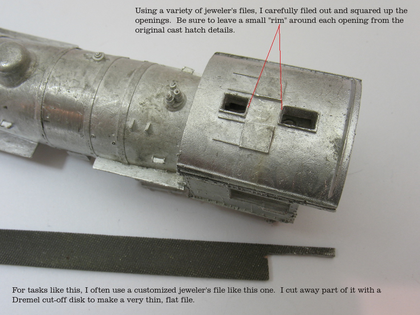

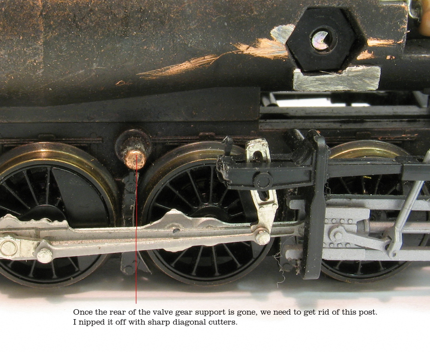

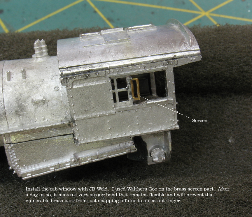

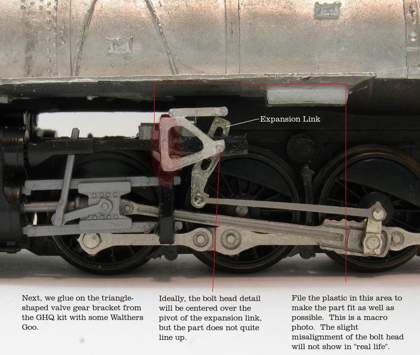

And now, on to the model.  Today, we have the valve gear modifications, and some work on the cab roof.
Now, some work on the cab roof:
« Last Edit: June 30, 2017, 05:19:29 AM by mmagliaro »

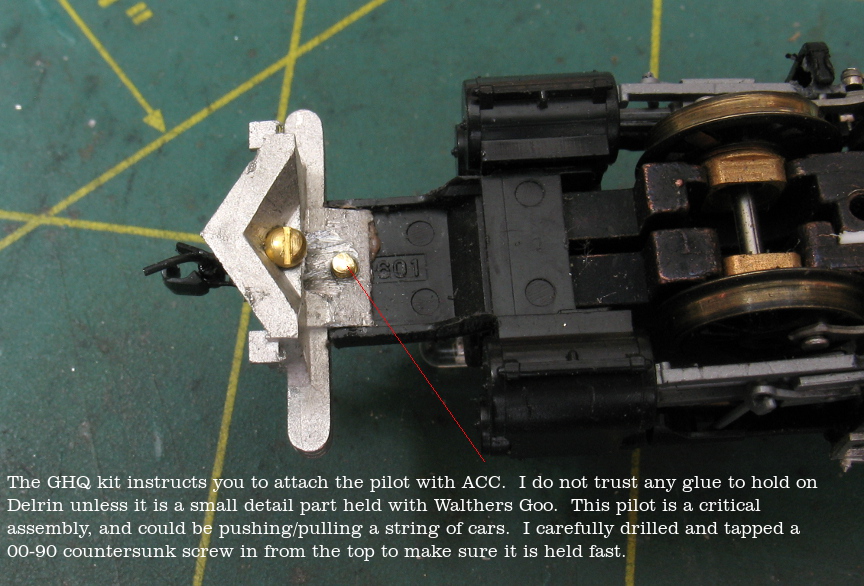

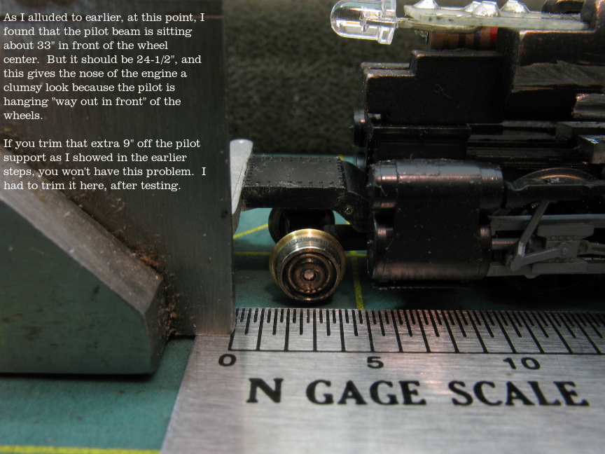

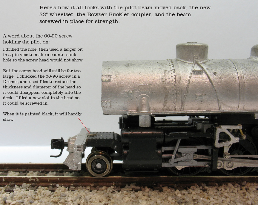

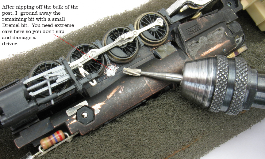

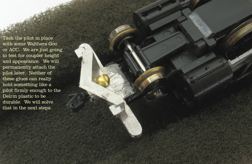

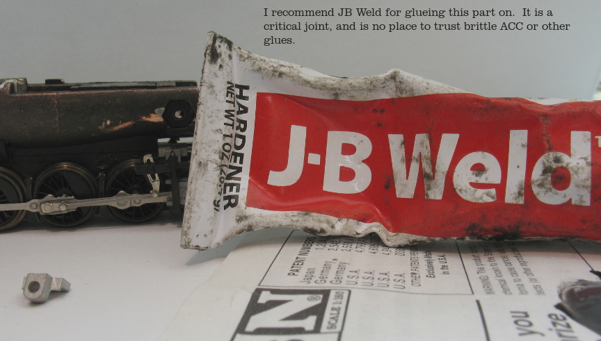

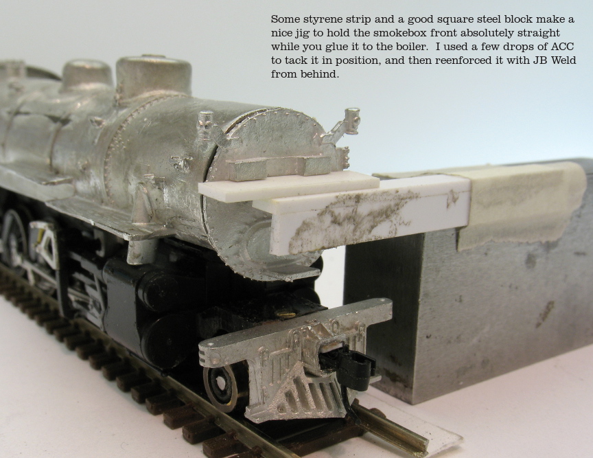

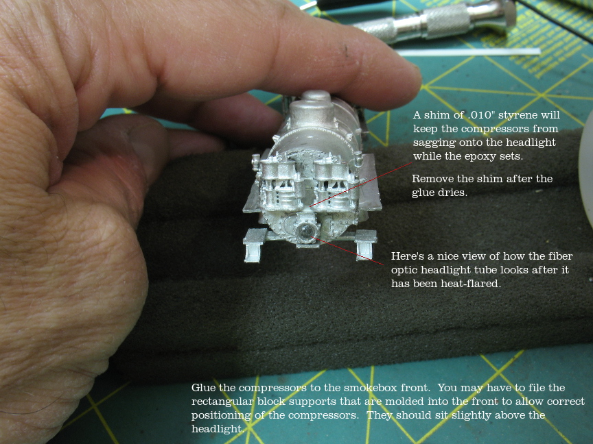

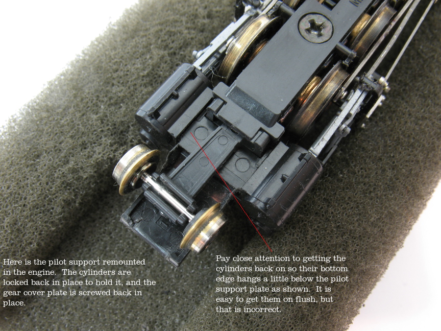

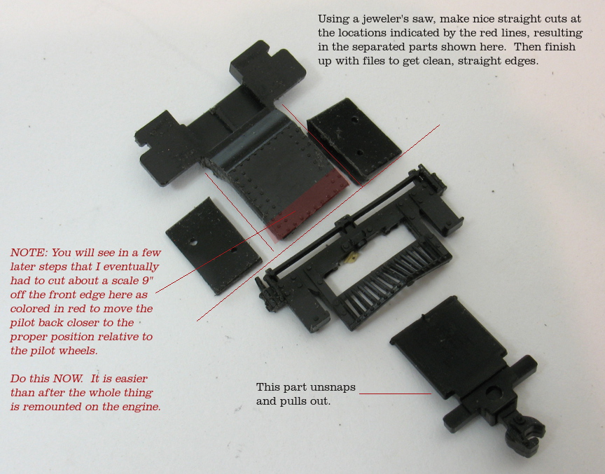

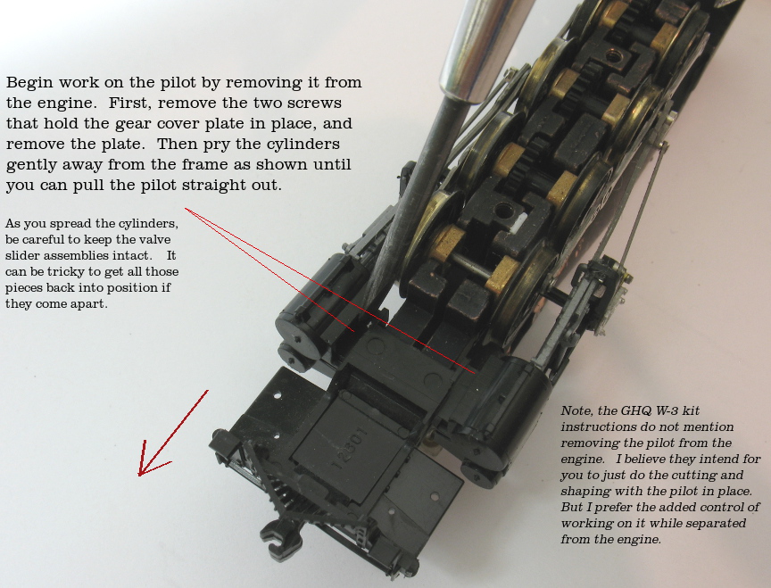

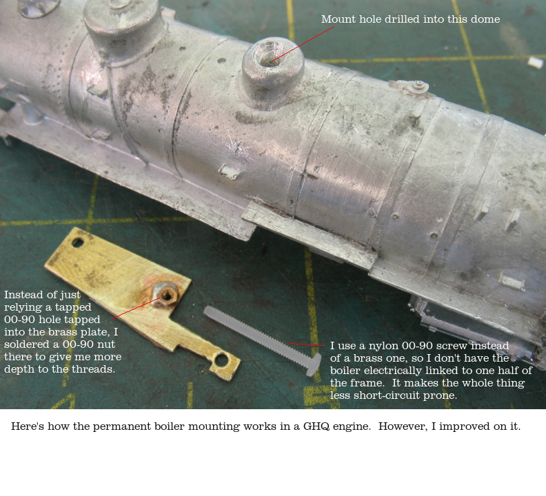

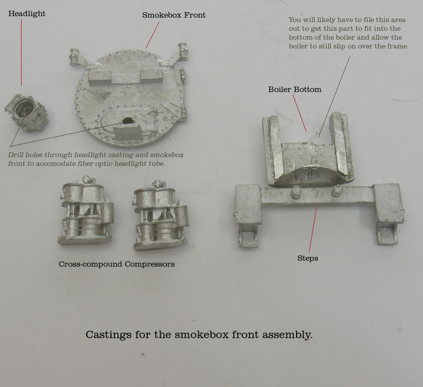

This installment is for the pilot.  I learned a lot about how to do this from my 4-6-2 SP&S engine, so although this was still very tricky work, it went along quite straightforwardly, and I won't have any trouble with pilot wheel interference this time.
« Last Edit: June 30, 2017, 05:20:18 AM by mmagliaro »

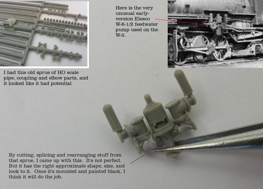

Awesome Max!  love the look of those pumps on the smokebox front- what a nightmare it must have been to get into the smokebox for repairs!

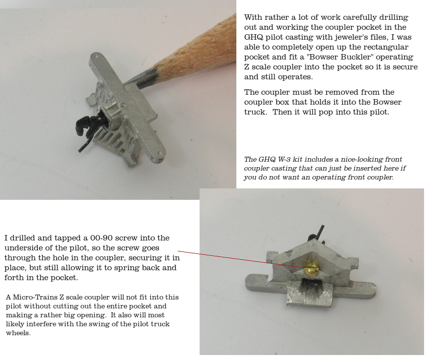

Hello Max,
I love your pictures: I wish you had done this build before I completed my 4 W3s... :-)
For front couplers I have used MT Z-Scale couplers with cut back boxes, but installing them is a PITA.
I have never heard about the "Bowse Buckler": Google search showed them attached to Z-Scale trucks.
Did you buy the trucks and removed the coupler? Or are they available separately somewhere?
I still want to do a few more Mikados (one more W3 and W2 each), and an easier way to working front couplers would be most welcome... :-)
Cheers
Dirk
  • Posts: 6499
Re: Northern Pacific (NP) W-5 Mikado Project

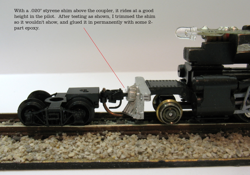

« Reply #52 on: September 06, 2014, 05:15:58 PM »
Dirk, and all,
Part of the reason I am documenting this so carefully is because, well, that's just what I do when I show
an engine build.
But also, Gregg wanted me to show people how the W-5 parts went together so you could use this as a guide in case he makes the parts sets available as a kit.
The GHQ instructions are hard to follow in places.  So a good step-by-step with color photos is important.  I am hoping this will encourage more people to pull those GHQ kits off the shelf and try to build them.
The Bowser Buckler couplers I have were sent to me by a kind forumer.  The only way you can get them that I know of is to buy trucks and cut the coupler boxes off.  I have heard that there are ways to order very large quantities of them
from the fellow at Bowser who created these as a side project, but I have never done that.
For these, I cut off the coupler box, snapped open the box and removed just the coupler part with the whiskers on it.
I stuffed that into the pilot coupler box and "Ta Da!"  It works.
You can get the trucks from a number of web sources like this one:
http://www.zscalemonster.com/full_throttle/100/
« Last Edit: September 06, 2014, 05:17:46 PM by mmagliaro »

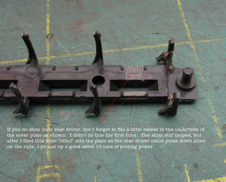

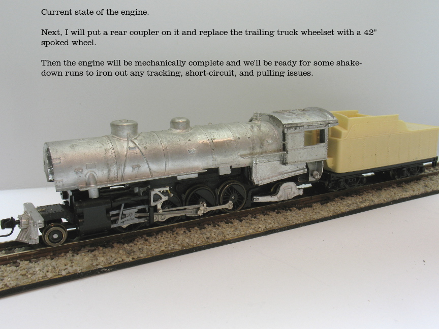

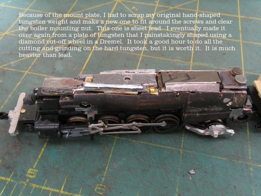

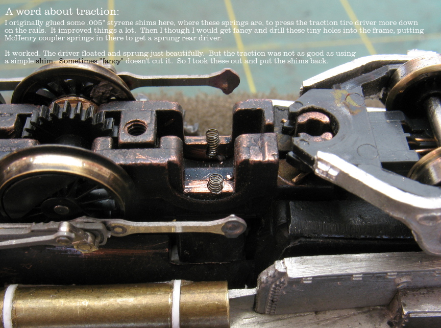

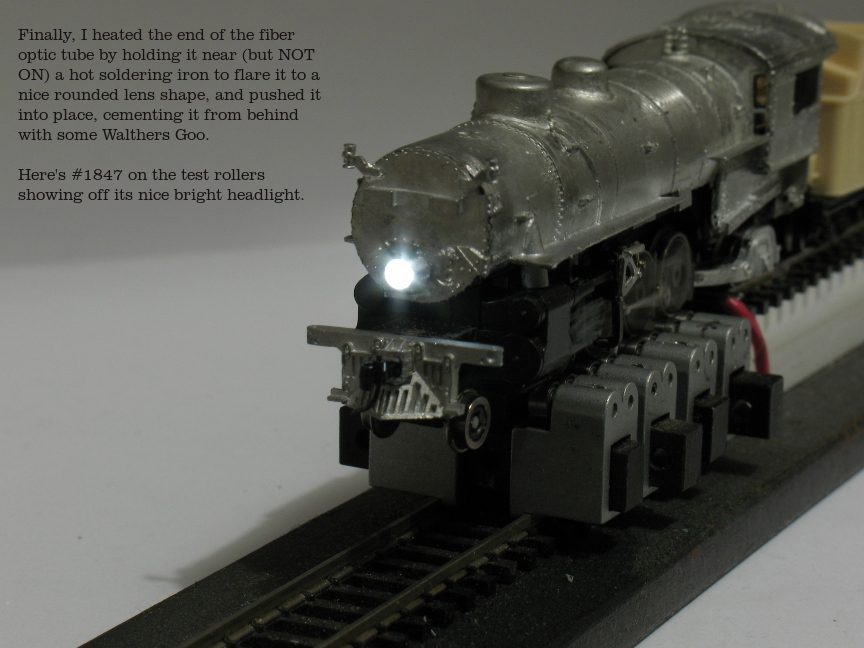

Hi again all.
This installment sees a wide gamut of assembly topics, but the one coherent idea here was to complete any major components that would affect
the weight or tracking of the engine, culminating in a test "shake-down" run (video included).  He video link is all the way at
the bottom of this post.
Here's a YouTube demonstration video showing it pulling
SIXTY FIVE CARS!  YAY!
https://www.youtube.com/watch?v=_isynQ_h8D4
« Last Edit: June 30, 2017, 05:21:15 AM by mmagliaro »
