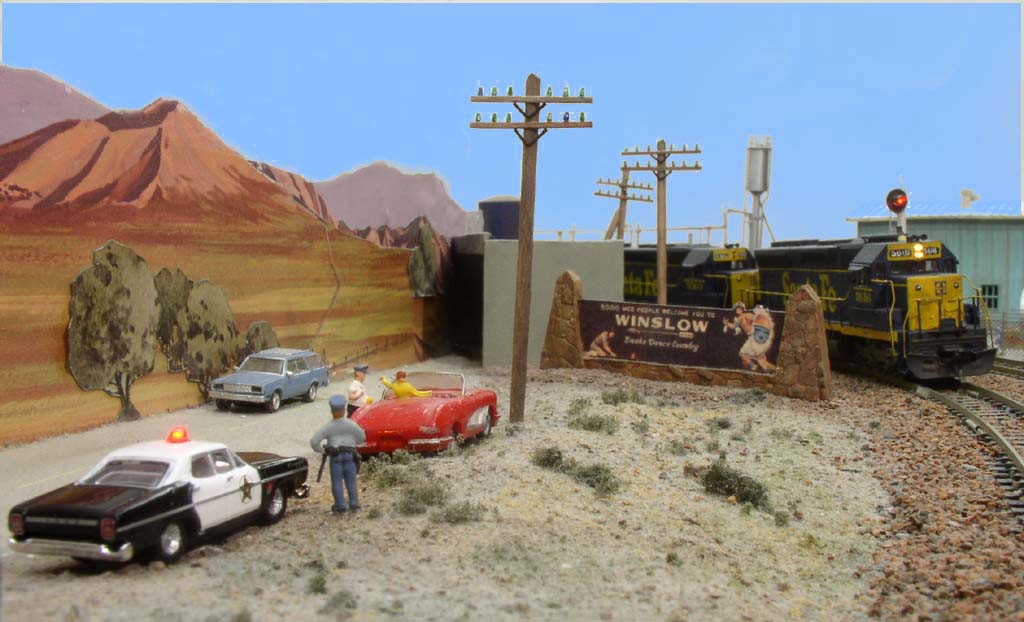

With all of this thought going through my brain, I decided to actually string some .002" stainless wire in some photos I was taking for the cover of Rail Model Journal way back when.  The wire was quite stiff and didn't "droop" like I wanted, and I only strung it between three poles on the Weber Canyon modules I used for the photos for the RMJ article.  I wanted to see if I could see the wire, to see how it looked in quality photos, and whether it was worth stringing on my own modules.
Photo (1) - .002" stainless wire strung on N Scale of Nevada pewter/wood utility poles:
Note that I strung only three lines of the wire because of time constraints and I didn't want to use my entire supply of it.
It's visible only where the light shines on it is the first thing I noticed.  Secondly, the shine was too much, as prototype line is oxidized and dull.  Thirdly, it wasn't smooth, which didn't look very "real" to me.
My verdict at the time was that is wasn't worth the time and effort to do it, and it didn't improve the realism of the N-scale scene.
