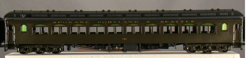

The old Western Railcraft brass kit cars are pretty much it for N scale (if you can even find them) - http://www.spookshow.net/passenger/wrold.html
Slicing and dicing the Athearn cars is probably the most common solution -
Cheers,
-Mark
Mark,
Who made that car in your photo?  That is really nice!
Unfortunately, even the Athearn cars do not have curved arched windows like the photo I showed.
And there only appears to be one Western Railcraft car that has a row of windows, which, although arched, are narrow and very different.   I was hoping for something a little closer to the prototype I showed.
It doesn't have to be perfect, but wide arched windows, the roof, and a heavyweight are what I'm
looking for.  As I suspected, the short answer is, "No, there ain't nothing like that" in N.
