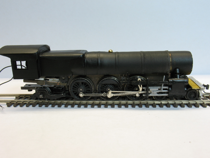

« Reply #81 on: July 25, 2013, 03:36:18 AM »

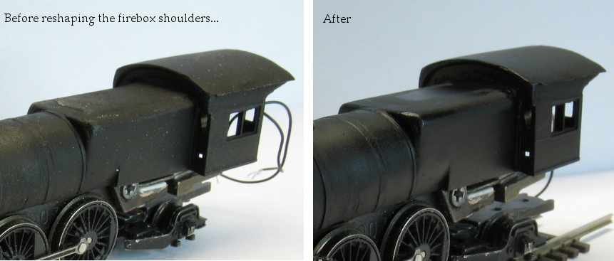

Thank you to everyone, for being helpful, supportive, and just plain kind.   You make this so much more fun.

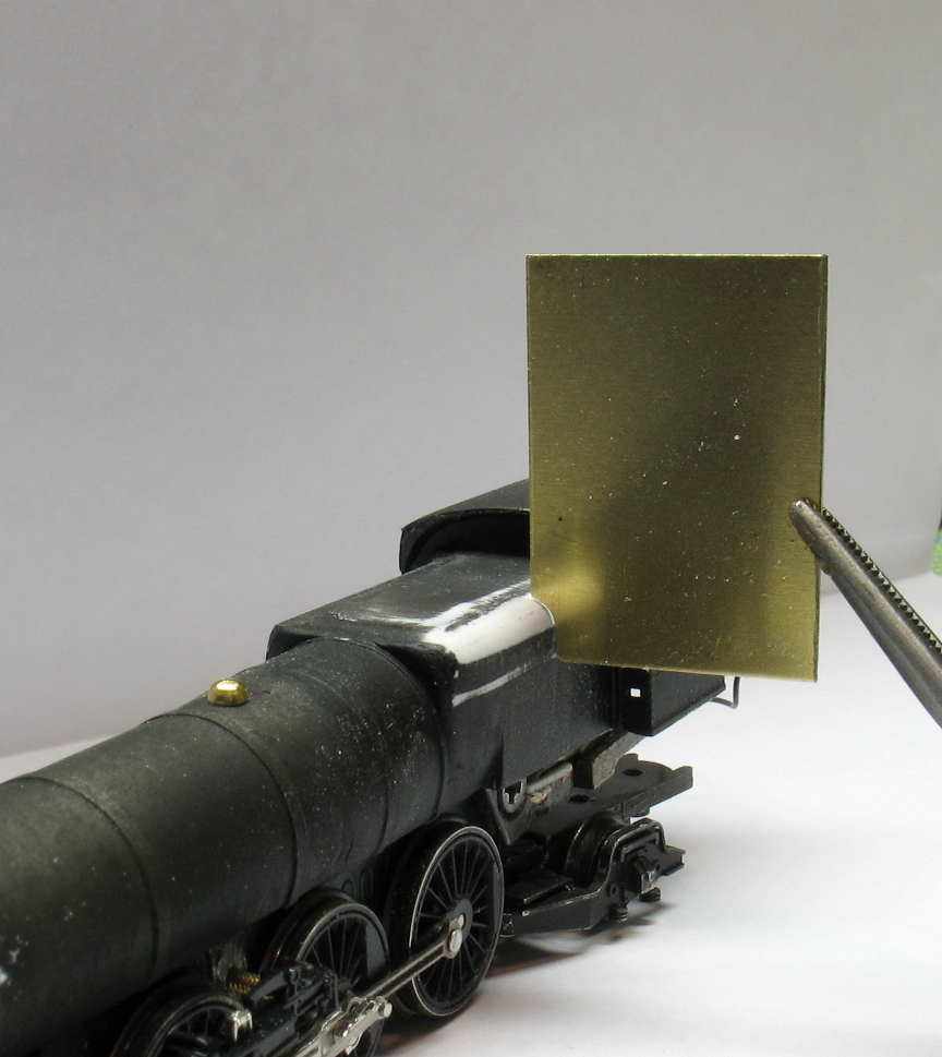

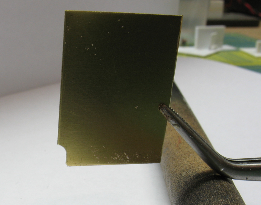

I refined the firebox shape.   I started by making a scraping tool from a square of thin brass.  I just used a Dremel with a round grinder bit to cut out a rounded shape in one corner.  Then I refined the curve with a round jewelers file and
fine sandpaper.  I used that to scrape the firebox shoulders.  How do I know I have the right contour?  I don't.
But the fact that the curvature of the firebox corners is more pronounced, and is the same on both sides (because I scraped both sides with the same tool!), is good enough for me.
I think it's a big improvement.
The photos tell the rest of the story.

I agree that the firebox now looks like it was professionally injection-molded!  8)

The Belpaire firebox is a really big spotting feature of these engines, as it was on all my PRR engines.
When you look at an engine that has one, I think that is one of the places your eye is naturally drawn
to because it looks so unusual.   Plus, this taught me a new technique.  I fretted over just how to round
over those shoulders.  In the past, I had used a strip of sandpaper, run back and forth over the corner.  It worked,
but on this one, I just could not get it to come out very nicely.
The scraper is really an ancient woodworking tool.  All things old are new again.
And now, I can keep that little brass tool and use it on other projects!

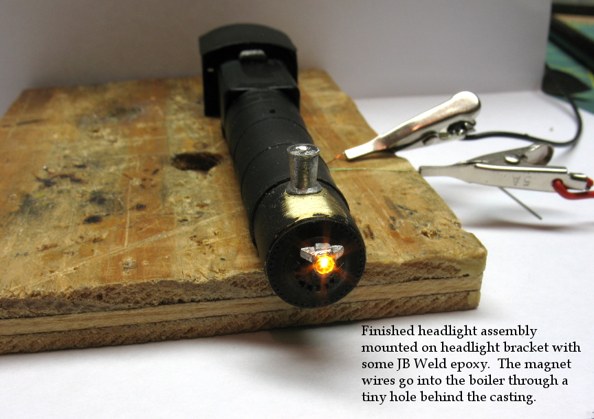

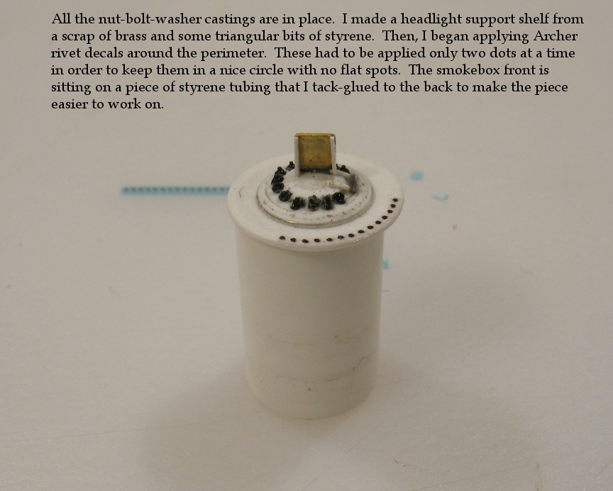

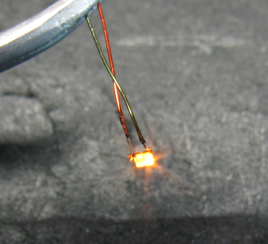

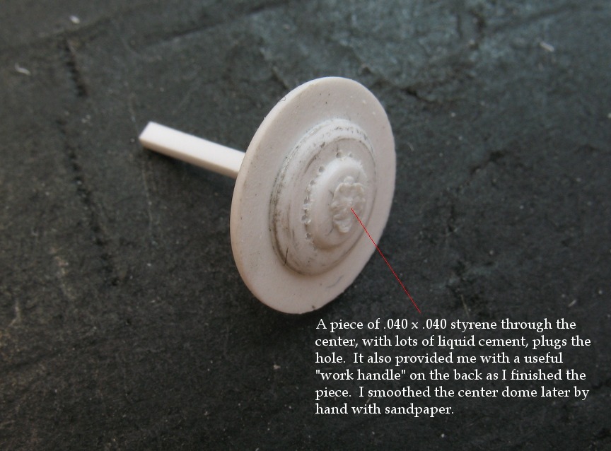

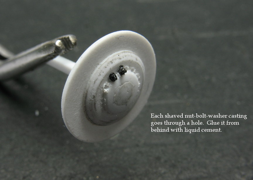

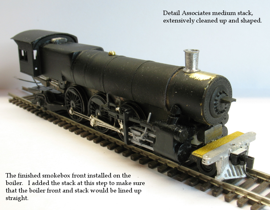

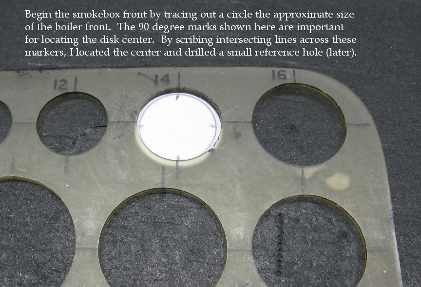

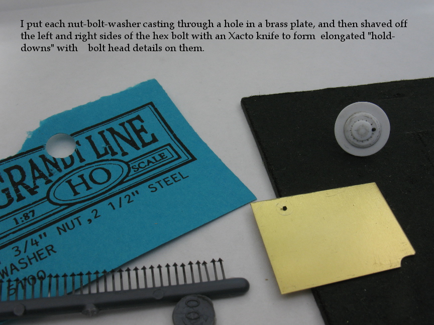

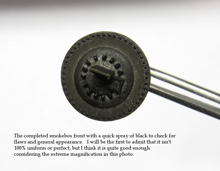

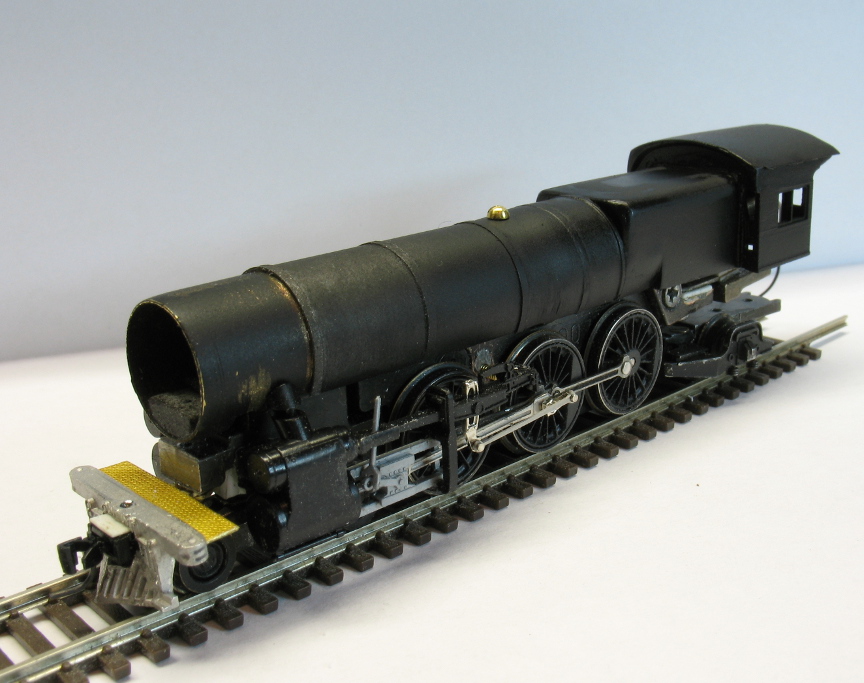

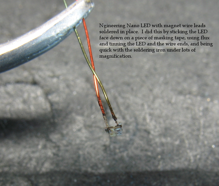

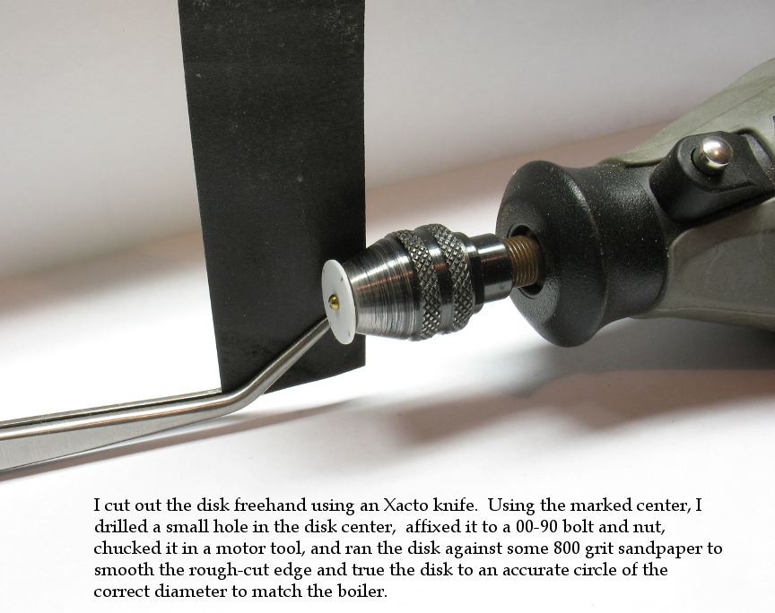

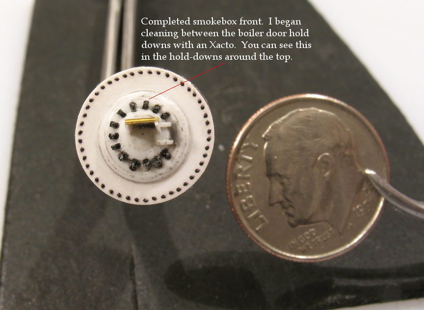

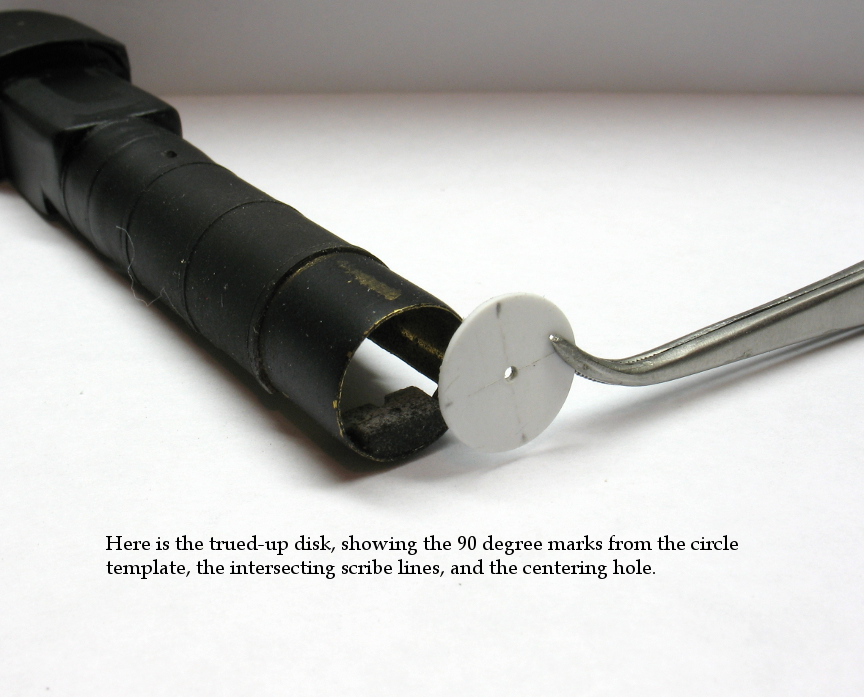

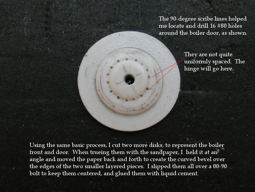

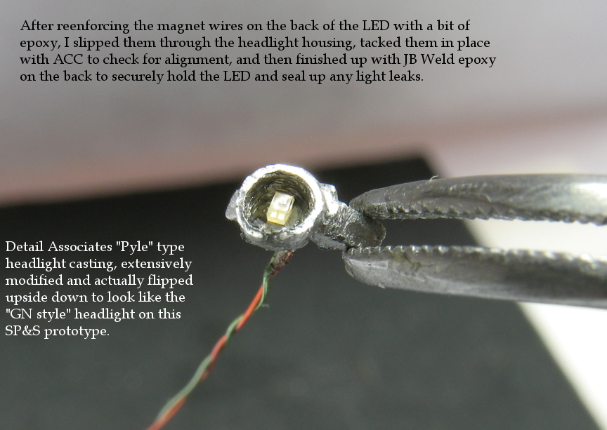

Forward, on to the smokebox front.  This was a project just in itself!  I have never tried scratchbuilding one of these.  I usually just slice one off some other shell that is close.  But not finding anything quite right, I decided to give it a go.  I guess I just like making things the old-fashioned way, by hand.   I also got the SMD headlight started and a stack and turret cover on.
« Last Edit: June 30, 2017, 01:24:49 PM by mmagliaro »

Max,
That headlight alone is worth the price of admission to this thread.   8)
