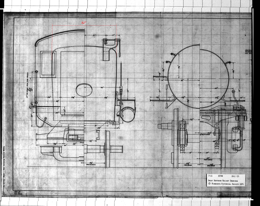

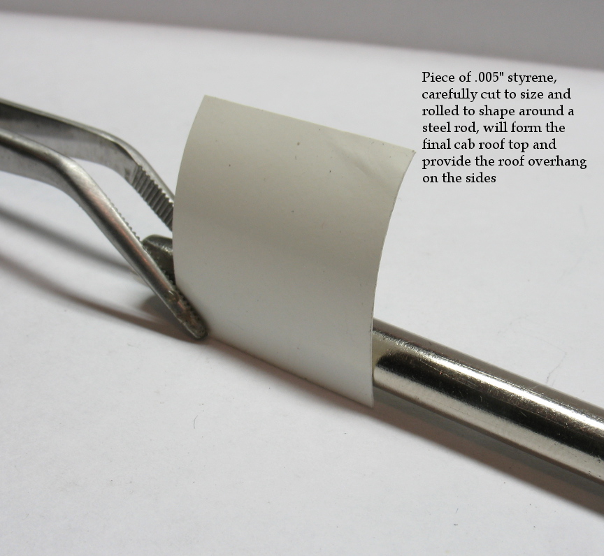

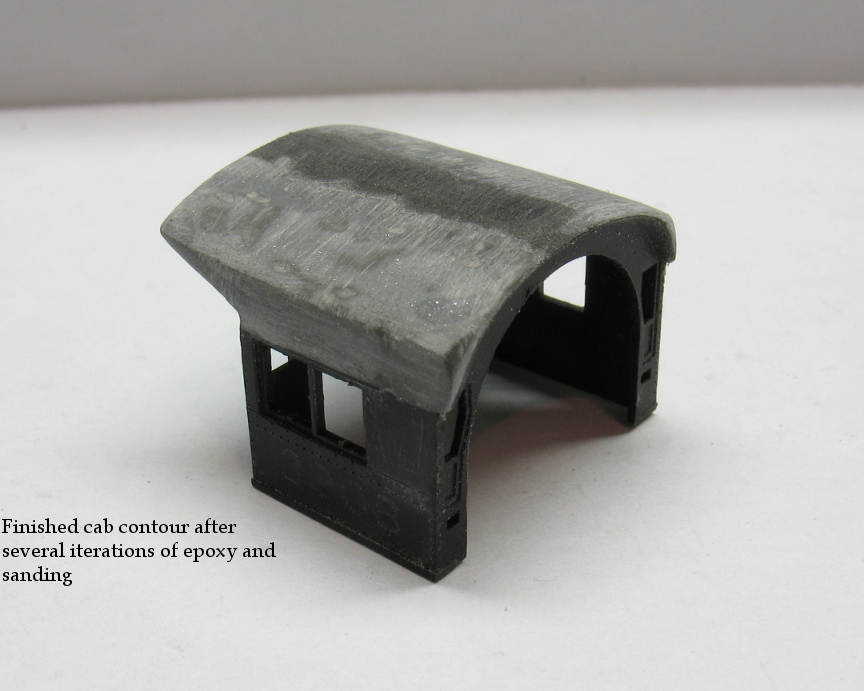

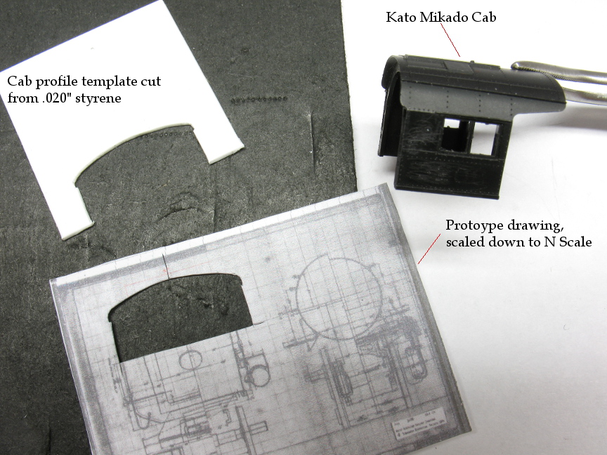

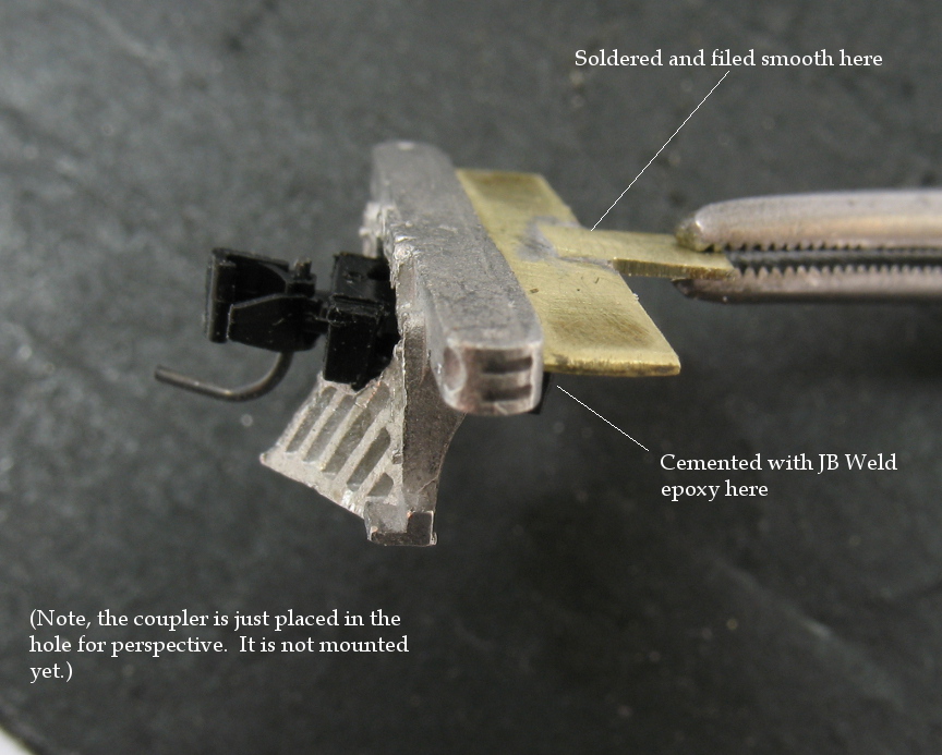

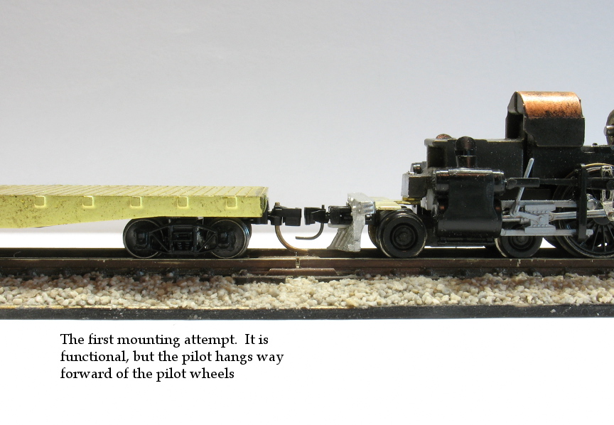

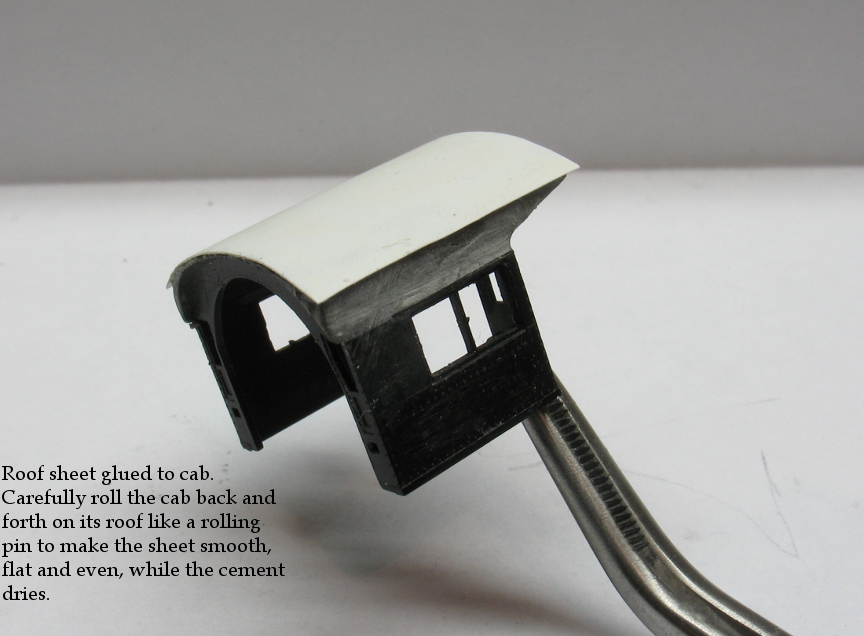

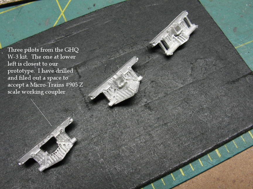

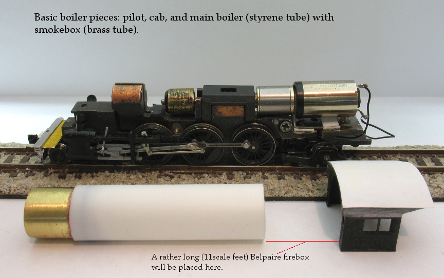

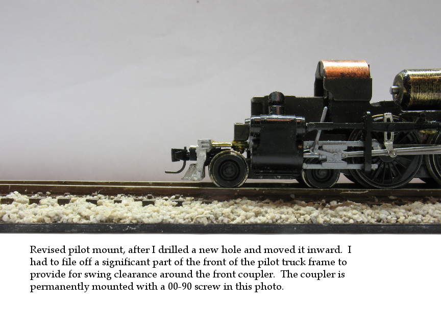

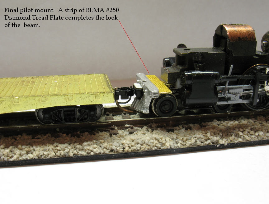

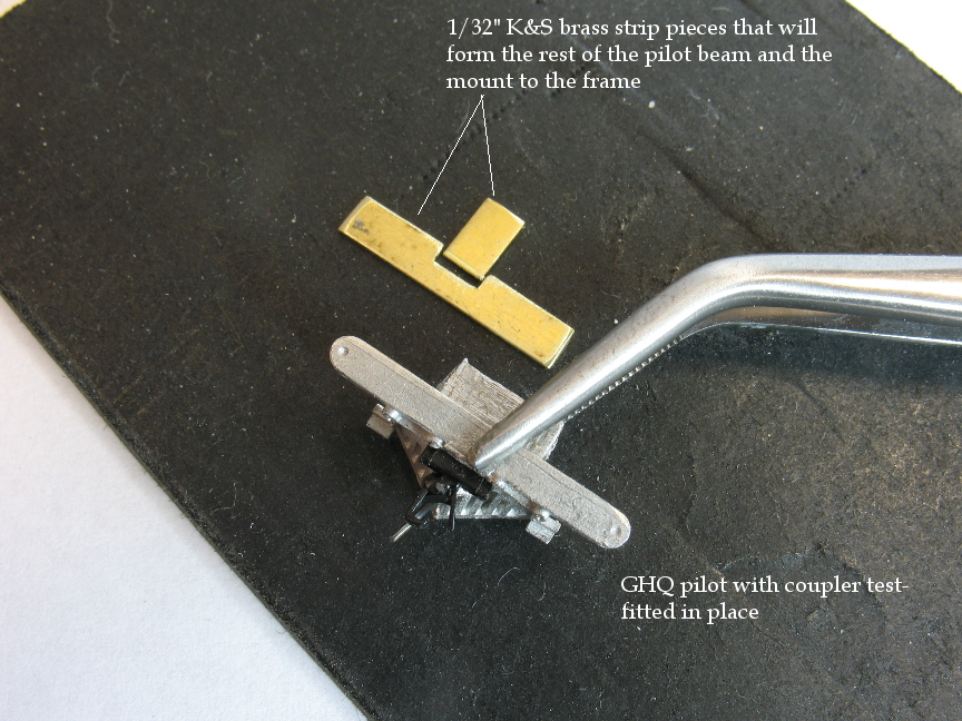

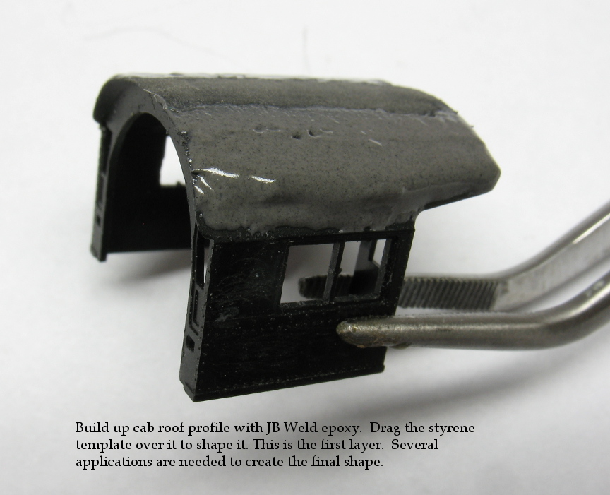

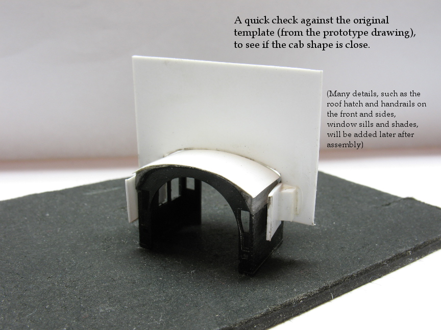

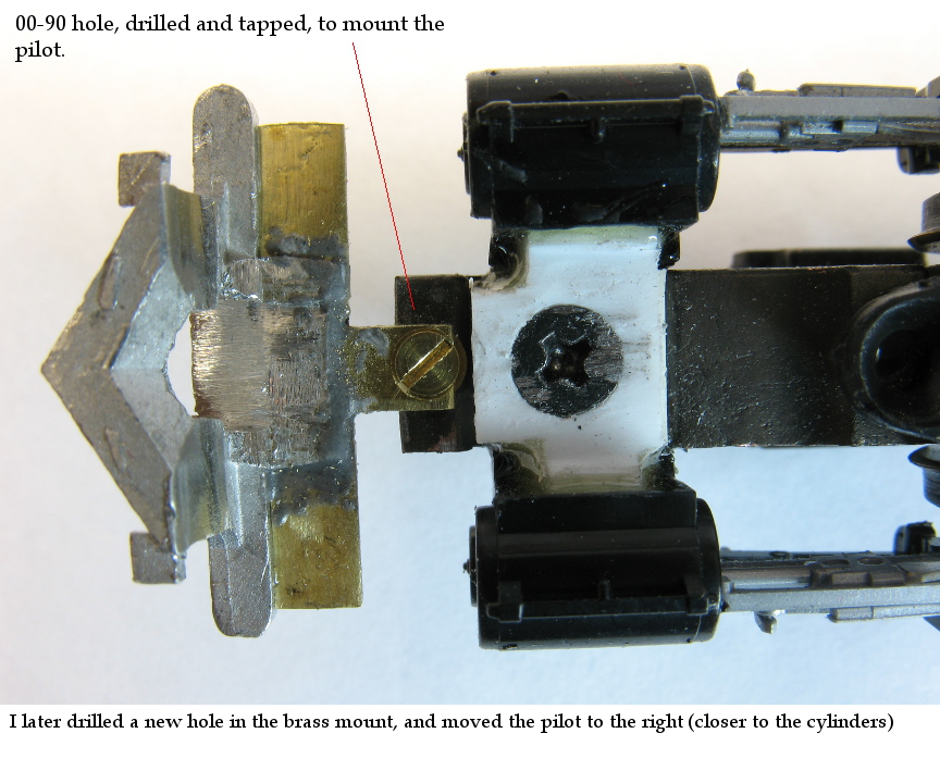

This installment continues with work on the cab and pilot.
I am using the cab from a Kato Mikado.  After comparing prototype photos and drawings to all the cabs I had, the Mikado cab turned out to be very close in size and window placement.  The only real discrepancy was the contour of the roof.  I made a template from a prototype drawing and used it to "sculpt" a new roof shape using JB Weld.
The next series of photos shows construction of the pilot.  Although even a Z scale coupler is quite oversized in N, I wanted to give this model a working front coupler, so I adjusted and mounted the pilot to accomodate a Micro-Trains #905.
Most of the basic pieces are in place for the boiler shell now.  The next big task will be grinding/reaming
the frame and cutting out a cavity along the underside of the boiler tube, to fit the whole thing onto the
chassis.
