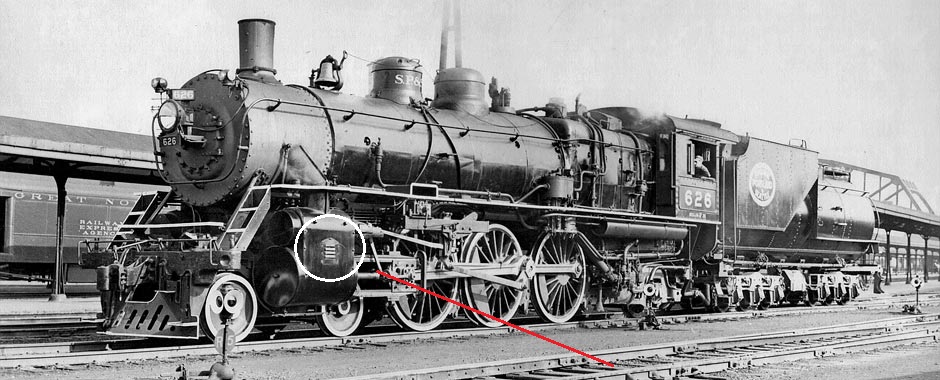

Thank you, guys.  I have enjoyed this project tremendously.  You better believe it is a source of great joy to watch this thing run on my layout.
Peteski:  Not to worry.  I am keenly aware of the fact that the pin striping on the pilot wheels is too wide.  I knew when I was doing it, but I do not have a good way to reshape those wheel faces to make a thinner, flat, "rim" to paint.
I considered a fox valley wheelset, but they have a very sharp "edge" there, and I doubt I could paint
a neat, flat line on that.  I might be able to flat-file the outside of a FV wheelset to make that rim edge into a small flat surface.
Wazzou:
That louver... Ha!   Yes, I did notice those, but I never realized what they are.  What are they for?
You are referring, I presume, to this (in the photo below, circled).
I thought about that as the project has gone on, but I haven't thought of a way to make that sort-of "house-shaped"
thing.      I wonder if BLMA makes some sort of diesel louver that would work.

  • Posts: 6500
Re: SP&S 4-6-2 #626 Project
« Reply #216 on: December 13, 2013, 03:33:20 PM »
The GMM GP-18 detailing etch has a bunch of louvers.
Those are very similar to the BLMA ones.
I need to make a 5-sided plain blank panel.  I think if I make that out of .005" styrene, and put an etched metal
square louver part in the center of it, it should look about right.
Mike C
« Reply #217 on: December 13, 2013, 04:58:54 PM »
Top shelf Max.
I would like to see it with that louver added to the cylinder jacketing if you can.
Really great craftsmanship.
  Its not just a louver. The N & W # 578 has these also. They are axcess panels that slide upwards on tracks . The tracks are just u shaped guides on the chest. Don't know what they are for, but I have seen them on other locos.......Mike

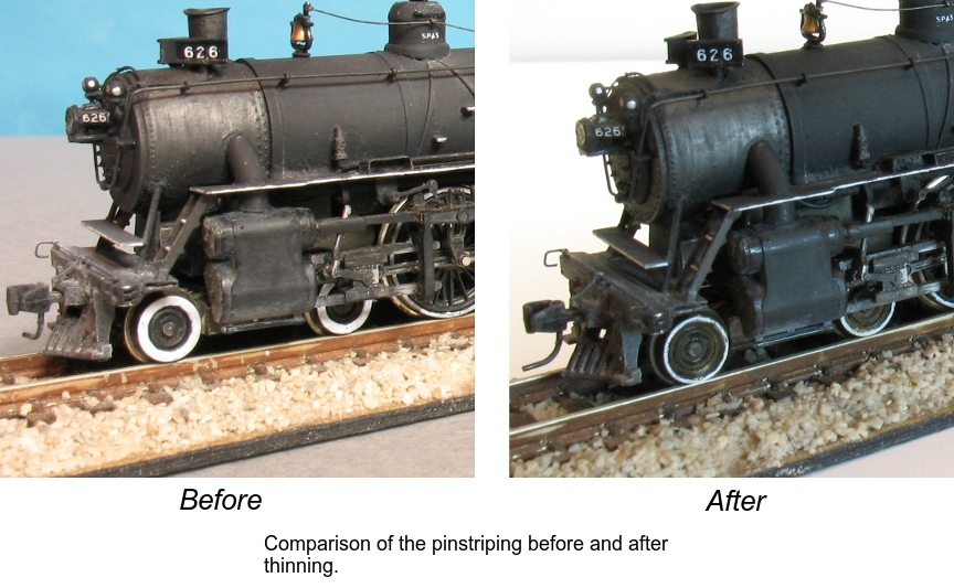

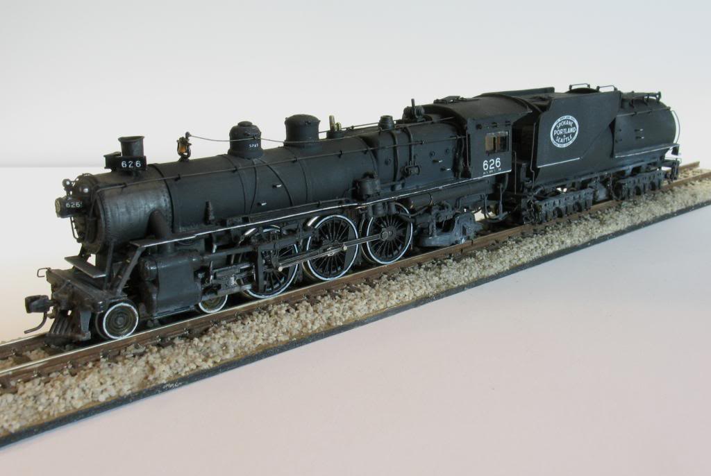

  • Posts: 6500
« Reply #221 on: December 14, 2013, 02:24:36 AM »
Guys... THANK YOU!   :)
Richie, I will be building more engines in the future, but right now I am going to REST and PLAY with my layout,
maybe get some more ground cover and ballasting done, build a few structures,..
My distant future "pencil in" list is an NP W-5 (from the GHQ W-3 kit with some mods),
an SP&S late 1800s 4-4-0 using the Atlas 4-4-0 (doesn't fit my era at all... it's just something I want to build),
an SP&S 2-8-0 (the SP&S version of the NP F-1) using the Athearn 2-8-0, and beyond that,
I have no idea.
Now, to the improvement I'm posting about...

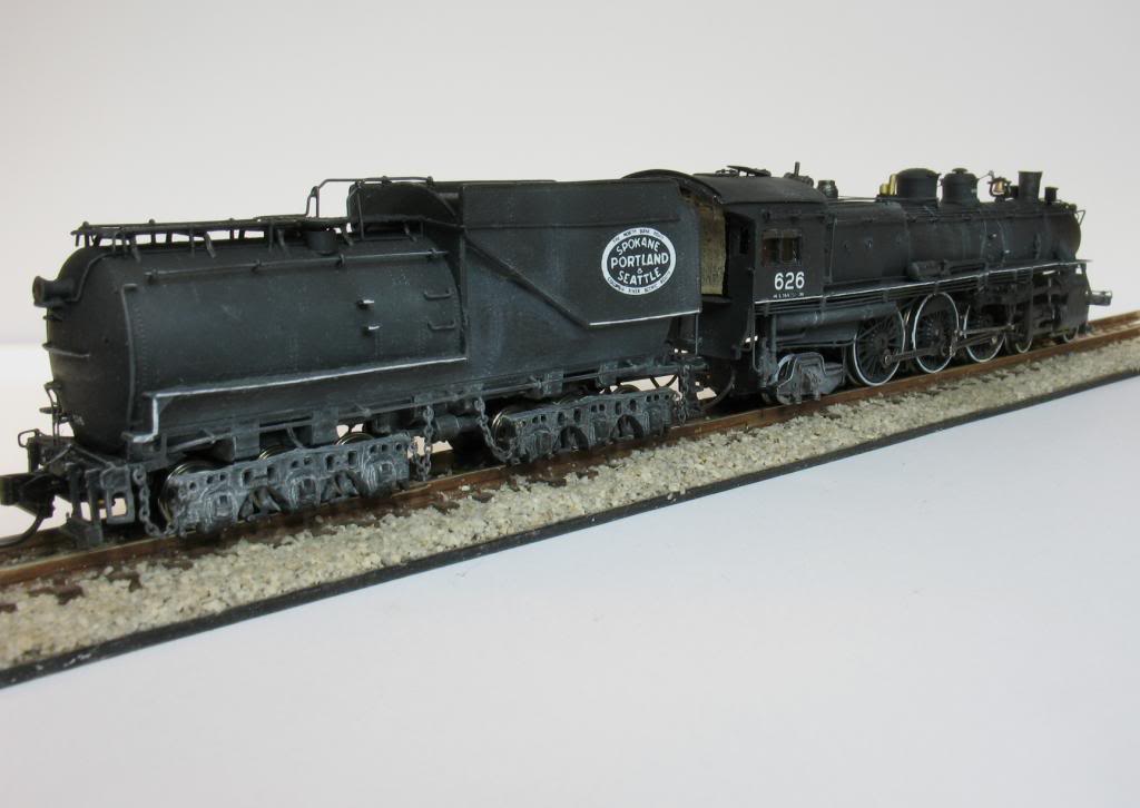

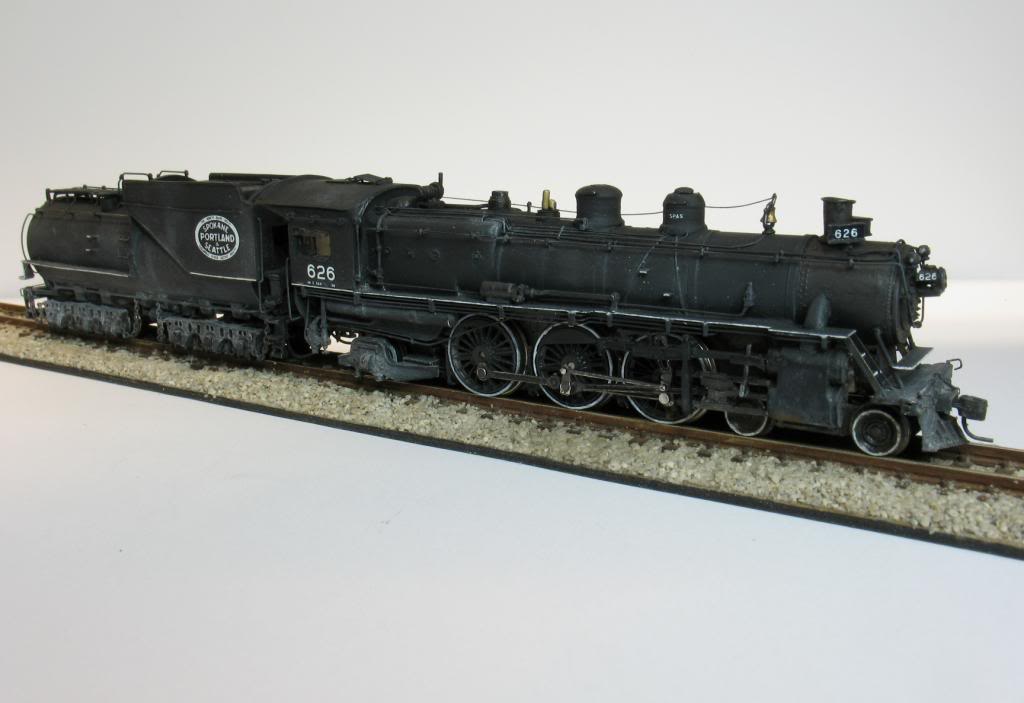

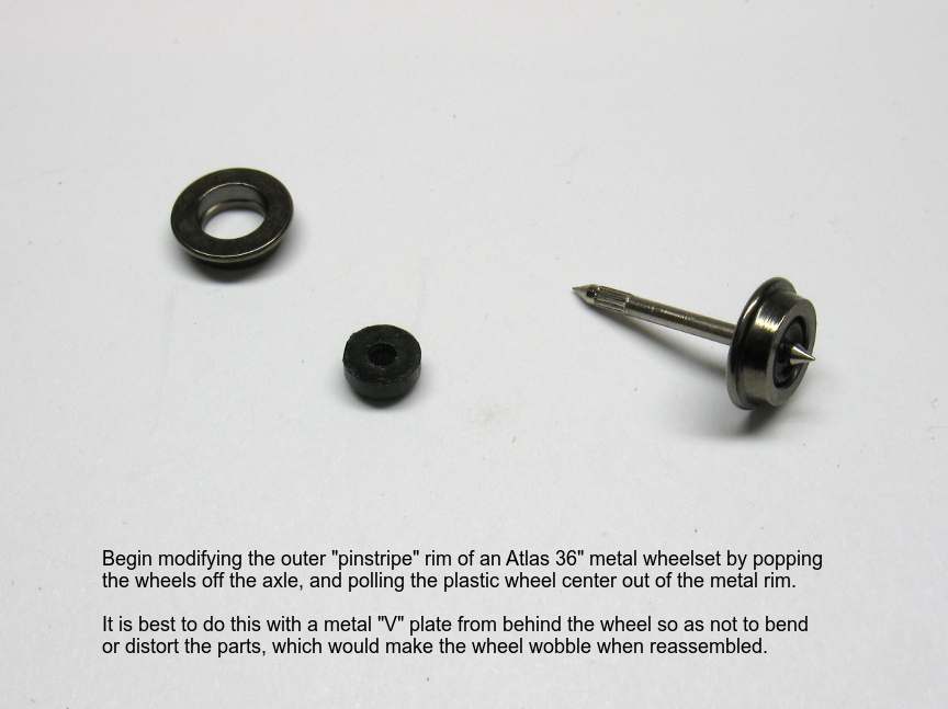

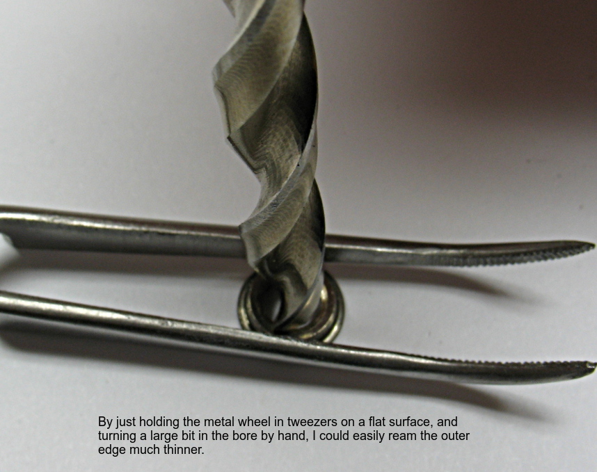

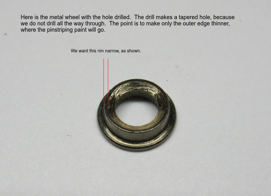

After some consideration, I decided that the pilot wheel pinstriping is the most important of all your suggested improvements.   That louvered door would be nice, but the pinstripes, I think, jump out as "too wide" to any observer whether they know the prototype engine for reference or not.
The PS-1 wheels won't work, as those are 33".  These pilot wheels are 36"  After looking at every type of wheelset I have, I decided none would really do, but I hit upon a way to alter the face of the metal Atlas 36" metal wheels that I used.  So here's a few photos.
In the end, I actually like the engine shots on a plain white background after all.
When I saw this, it really became apparent how important a fix this was:

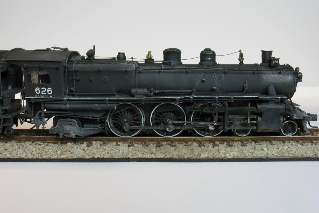

Here's a few engine shots with the wheel fix in place.  I like these better than the first group I had.

  • Posts: 35376
  • Respect: +6678
« Reply #224 on: December 14, 2013, 04:25:24 AM »
There is nothing else that I can point out anymore...  That's no fun!  :(
But seriously Max, you've just made my night!  Awesomeness!
Such a small detail and it made such a huge difference!  I don't know how you managed to use just tweeters to hold the wheel while using a drill on it, but it worked!
