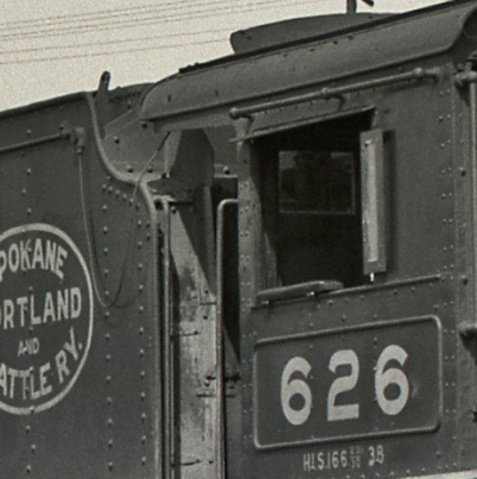

Jason's "guess" that's a mirror on the side of the cab isn't correct.  It's a windscreen and is clear glass with a metal frame around it.  I just got finished last week doing some research on Union Pacific's windscreens on their steam power, and it's different than on diesels, both to design and to function.
To confirm that SP&S did virtually the same as UP, I just finished a small Google search of the SP&S 700 looking for closeups of the cab and the window arrangement, and fortuitously, I got some historic photos of other SP&S steamers as a bonus.
The windows on SP&S and UP engines slid in tracks on the inside of the cab, and when fully closed (pulled back), there was a weather-seal on the front edges of them that would press against mating surfaces on the cab wall or the outside window to form a nice, tight seal.  On larger steam, sometimes the cab was big enough to allow a third sliding window to slide from the rear of the cab, and to nest in its "notch" when fully open in the space between the window opening and the rear wall of the cab.
The function of this sliding window arrangement was for the comfort and safety of the crew, giving them a lot of options as to how to ventilate the cab and/or to keep it cool or warm depending on temperature, weather conditions, speed of the train, tunnels or direction and velocity of the howling wind outside.
Since both the fireman and the engineer were always leaning out of the cab to see what was happening on their track and to watch for signal conditions, the windscreens were not attached to the side of the cab like a diesel's are.  For the UP, SP and SP&S (the only three roads I've done research on) they were attached to the rear edge of the outermost sliding window.  SP&S & SP's windscreens usually had a metal frame, whereas UP's (at least on Big Boys, Challengers and FEF's) didn't have a frame going all the way around.  They also appear to have a hinge (top and bottom) that would allow angle adjustment, as sliding the outside window forward or backwards gave fore & aft adjustment.
When the windows were all slid OPEN (like in your reference photo), the windscreen appears at the front edge of the window opening.  When the outermost window is fully closed (slid back), the windscreen is on the back edge of it, either halfway or one third of the way back in relation to the window opening depending on whether there were two or three sliding windows per cab side.
I agree with Jason that a good possibility for the windscreen would be to use BLMA's parts if they consist of a fine frame, and not a flat "mirror" of SS.  Attach them to the rear frame of the outermost sliding window frame in whatever position you elect to model it.
It would definitely add a little more of that "lived-in" look to your fabulous model!

Here's a super-closeup reference photo of that cab window on #626.
Bob, I really appreciate all the research you did on that windscreen!
For now, EDIT!... WAIT...
I was going to nip out the center divider, but that is not correct.    I cannot find any prototype window in the closed position, but I did find some photos of HO brass versions of this engine where the window is partially closed,
and you can clearly see that there are some dividers in there.  In fact, it may be a 4-pane arrangement, but
I cannot tell.
So the 2-panes will stay.  But I will raise the shade above the window, since I think
it would make the window look larger and more correct.  I agree, Jason, that's a good idea.
As for that windscreen,   I'll look at the BLMA mirrors and see what I can do.  It is such a tiny part in N Scale, that I think almost any little rectangle with supporting arms on the top and bottom would do the trick.  With my window
in the closed position, I think the windscreen should go about in the middle, Bob?  According to your description?

Y'know, on my Big Boys and Challengers, to find photos of them in the 40's and 50's in service, even as photographed as they were, it was difficult for me to find "exact" photos of the windscreens.  But, I did finally.
So, I can only give you an educated guess as to where the windscreen should go according do the photos I've seen of SP&S engines, including the 700, and I would say on your model, it should be attached to the back of the center window pane, which would be the back of the "outside" window.  You've got a good close up of the actual windscreen, and common practice says it ought to be attached to where everything else I've seen for SP&S windscreens would be.
Another possibility would be to cut out a small rectangle of .005" clear Styrene to the proper dimensions and carefully paint the edges, then attach it with canopy cement to the same place.
Interestingly, the frame in your second reference photo on the engineer's side looks a lot thicker than the frame in your other reference photo.  Looks like over time, they rebuilt the windscreen frames at least once, so both thick or thin frames would be correct depending on the year your model represents.
Ain't it FUN????  :D

Folks, as a side-effect, I just noticed something else in that super close-up I posted.  Notice the wire connected to
the conduit on the side of the tender, at the top.  It drapes down and up, and then connects up into
the back of the cab roof somewhere.   So THAT's where the power comes from to illuminate the tender
backup light.  Remember when I put that conduit on, I ran it along the side of the tender, and just had the end of it disappear into the side of the tender near the front.  That's how the HO brass version looked, and I had no other photo or drawing showing
how it was supposed to go (or so I thought).
But actually, there is a little round junction there and a cable.
So they would connect the tender to the engine, and then plug that cable in, up in the cab somewhere, to
send power from the generator back to the taillight?
