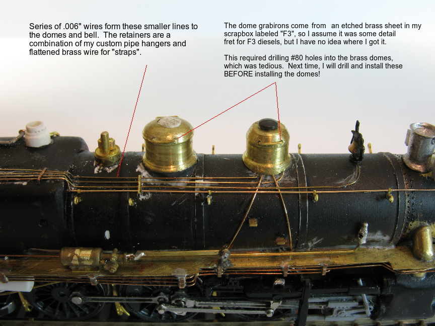

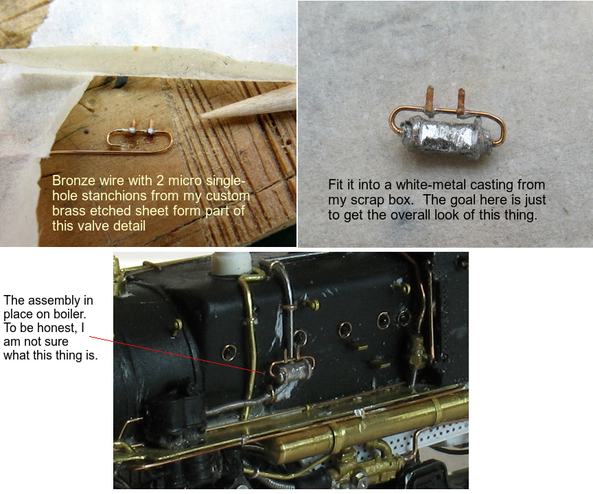

The linkage on the one side only might be a lubricator (just a guess) they had small levers going to them and would pump as the valves cycled.
  • Posts: 6500
Re: SP&S 4-6-2 #626 Project
« Reply #159 on: November 12, 2013, 12:34:10 PM »
Chris, thanks for the tip on the washout plugs and yes, this is a very good guess about that extra linkage thing being a lubricator.
I am trying to confirm it, but so far cannot.  My GN drawings show only the right side of the engine, so it wouldn't be on there.
EDIT:
More data:
I have found photos of the left side of PRR K4's that have a mechanical lubricator right up close to the
cylinder, mounted under the running board, with it's linkage connected to the crosshead.
The captions and text clearly state that it is a lubricator, and more than one reference explains that these
were added later, and were sometimes on the left and sometimes on the right, but only on one side.
Next, I noted two photos of SP&S 626 in my "Steam Locomotives of the Spokane, Portland & Seattle Railway",
Vol 6, by Ed Austin, showing the engine just after it was delivered to the SP&S from the GN and another
one about a year later.   As delivered, the left-side running board actually steps up a little higher just as it gets to
the left-side cylinders, and there is clearly a mechanical lubricator, similar to the device in the PRR K4 pictures,
in there.  The later SP&S photo has the running board straightened out, the lubricator is gone from the cylinder
area, and this mysterious "device" appears back by the eccentric link and radius rod connection (where I have it).
Chris, while I can't be 100% sure, I am sure enough that you are right.  It appears they moved it back, and they
poked a hole in the running board to make room to mount the lubricator without resorting to raising the running
board, and then put a sheet metal cover up and over the top of the lubricator to protect it from getting stepped on.
This does not appear on the other 6 4-6-2's that the SP&S had.   It almost looks like it was a
one-off home-made job they did on this one engine.
Thanks, Chris!  I would never have figured this out if you hadn't spoken up.
 (Once again, "We learn something new every day")

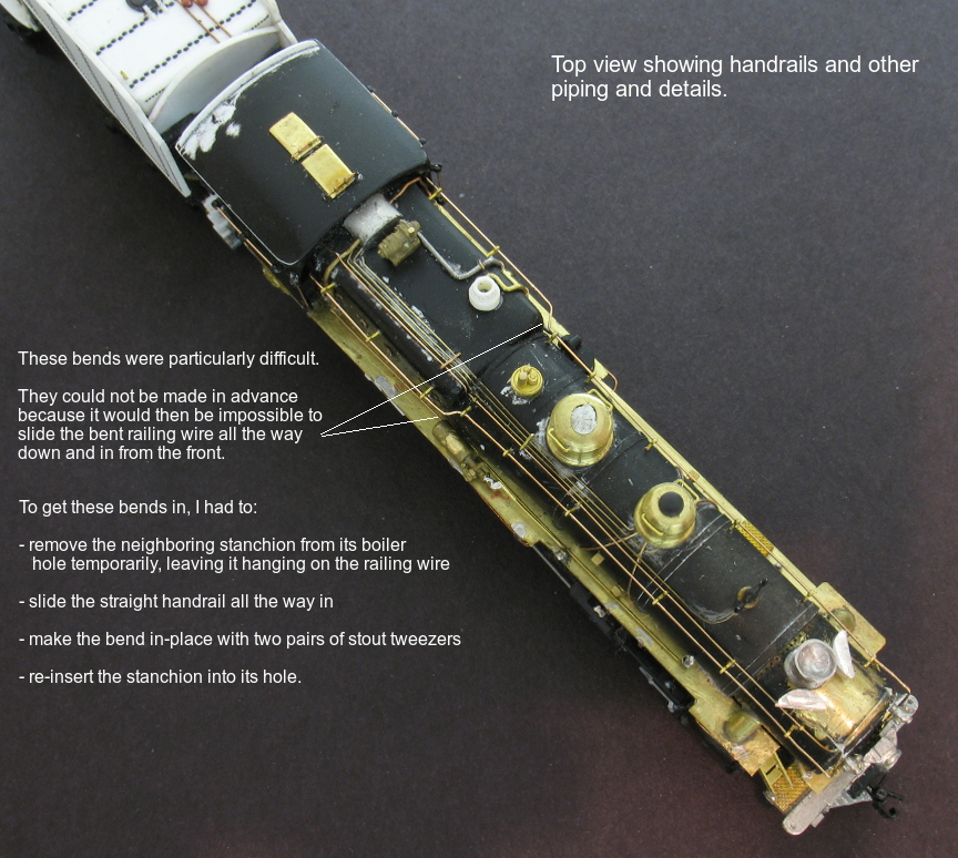

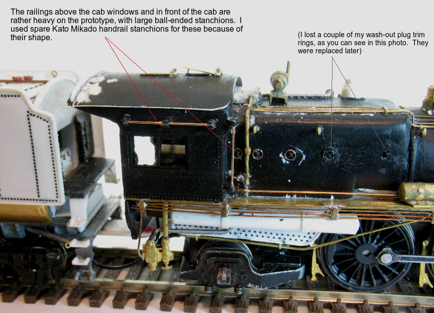

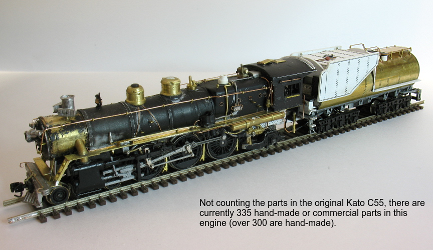

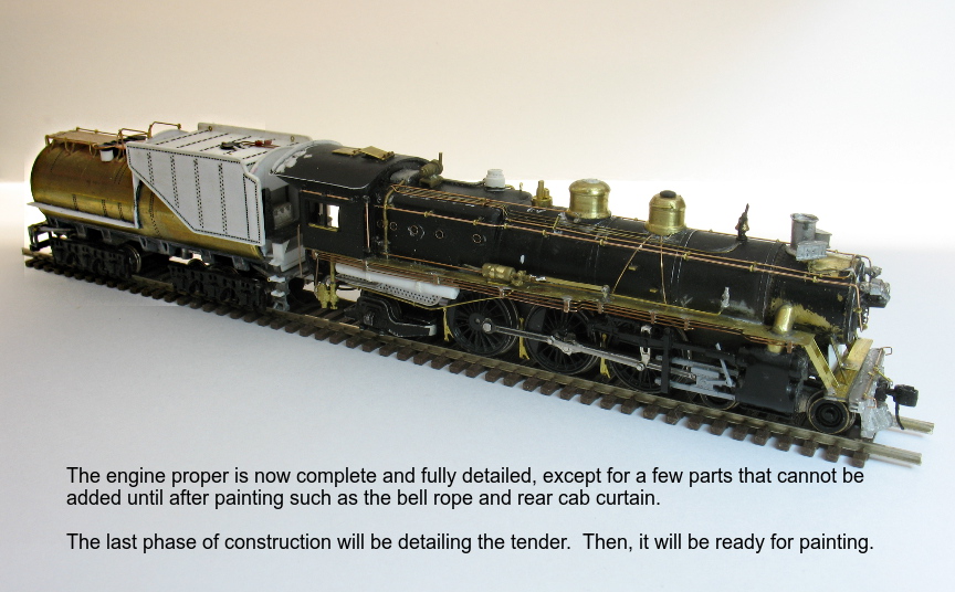

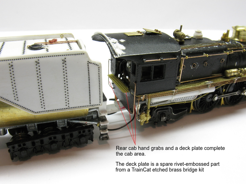

Today's update is the full detailing of the boiler.   Last time, I showed a spreadsheet listing all the detail parts that I needed to
apply to the engine and tender to complete the model.   I have completed the list for the engine only.  I will be working on the tender in the coming weeks.
So, here now, all the boiler detailing.   After this, the tender, then paint.
