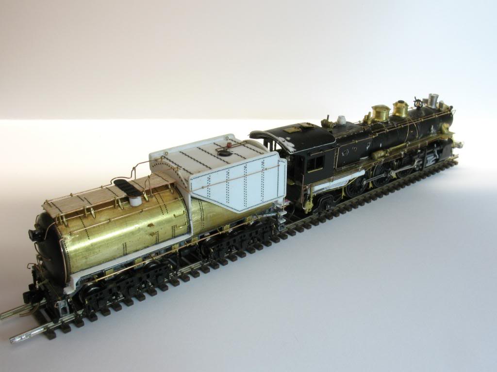

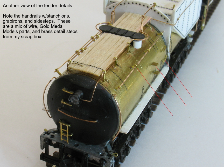

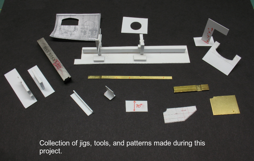

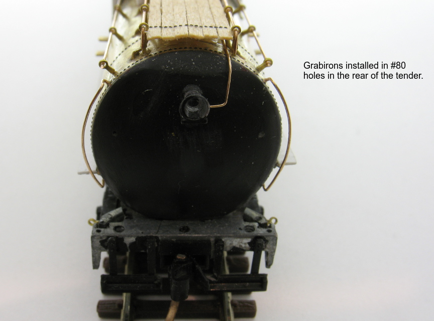

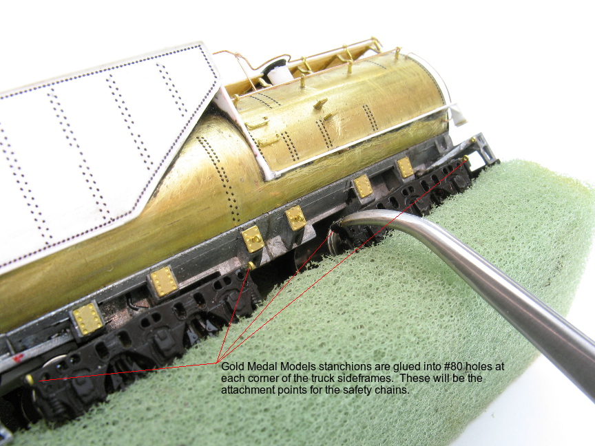

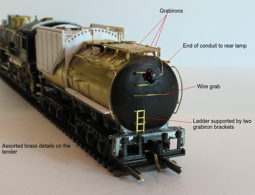

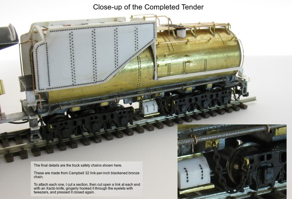

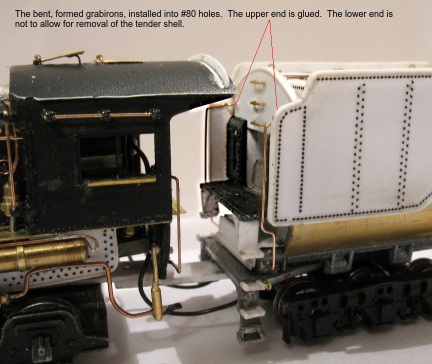

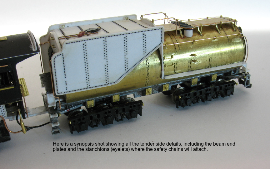

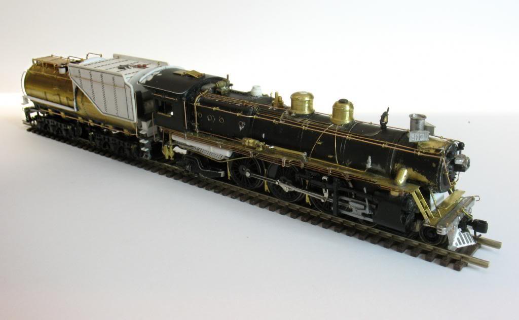

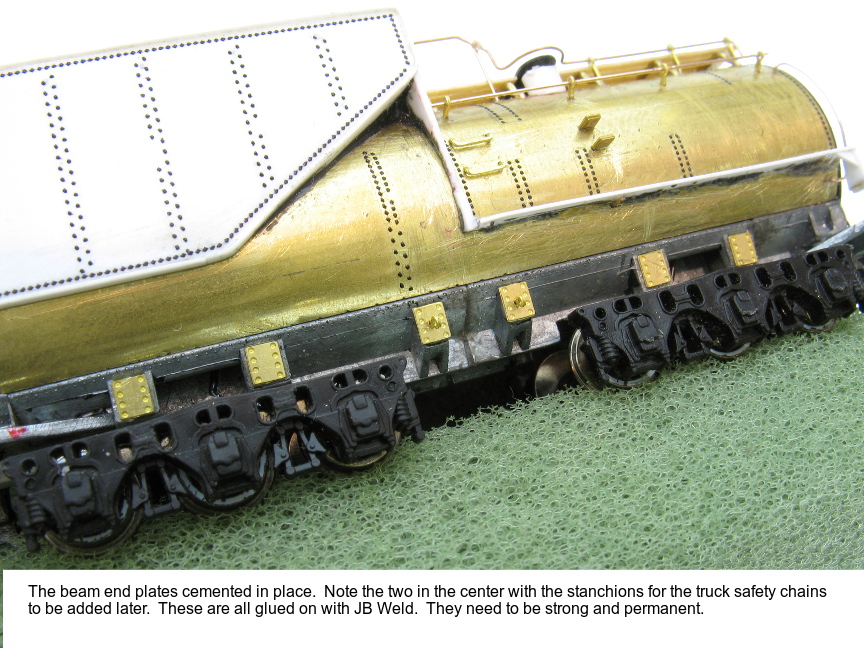

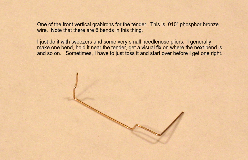

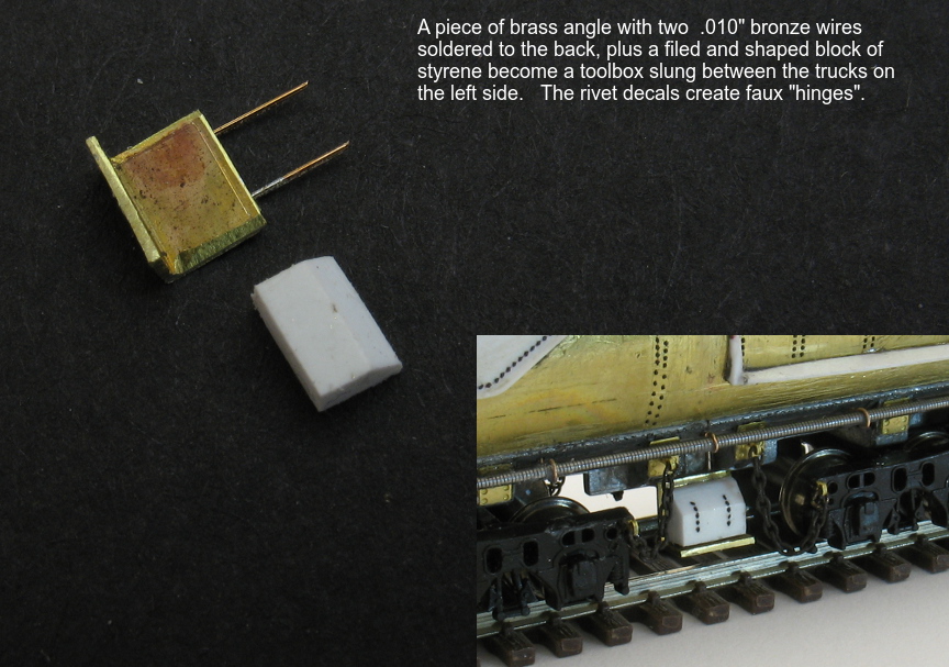

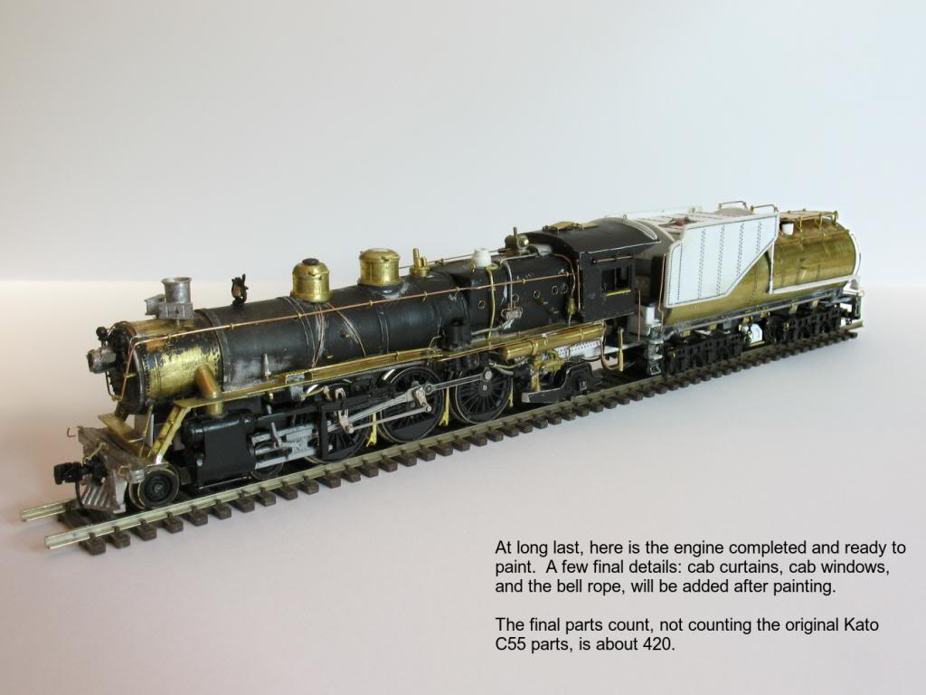

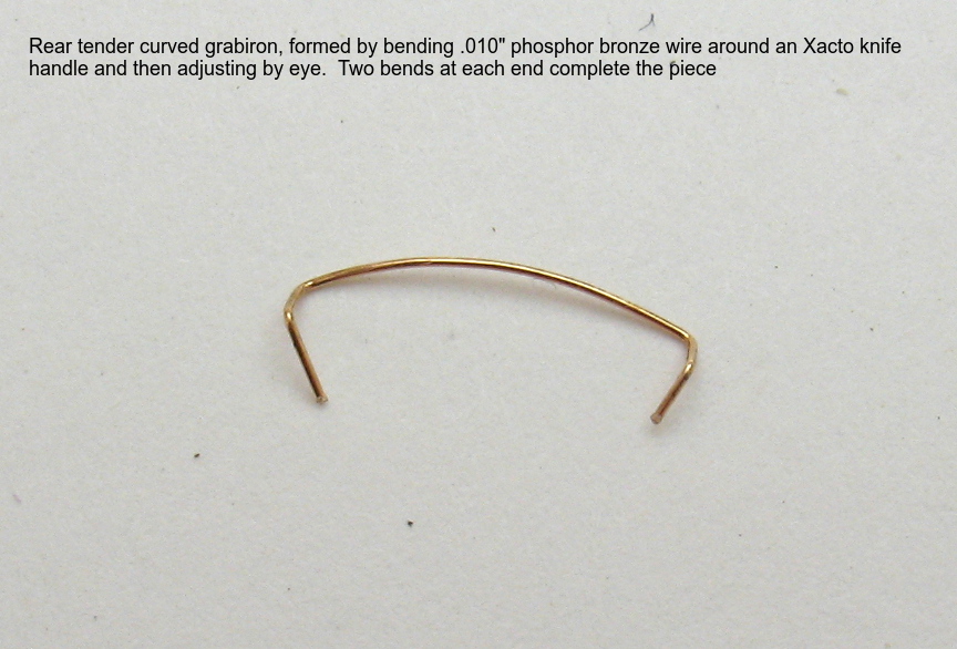

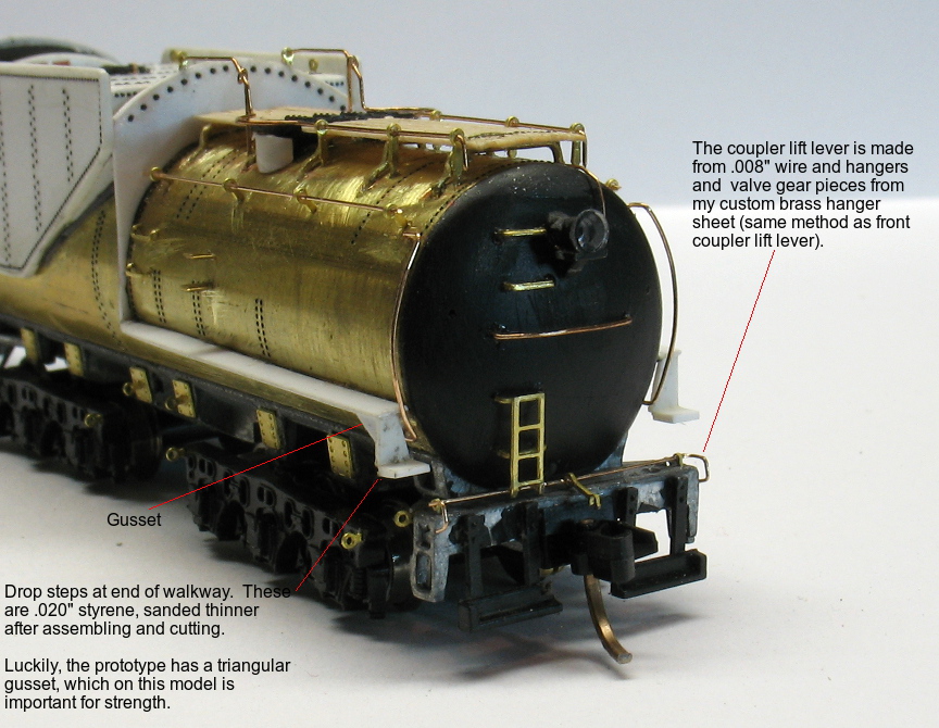

« Reply #174 on: December 04, 2013, 06:01:12 AM »
Chris and Tony, you really are such kind fellows.  THANK YOU for all your encouragement.
Well, this project began on May 28.   Here we are, 6 solid months have gone by, and I believe that in that time period,
there are probably only about 10 days when I did not work on this engine.  Some days, I made one tiny piece, and on others I pulled 4-6 hour marathons, but it has been nearly every day.
It is ready for paint and decals.  The photos that follow show the final assemblies and details.    Some of these are much larger format
than the 12" wide pics I've been posting, to show the beast more completely.
I hope these aren't too disorganized.  I made a big push to get to this milestone today, so I am completely wiped out
and am heading to bed the moment after I post this.
In a week or so, it will be painted.  While it will be nice to have it all smoothed out, and all of its "battle scars", scratches, joints, sanding and filing marks gone, it will no longer be possible to see quite how it was made.  I'm always a little sad about that.
