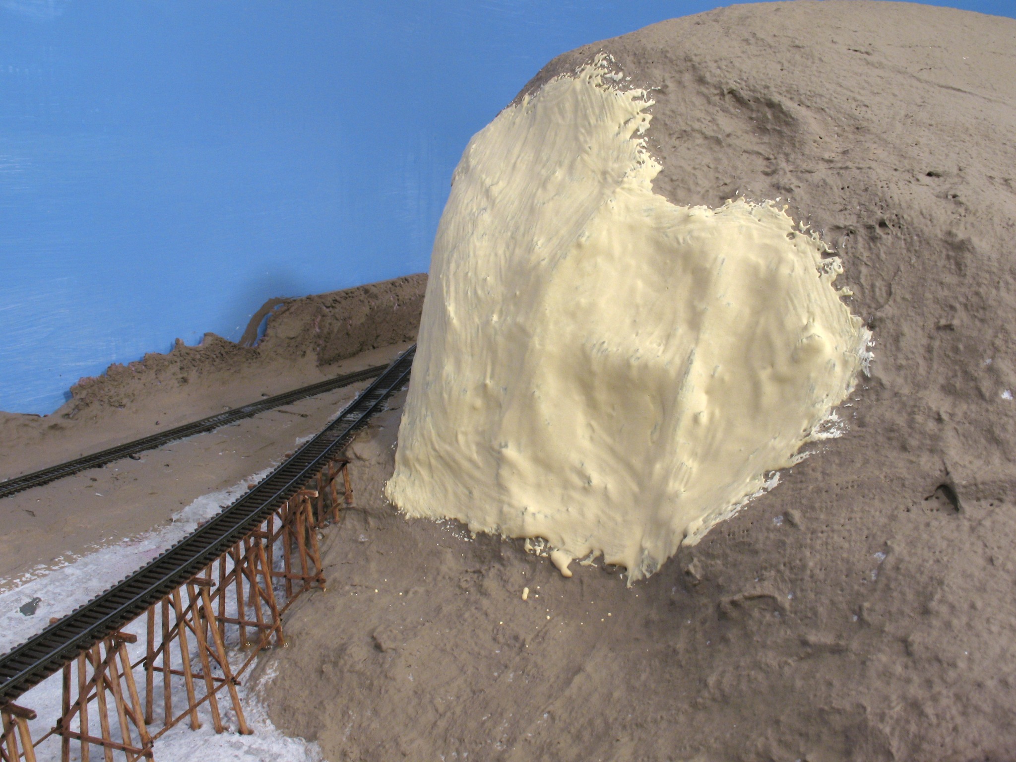

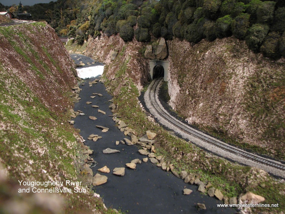

On my project, I put a heavy skim of perhaps 1/4" of Durham's Rock Hard Water Putty against the Celluclay to form
a vertical rock cut.  When the Water Putty got hard, I whacked away at it with a hammer and carving tools, and this
all worked fine (i.e. the celluclay didn't collapse or budge behind it).

That stuff is fast.  I think 30-60 minutes.  Somewhere in there.  And it really is rock hard.    Literally, I hit it with a hammer
to make some of the cracks in the rock that you see here.  It's great stuff.
Here's how it looked in my rock cut...
Here's how it looks when it's just brushed on, hard, but not carved or painted.
