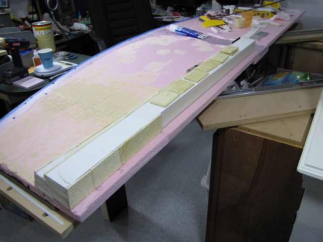

The stonelayers have been making great progress.  Finished the extension berm wall on both sides, test fit a tunnel portal, and started along the LIRR grade and between the LIRR grade and the PRR berm.  The PRR will be mighty on high!
By the way, the PRR used an 18" high x 24" wide berm wall cap, slightly overhanging the wall by 1".  I want to simulate this.   The balast will fill in right up to the cap.
Any ideas on what I could use?  The thought of casting another 70+ stone caps makes me ill.    :facepalm:  Scale styrene strips with scribed stones?  Uggh.  thoughts and ideas appreciated!

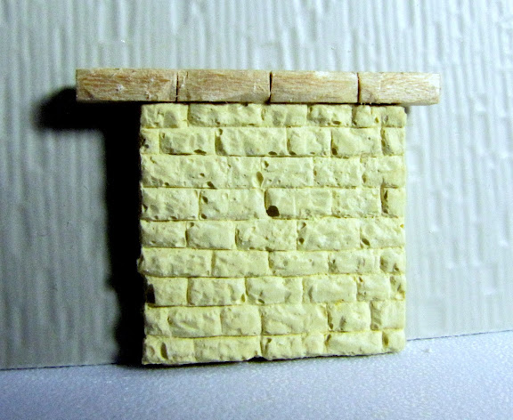

How's this basswood cap, reasonable?

M.C. Fujiwara
  • Posts: 1344
  • Respect: +84
    • Silicon Valley Free-moN
Re: Introducing the LIRR Industrial Service, Inc. shelf layout
« Reply #114 on: March 09, 2013, 09:47:38 AM »
Nice carving.
As to "reasonable" I dunno: got a photo of the prototype?

Filled the channel with 1/2" foam for a more shallow water pour.  Gonna get some thick dark olive drab for the Hudson silt.  Also experimenting with bridge height and seawalls.
I knew there was a reason I wanted those drawer slides!
Berm Wall Finished except for the stone cap.  Still deciding on a solution.
Track is not laid, just wanted to see what the LIRR I.S. grade looks like alongside the PRR main.

Nice carving.
MC best I could find is this from a Scenic Express website.  Page claims this to be a PRR proto design. $14.50 apiece.  No N scale version.  Glad I made the mold!  Sheesh. the berm would have cost me several hundred dollars as long as it is.  9 feet per side.
The cap stones in the image appear to be about twice as long as a given stone in the wall.  I made my carving at about 5 scle feet per stone.  Maybe 4 feet would be more proportional.  Going top try styrene too.
