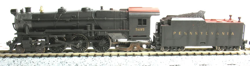

I went to the threads you recommended. Until I saw this photo I didn't realize how good the Trix shell could look
It might be the drivers, but my Trix K4s really doesn't capture the "K4sness".

The Trix K4 shell is a beauty.  The shortcoming, at least after you fix the tender pickups and put a good motor/gears in it,  is the drivers.  They have huge flanges, which requires them to be a little too small in diameter (after you grind
off the flanges) and requires them to be spaced a little too far apart.  The Kato c55 drivers are much nicer, as is the valve gear.
For a long time, there were no c55's to be had, so the Trix mechanism was the only choice.
In spite of the driver spacing, the Trix can make a decent K4.  This was the final one I did before I moved on to other things... the
inter-driver gears are gone and the flanges are turned down, which helps the look a lot.
These days, with c55's available, that certainly looks like the best way to go (unless you want to do it more economically, and you've got
some Trix engines in a drawer gathering dust!)
