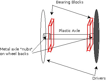

Jon,
The square bearing blocks that sit into the frame are right where the drivers press into axle centers. This is normal except on this model there is a big gap right there between the driver and axle. So as the drivers move side to side the bearing block gets caught on that gap. Once I replaced the whole set of drivers (thanks to Max) I then had to work on the pick-ups. I just swapped out the whole tender with a Bachmann long and also wired the motor right to the frame (no DCC here) After all that just to get it running I started to detail the body only to find the whole locomotive is 3/8" too long. To top it off I paid full Walther's price of $315. I gave up at that point, traded it for a Kato mikado and built my own 2-10-2:
https://picasaweb.google.com/ErieChris333/NScale#5276961413294646978

What Chris said is pretty much the story.
Here's a very crude drawing...
The center part of the axle is a plasic "tube".  The wheels each have a nub on the back that you can think of as
the little piece of the end of axle. You slide the axle through the bearings and push the wheels on the ends.
This isn't uncommon at all.
The problem is that the plastic axle and the nubs are not quite the same diameter.  The wheel nubs are a little bigger.
And worse, the bearings are bored for those metal nubs.
So.. there is a little "ledge" where the smaller-diameter plastic axle meets the nubs.  As the axle slides back and forth,
usually on curves, it can slide just enough so that the joint between the nub and the axle goes outside the edge of the bearing
block, so when the axle tries to slide back IN, the little ledge gets caught on the bearing block.  So you get click, skip, jump,
derail.
If the bearing blocks had been made just a little wider, so that the nub/axle joints would always be in the bearings and not slide out,
of if the plastic axle had been made the same diameter as the nubs, all would be fine.
Victor fixed his by replacing the bearing  blocks with the ones from a Kato Mike, which are a little wider.
I fixed mine by pulling all the drivers, spinning them in a drill, and running diamond files and
then super fine grit sandpaper (like 400) to gently taper the nubs down at their edges to the diameter of
the plastic axle.  This allows that joint to slide back and forth in and out of the bearings with out getting stuck.
If you gauge your wheelsets too narrow, then you won't have this problem, because the axle can't slide back and forth enough
to let the joint slip out of the bearing block.  This is most likely how Con-Cor made this mistake, because like so many commercial
models, they probably set the gauge a little narrow and never notice this problem.
Another way around it might be putting washers behind all the drivers so you don't get as much lateral play.
But you'll limit the curves this thing can negotiate if you do that.
I don't know... It might work fine if your curves aren't too sharp.  And this might be the easiest way to fix it of all.
