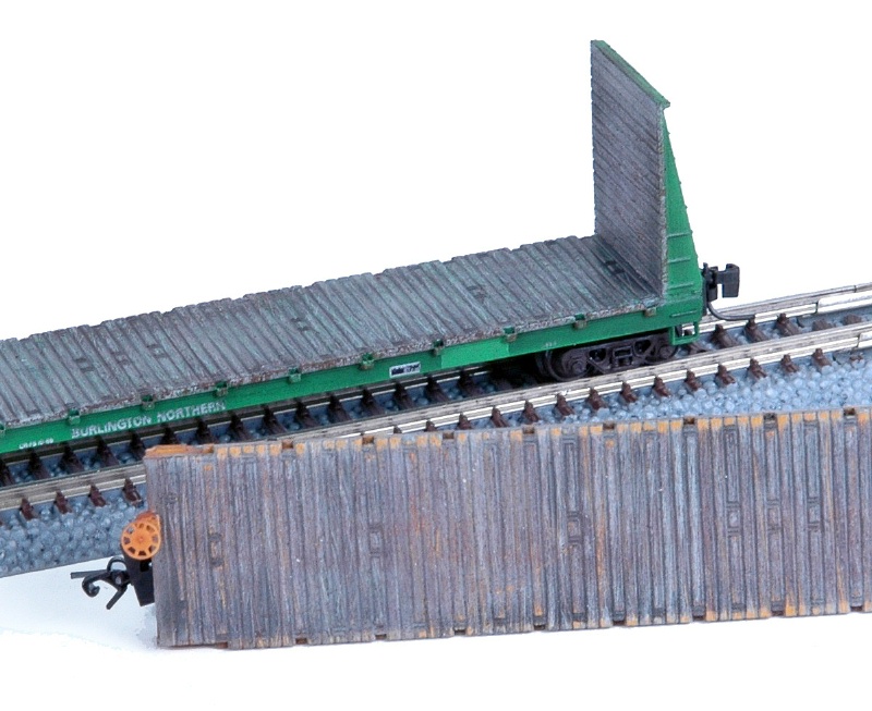

I'm not sold on the pre-scratching either.  Texture in the model doesn't help as much as sanding through layers of paint to bring in the look of grain.  Especially in the small scales, but I think it's the same for larger models as well.
For the really washed out stuff, like it appears you're going for, a nice coat of PollyScale Milwaukee Road Gray will get you to your current stopping point nice and quick.  Then sand through.
Here's Z:
PollyScale, sand, wash, sand, chalk.  Even in Z I used something nice and coarse like 80 or 100 grit.
