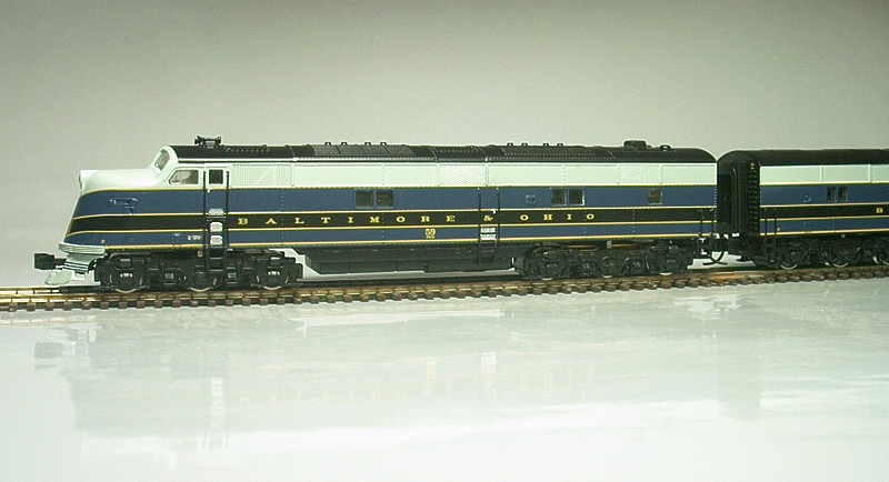

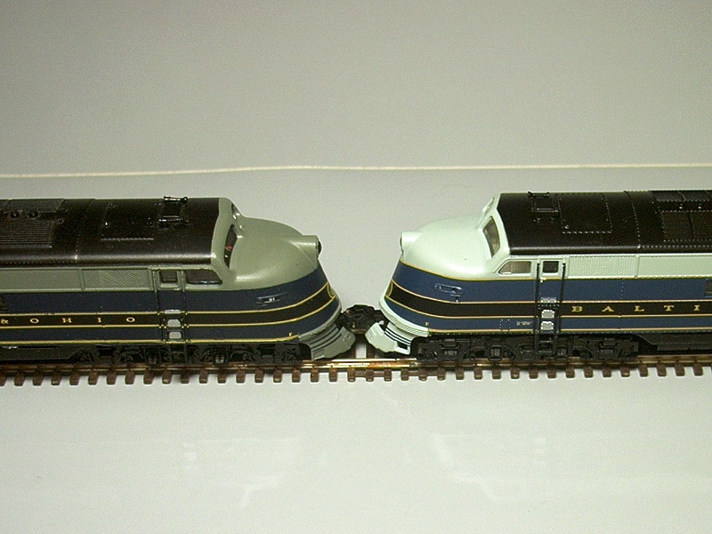

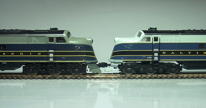

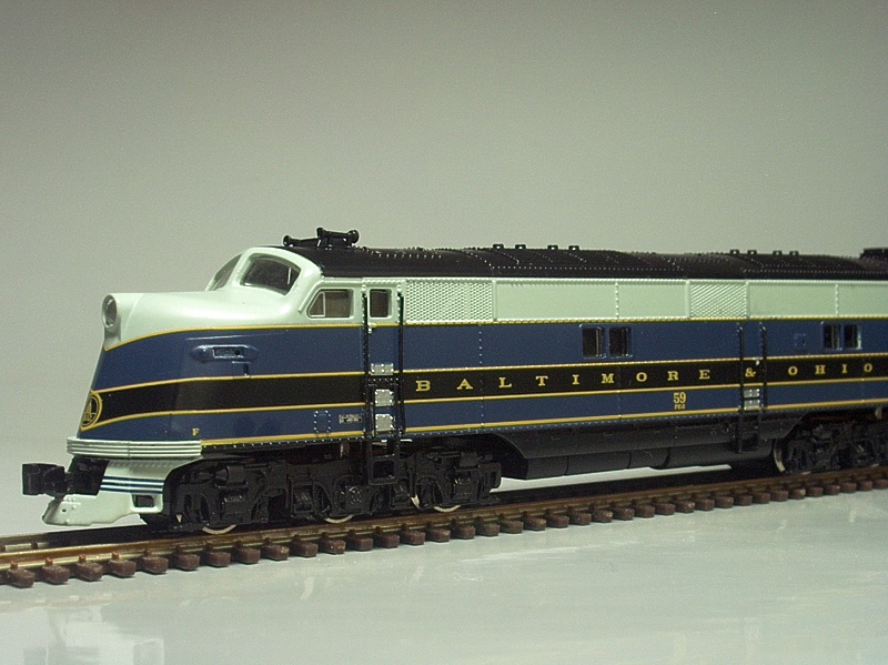

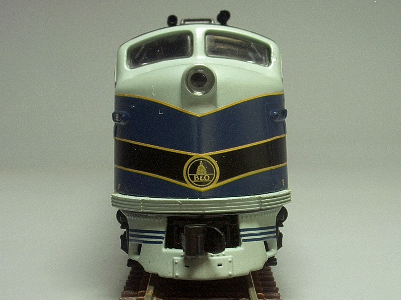

Pictures......
LifeLike on left - BLI right
The trucks have a different pickup system than I remember on me E8's with wipers behind the wheel and axle pickup (not needle point, axle rides in a hole in the pickup). It looks like it rides a little high on the trucks but I didn't notice it till I got out the camera. It runs like my previous BLI loco's, no complaints. Sound is strong and plenty loud enough. I did notice the roof of the loco warming up quite a bit.

Just curious, which gray is more correct...if any?  :?

The BLI is color looks spot-on, but it does ride quite a bit higher than the LL version, which looks strange to me. I also noticed from the images that the molding appears sub-par to their earlier releases - perhaps a different shell manufacturer? Except for sound, and going only on the images, it looks to me that the LL has better fidelity to the prototype E6. I'm sure one of my club-folk will pick up a set before the next show, so I can eye-ball the unit in person.  :)

Tony, it looks like you're missing a numberboard?

 Missing numberboard. I fired off an e-mail to BLI about the missing numberboard, high ride height (which by the way is not a problem on the B unit so it may just be a wire or something keeping the A unit shell from settling properly), and the parting lines in the nose. We will see what happens.

My very first thought was--- something doesn't look right.  It is too high.
If the B unit is not as high, then let's hope the problem is with just your unit.

If the E6 shell has the same internal profile as the E8/9, be looking for the DCC connector plus board at the rear being too high, pushing the shell up. This was an issue with my non-DCC E8's. In the end it was not possible to use a connector; I had to solder the decoder to the pin sockets.

Got a reply from BLI this morning.
They are more than willing to swap the unit but I'm not sure I feel safe doing that. When I mentioned the parting line on the nose, they couldn't see it in the photo and didn't know what a parting line is. If they don't have a clue how their own product is made, what chance is there that I get a better unit than I already have.
I guess they are used to half blind HO guys that can't see these types of errors.
BTW - The ride height is an issue with wires going over top of the enclosure. I removed the top of the enclosure (it just slip fits on) which allowed the wires the extra room they need and the shell snugs down nice on the trucks. It's still not as low looking as the LifeLike but the rooflines match now and it's not obviously high.
