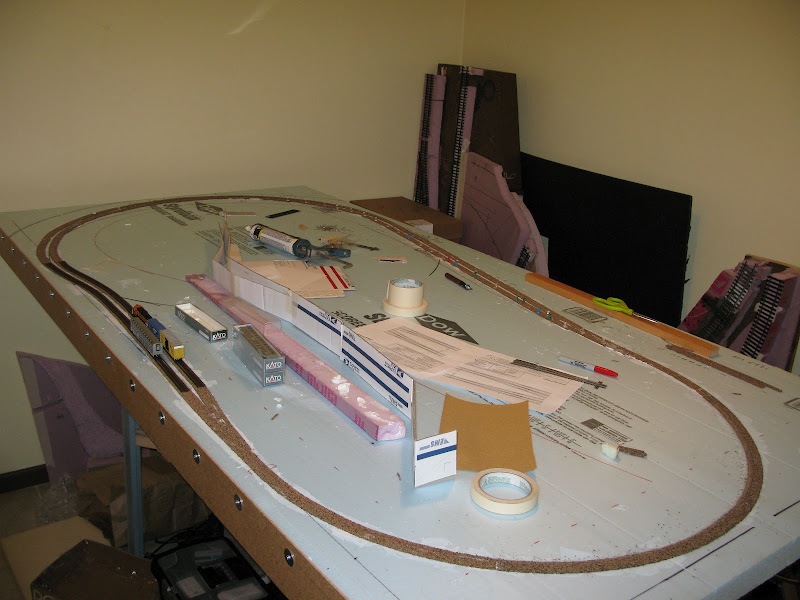

Some progress.
After answering the poll on how much time one spends actually modeling, I realized I needed to get myself into gear and stop dreaming. Even if it is just 3' of cork at a time.
Ok so here is the result, started on Sunday with 6' of cork. Center to center is around 1.25", cut out a credit card to fit over the cork to space things properly. My track center line was a little bit wavy because of my printers inaccuracy when printing out the track plan.
Used a spoked fabric tracing wheel to transfer the plan on to the foam, then went over that with a sharpie.
Once I build a couple more turnouts I will cut them in and slowly expand.
