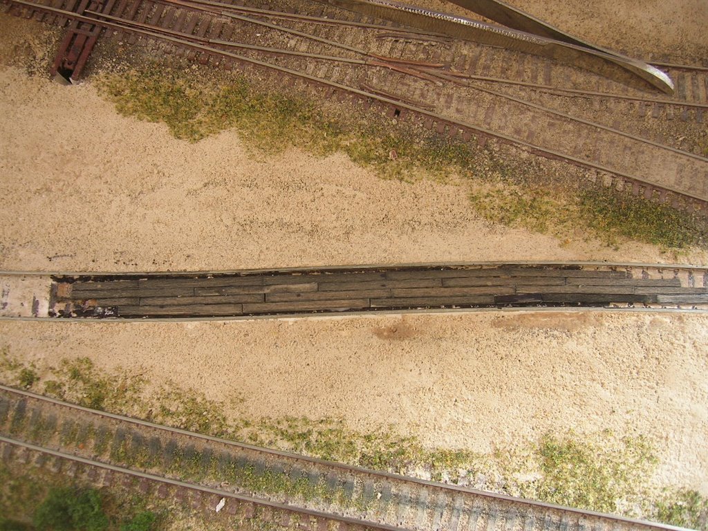

If you want wood crossings, you can simply scribe some wood and stain it.
depending on how sharp the curve is, you can do individual boards.  Mine's just a slight curve, but you get the idea.
Otherwise, yes you can plaster right over.. and cut out the flange ways afterwords.
