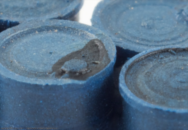

I painted the drums Conrail Blue faded with Aged White, since in my head I thought blue drums would look better and show off detail painting more:
I added a little Burnt Umber and Ivory black to represent aging and spills:

Those look really great, Tom! Thanks for posting these.
I wonder how it would look if you took a Sharpie to the straps on the new tie bundles, if it would look more like steel. Just a thought.

Incredible!  David, I hope you're able to make this product line blossom.

I think you need to find a way to pop out individual ties in different colors.  They are too uniform right now, especially the used piles.

I agree that some accent colors on individual ties would help enhance realism. But even without going to that trouble, I think they're reasonably acceptable.

Nice products, David! I'd say museum quality.
