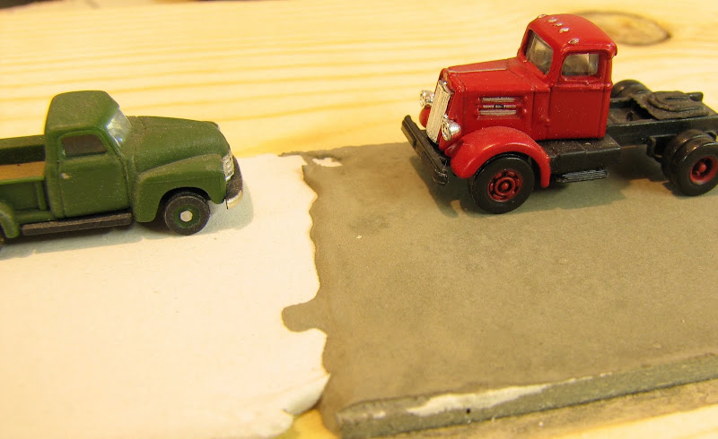

Well these pics suck. I just used 1/8" square wood for the forms. Close is spackle, middle is joint compound, far is cement.
None of them are colored yet. I think the joint compound has the best texture, but it shrank the most. The spackle is real soft, I can put a fingernail print into it even 2 days later. Plus it did shrink a little bit. I like the concrete, but it looks more like asphalt than concrete so it will still need painted. Any chips in the paint will be darker so I like that too.

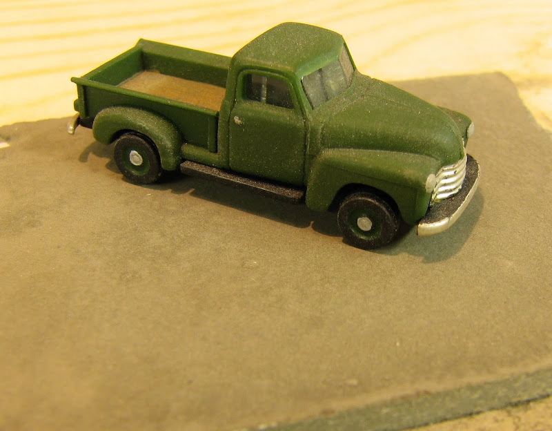

The texture can be varied by the mold. For these abutments I used styrene which produced the smooth texture of poured concrete in bridges around here but the end product was very glossy. It took 4 coats of Dulcoat to kill it and get rid of the shine, but I was very happy with the results. On some of the newer ones I cut screen mesh and put it into the mold to act like rebar and give the the casting some strength.
This is a nice idea in theory, except that in the real world, concrete is exposed to the elements. Acid rain, plant debris, rusting metal and all manner of other influences on its color are absent in the model world. Simulating these influences will require coloring the concrete artificially, so the reason for using concrete in the first place becomes moot.
In all my castings the color was not uniform, giving a nice variation of color. It is kinda uniform when it first comes out of the mold but as it dries it gets the realistic outside world colors. But for me, it was mostly the texture I was looking for, color was second.

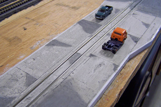

Hope this quickie in "paint" will show you what all I need to concrete:
It is a large area, but I can do it in sections. My track is .106-.108" tall so I bought .100x.060" styrene for my dams. In most places the dam will go right up to the ties.
The concrete sanded down and I painted it with watered down WS concrete "top coat":
You can see some of the scratches, but those could buff out.
The spackle and joint compound also sanded easy, but it's hard to get a nice pic of it all sanded. I really think I'll go with the concrete and give it a this wash like the above photo. I should go see if I can scribe it!

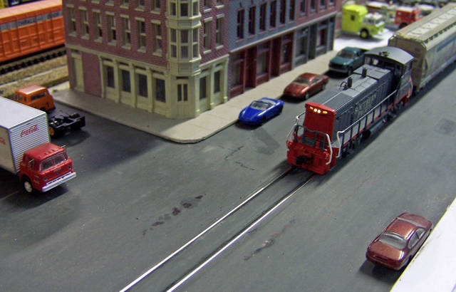

So how about this:
Just styrene painted with texture paint.
Re: Woodland Scenics "Smooth it"
« Reply #57 on: September 03, 2011, 09:04:51 AM »
You know, it's funny Chris, I was going to recommend styrene instead of spackle or concrete. I'd be nervous working with that stuff around that track and especially the switches. Styrene is clean and you have total control over where it goes, or not.
As for the texture people are looking for, if you reduce real concrete down 160 times, you end up with something about as smooth as flat paint on styrene. Unless it's crumbling and decayed, of course, but even then the texture will be more subtle than you might think.
Incidentally, Chris, it looks like you're shooting under tungsten light. Does your camera have a manual white balance setting? If so, set it to tungsten, and the color will look better...
