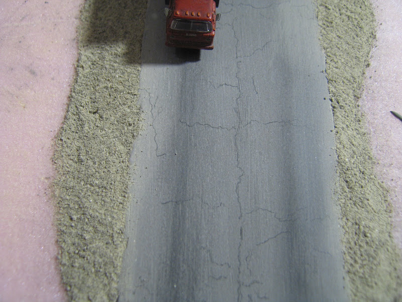

Re: Woodland Scenics "Smooth it"
« Reply #39 on: September 02, 2011, 11:10:25 AM »
Back when I was building the WR&N, I used a mix of Sculptamold and Hydrocal for road surfaces.
The texture is too coarse for Z Scale, so for the James River Branch I used spray-painted styrene.

« Reply #40 on: September 02, 2011, 11:19:27 AM »
wow, now THAT looks great.

The road Dave Vollmer did on his Enola extension is another example of a great road done using painted styrene.
