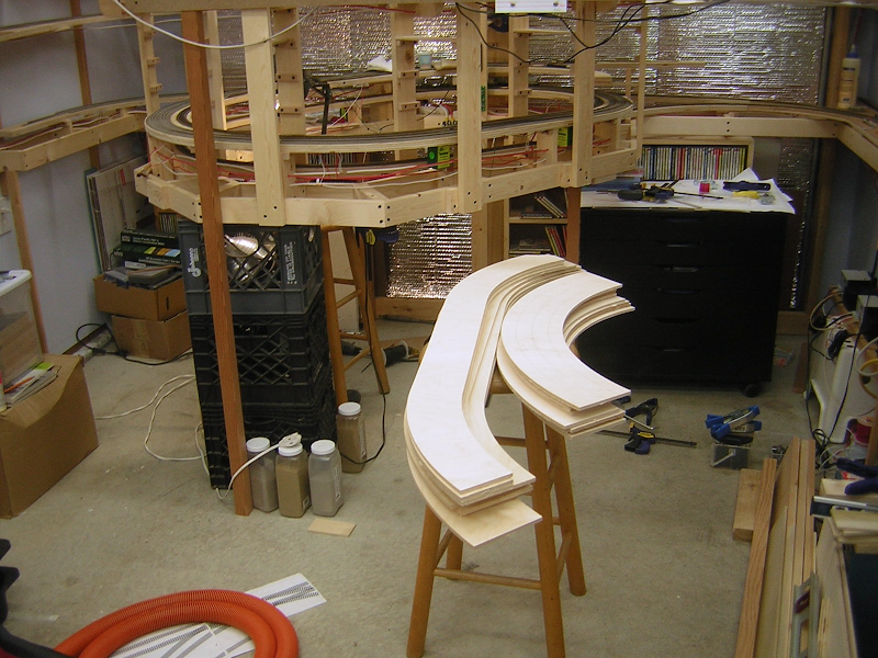

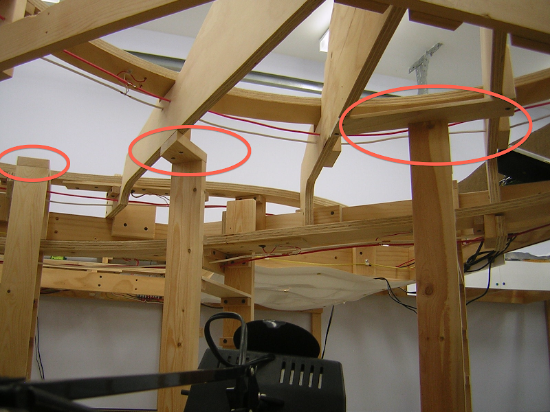

Up to this point the roadbed could be supported with simple risers, but the remaining loops would require more conventional helix supports.  I settled on a design that employed pairs of 1x3 risers with 1x1 cleats for supporting cross-members (see above).  One of the challenges was figuring out how to secure the tops of the 1x3's to the pre-existing Loop benchwork above.  Each one required a different solution; here are some examples:
One of the best decisions I made in this build was to have the remaining loops of roadbed cut from 1/4" Baltic birch plywood on a CNC router.  I was able to make a simple line drawing in xtrakcad, export it to pdf, email it to a local maker shop, and pick up the parts a few days later:
And they all fit perfectly!  The next few loops went pretty swiftly, though there was plenty of crawling into and out of the helix, and crouching while inside of it - quite taxing on an aging body!  Here is a shot midway up the climb:

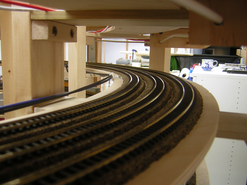

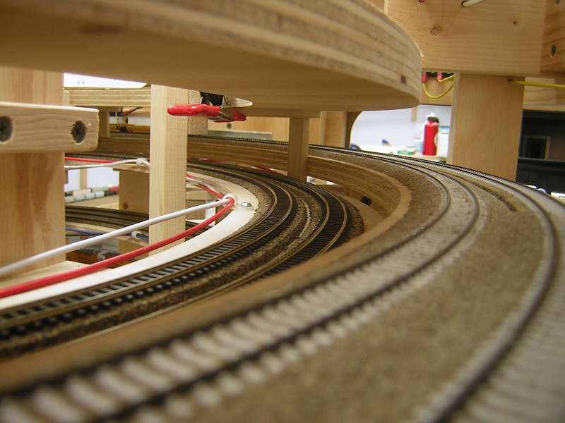

This shows the construction with the Baltic birch roadbed: the rise is 3 1/4" per turn (2.0%) and the finger clearance is 3" which is enough to rectify derailments.   The lower 3 turns are triple track:
The two inner tracks can stage 2 long northbound (originating) trains each while the outer track holds southbound (terminating) trains.  The two upper loops are double track to clear the pre-existing mainline loop that connects the lower deck mainline (still to be constructed) with the upper deck, the ballasted track in this shot:
The double track portion of the helix can stage two more northbound trains for a total of 6.
