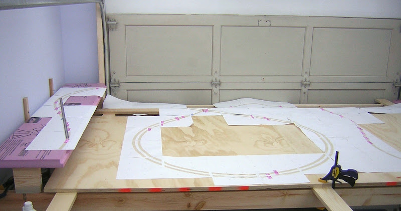

With room preps complete, save for a few minor cosmetic items, I can finally make some progress on the mock-ups I've been hankering for.  Without further ado, here is a long view of the Loop shelf that will form the signature scene of the layout (pardon the mess!):
A few notes:
* This shelf is about 58" high at its lowest point on the right and it will rise to ~65" on the left (where the narrow raised sections is situated).
* It is about 5+ feet deep and 10 feet wide, so it takes up a big chunk of room real estate, but I want to have room for the tracks to spread out.
* There will be nod-under access in at least two spots in the shelf, so that no track will be more than a ~2 foot reach.
* I have framework in place to put an (insulated) back-drop behind the shelf, in front of the garage door, so that eyesore will be hidden.
Here are two railfan views of the track arrangement as it currently stands, with some auto racks for scale:
For reference, here is a proto shot that somewhat mimics the former:
http://www.railpictures.net/viewphoto.php?id=222919&nseq=209
and an ariel shot of the entire Loop, just because it's so cool:
http://www.railpictures.net/viewphoto.php?id=309616&nseq=7
An overall assessment so far, the pros:
* I love the expanse of this shelf and the rail-fanning opportunities it entails!
* I'm especially glad to have the lower approach loop (far right) included in this shelf since it adds so much to the torture of the climb.
The potential cons:
* It takes up a big chunk of real estate and overshadows the lower deck shelves.
* Access details are still TBD.
* I need to make sure that a 35-40 car train can actually navigate this track.  But with 18" minimum radius and 2.1-2.2% grades, it should be manageable....
Stay tuned.
-gfh
