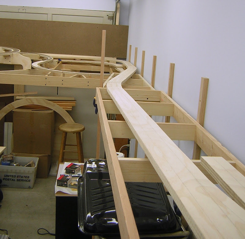

Here is a bit more progress from the weekend (though it's still a big mess in there as you can see, so these shots are pretty raw).  First is an overall shot of the Sausage Factory taken from the access area in the Loop shelf looking towards the doorway, showing the work done on the upper deck benchwork.  All that remains is 1 of the 2 boxes needed for the Tunnel 14-17 shelf on the right, and a rig for the doorway crossing:
You can see the Loop roadbed in the lower right corner. The lower deck will be a few inches above the height of the cardboard boxes my laptop is resting on in the distance - it seems like the lower deck will not be too claustrophobic.
Here are a pair of shots of the Tunnel 14-17 shelf-to-be from each direction:
There will be a series of four short tunnels in rapid sequence along this stretch, all with very unique and decrepit portals that will be fun to model.  This is one of my favorite scenes in this plan.
Finally, two more quickies of the benchwork: a shot of the Mojave shelf descending to staging via the right rear portion of the Loop shelf:
and an overview of the Loop with cork:
