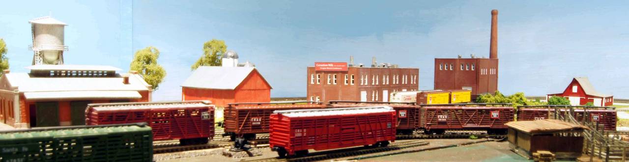

So, inspired by what I see you guys doing, I spent an evening or 2 this week lowering some 4 stock cars, and repainting and decaling them for CBQ. (FYI, there was a Bachmann CNW, a "Hong Kong" UP, and 2 Industrial CNW & ATSF models, which I picked up at train shows for $3 or $4 each.)  I have not attempted to body-mount the couplers  -- these are Atlas trucks with truck-mounted Accumates -- but I did lower them by filing the bolsters and milling enough of the floors to allow low-profile FVM metal wheelsets to roll freely.
These "works of art" were a learning experience for me.  Not a single one of the stock cars in the photo is prototypically accurate for CBQ  -- for one thing the trusswork is all wrong. For another, the doors are all wrong, and for a third thing the ends are wrong.  So, while I painted them red and put on the Burlington Route heralds, and the road and car number panels, I couldn't justify adding lading info and car data on the end panels.
But, they are lower than they were, and they still roll.  See if you can't pick them out in this photo!!
In the past I have thought about building some replacement stock car sides that I could mold and reproduce to use in place of these.  That is not so high on my priority list, so red stock cars with CBQ heralds are gonna have to do...for now and some while longer, I think!
Regards,
Paul
