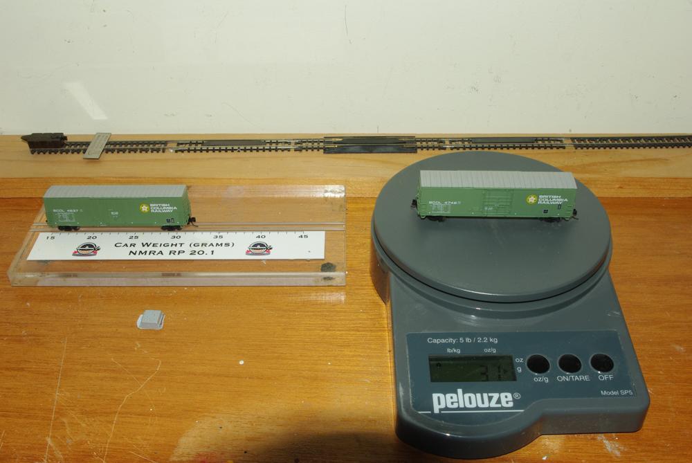

On the subject of car weight, some time ago I got tired of calculating the NMRA recommended weight for each car individually.  As a result, I inverted the weight/inch of length after the initial weight so that I had length/weight increment - in my case, mm/gram but it could just as easily be inches per ounce.  I then drew up a scale with the initial weight (15 grams) at one end and each 1 gram increment marked and the scale was glued to a perspex "surface plate" from Andy W. Models in Vancouver, BC.
Determining recommended car weight is now as simple as placing the car on the surface plate with one end lined up with the 15 gram mark and reading off the desired weight at the other end of the car.

Greg - Your solution is simple and effective.  My two favorite attributes for hobby matters.  Come to think of it, for most any other matters as well.  Well done and thanks for sharing.
I've not commented on weight much since the early posts.  Experience running on other's layouts has shown that following the NMRA guidelines to the letter is not necessary for good performance.  They're guidelines after all.  Being consistent within a narrow tolerance for a given car length IS important however and the NMRA guide is a good baseline from which to begin.
I've settled on 27g +/- 1g for 40' cars.  A recent MT 40' XM comes in at 20g.  The Atlas 1932 XM is 27g.  An Atlas 40' single sheathed or steel rebuild XM weighs in at 30g.  Open one up and you'll see why - photo below.  I'm gaining a new appreciation for Atlas rolling stock as I'll discuss in a later post.  I'm not removing weight from the 30g Atlas cars.
50' cars are weighted to 31g +/- 1g.  Box cars are easy.  The BLMA GB was tough.  I was able to get to 28g total.  After modifying the coupler pocket it runs fine.

Steve,
Your numbers and my "car weight ruler" are in good agreement.  A 40' car on the ruler shows 28 g while a 50' shows 31 g.  The GHQ 40' 8-hatch Canadian reefer weighs in at 28 g with Fox Valley wheels and a True-Line Trains 50' newsprint box car is right on the button at 31 g.  And yes, out of the box the BLMA GB weighs in at 18 g compared to a "recommended" weight of 32 g - it is slightly longer than a 50' box car.
